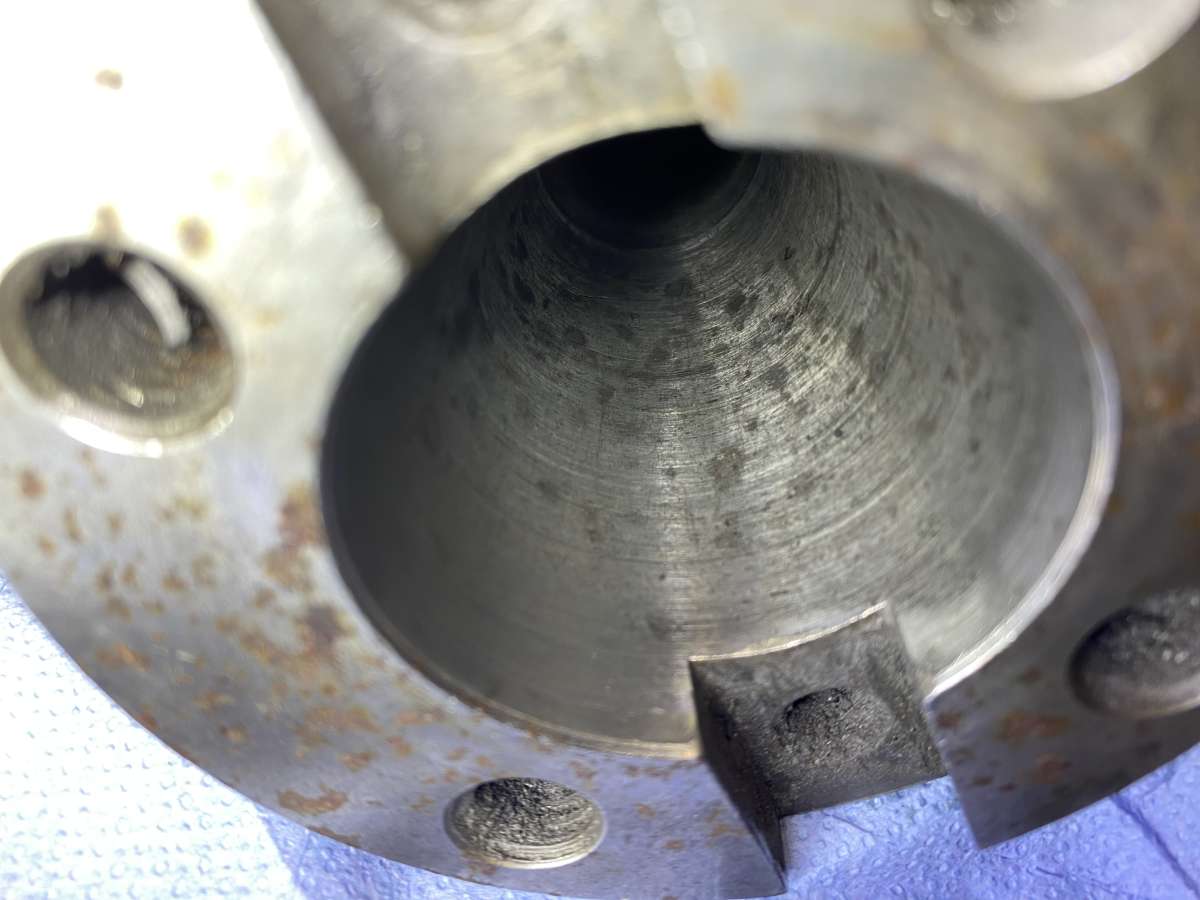

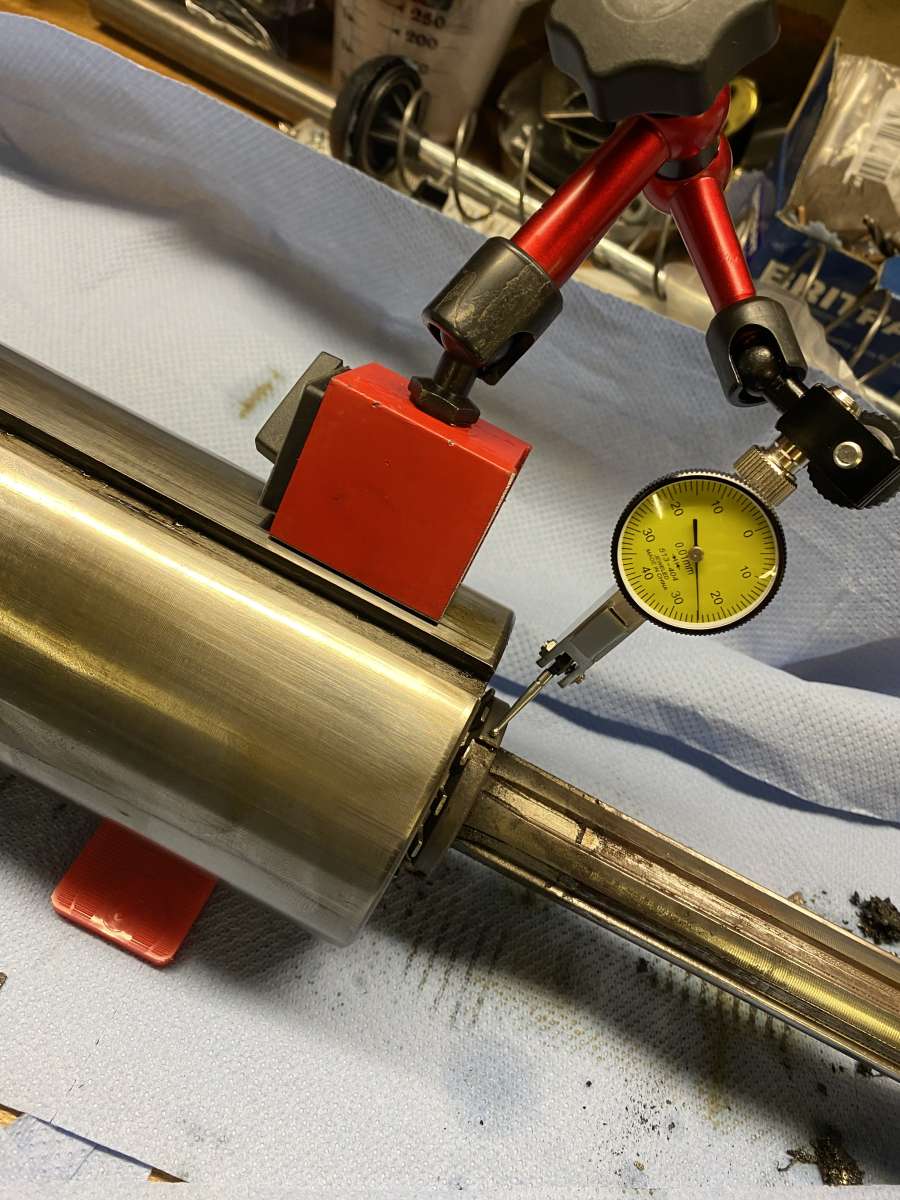

                Hi All,

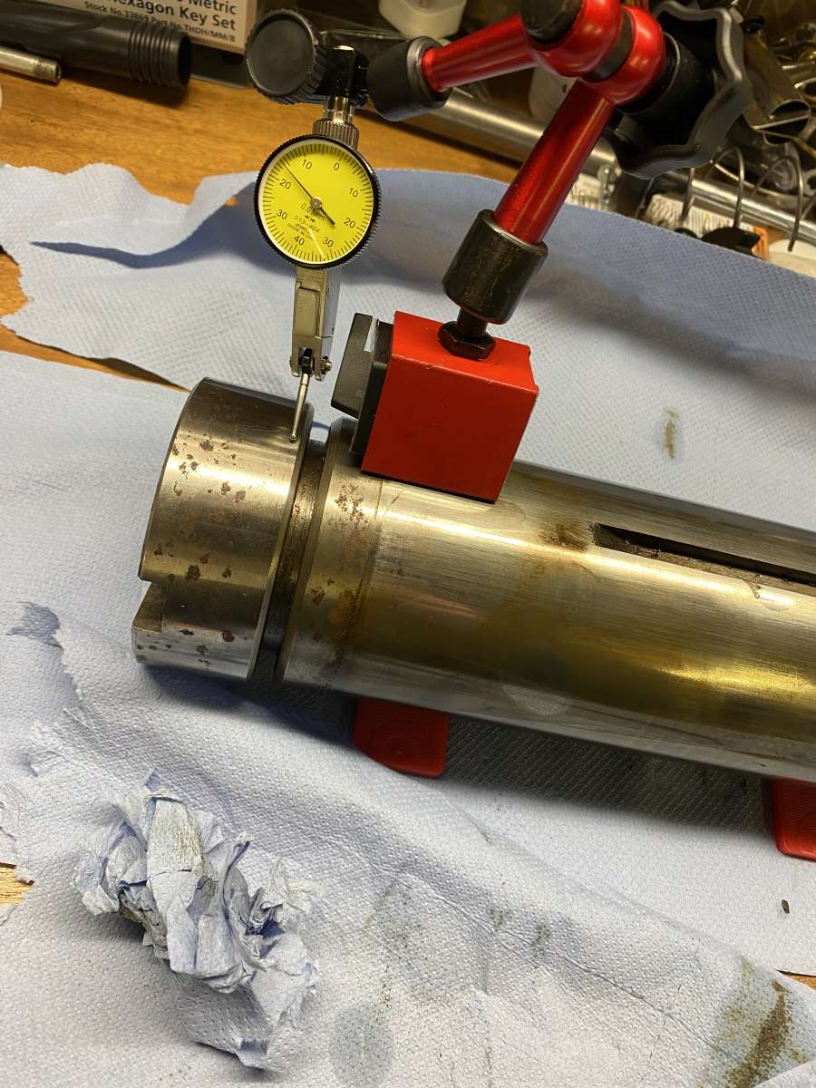

                So, means of an update… with the spindle out I am still trying to find out my issue of the 0.9mm run out. While the spindle is on its side, I measured while rotating it on the outside face (photo AA tool end) and now only get 0.2mm run out. Then I measured at the same point NOT rotating it but trying to move the spine up and down and got no movement at all. Then I moved to the back of the spindle (photo BB nut end with locking washer) and done the same, about 0.3mm run out why rotating it and 0.2mm then moving it up and down. Lastly, I placed the indicator inside the INT40 cone and measured a run out of 0.5mm. Also rotating the spine, the bearings don’t sound the best, and you can see in photo CC the internal face of the INT40 cone is not looking its best.
                With my past submitted details on my issue and now the above would people believe my best course of action is:
                –          Remove the spindle from the spine to inspect the bearings and possibly replace them.
                –          Also, clean and, if anyone knows if you can do this hone /polish the inside of the INT40 cone to hopefully remove any imperfections.
                Fingers cross with the above I can have a workable Mill.

                #678049
                  Not sure setting the DTI up like that helps much.  It assumes the outside of the spindle and the outside of the INT40 are round and concentric, which they may not be.   Run out only matters if it’s between the inside of the spindle and the inside of the INT40.
                  Replacing the bearings should be safe enough, and they are a likely cause.   I wouldn’t mess with the INT40 unless dead certain it was out of shape. I can’t see any imperfections bad enough to cause 0.3mm run-out.
                  As that’s huge, the cause must be something fairly gross – like badly worn bearings or a bent spindle.  Shine a torch on the far side of a straight edge laid lengthwise along the spindle and rotate it.  Light escaping under the edge should reveal if it’s bent.
                  Trouble with pre-loved gear is the history is unknown.  Possibly someone smacked a tool good and hard into something solid, destroying the tool and distorting the taper, spindle, and/or bearings.    In theory, heat and a hammer will fix a bent spindle.  In practice, I’ve never had to try.   Anyone else?
                  #678343
                  Diogenes
                    @diogenes
                    Now it’s out, it’d be best if you can snug the quill over some vee blocks on the mill table – this will give you a stable platform to work off and both hands free to manipulate things.
                    I think if you can establish the axial play (‘end float’) first and then the radial play, you will gain a better insight into where and how much things are moving which will then enable you to check concentricity with a more informed view of how the spindle can be / must not be handled to gain repeatable results that you can have confidence in.
                    As far as I can see from the pictures, the spindle assembly looks in ‘better than average’ condition for a machine of this size and age.

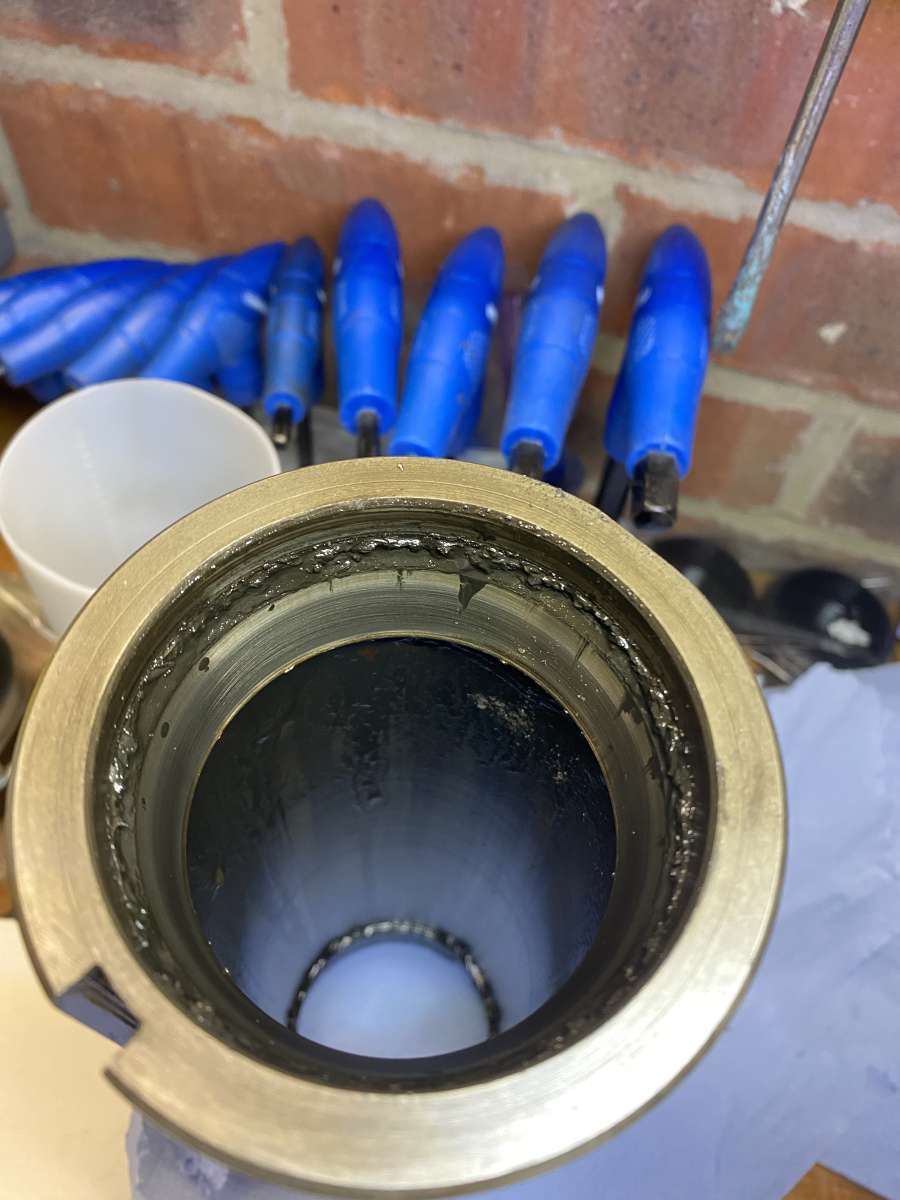

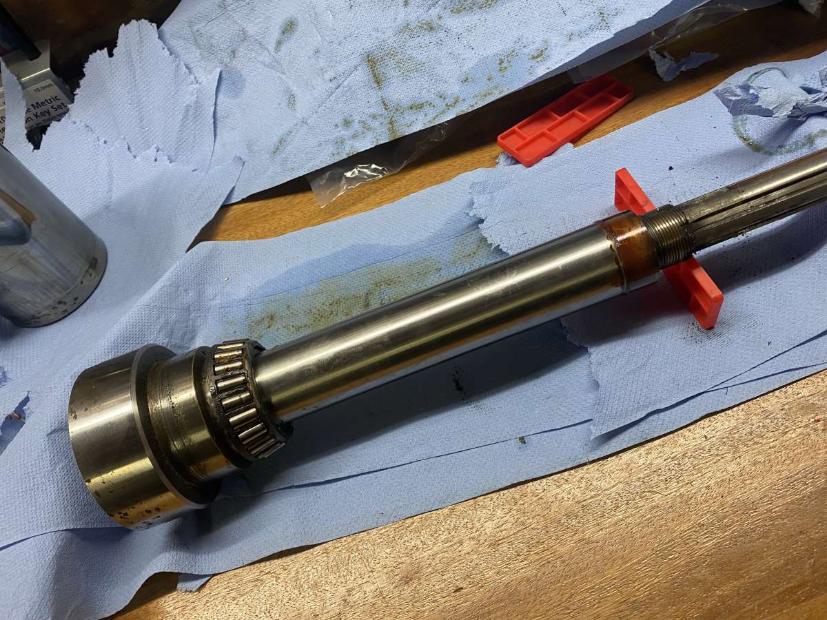

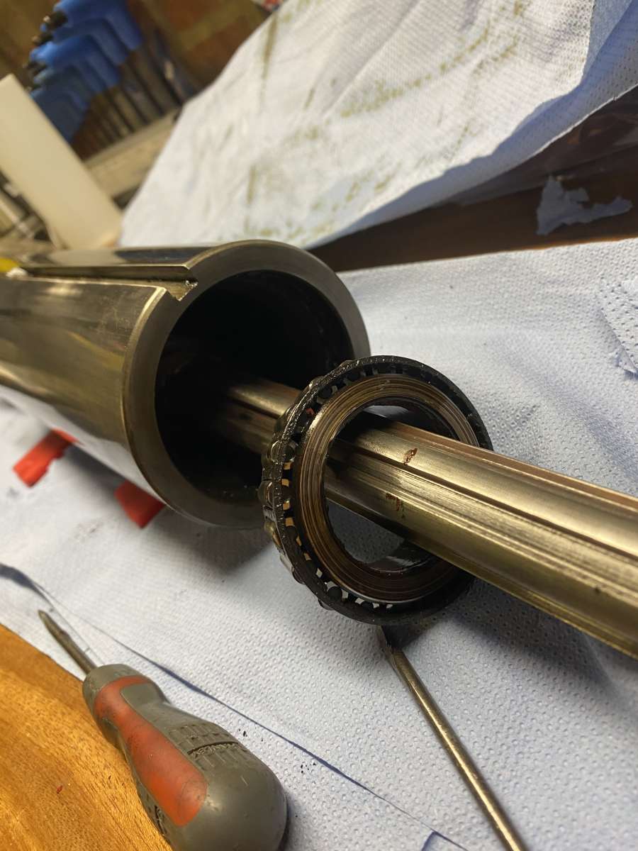

                            Afternoon All,
                            Following my past issues with my spindle I found the courage to breakdown the quill from the spindle to inspect the bearings and was very surprised to see it had only two bearings. The Manuals notes there should be three. Has anyone seen this type of spindle before with only two bearings? The marks on both bearings are (32008c SNR France).
                            IMG_5460IMG_5461IMG_5474
                            #684639
                            DC31k
                              @dc31k

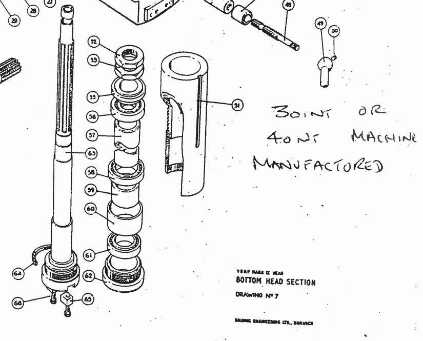

                              Is the exploded diagram in the manual you have specifically for the 40 taper spindle?
                              It is true that the 30 taper spindle has three bearings, but the design may have changed for the 40 taper option.
                              What manuals exist for the Beaver are not comprehensive in the sense that not every option Balding offered made it onto paper.
                              SNR is now part of NTN, but the bearing designation is a standard taper roller one. If replacing, it would be wise to talk to a bearing specialist to find out what precision level or class they would recommend for a spindle application.

                                Thanks, below is the diagram that I have (if anyone has a diagram for the 40 taper that would be great).
                                Could anyone recommend a bearing specialist they have used in the past? Being that the 30 taper uses Hoffmann bearings, would like to see if I can get Hoffmann bearings for my spindle, as I believe from reading, Hoffmann and German precision bearings ???? Plus not sure if the bearings in the spindle now are the original ones anyway.

                                #685634
                                Mark Rand
                                  @markrand96270
                                  My Mk1 VBRP had obviously had one or more serious crashes in past lives and the spindle was, indeed, bent. More at the top than the bottom. Supporting it on V blocks, U mapped the bend using a DTI, then moved the supports to appropriate locations and straightened it with a block of brass and a soft hammer. No great difficulty.
                                  Afternoon All,
                                  The 40 NMTB spindle arrangement was significantly different from the 30 NMTB one. This was necessary because the quill diameter wasn’t changed and that was sized for the 30 taper spindles. Hence the taper roller bearings, which take less space than angular contact ball bearings.
                                  It’s not easy to tell from your photo, might just be grease on the outer race and rollers. After cleaning, if they aren’t all shiny and spotless, with no flats or grooves, then it’s new bearing time.

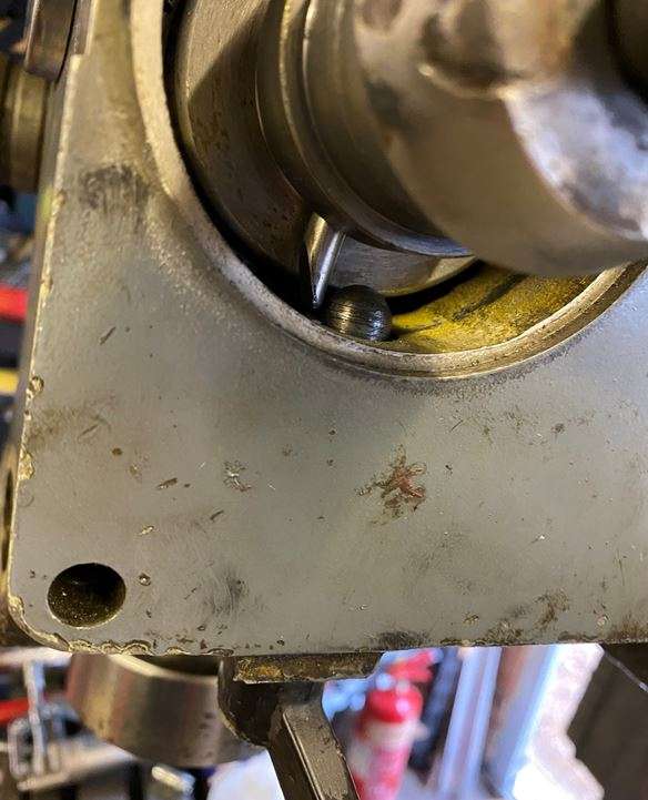

                                    Hi All,
                                    Can anyone help me to understand why I can’t pull down the locking pin enough to enable the spindle (turning the handle) to come done? It moves down halfway but no further.2024-02-02 19_07_56-Window

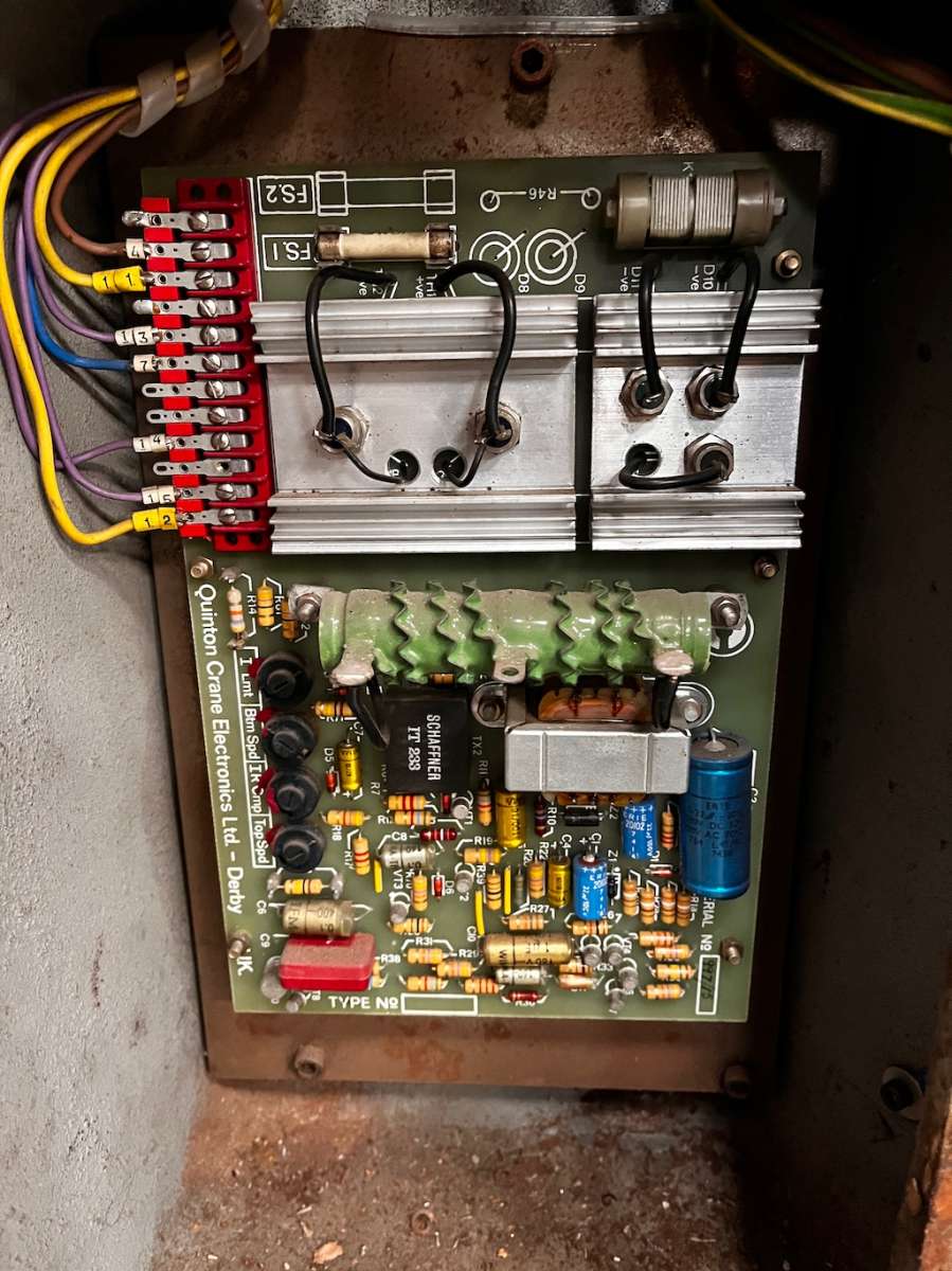

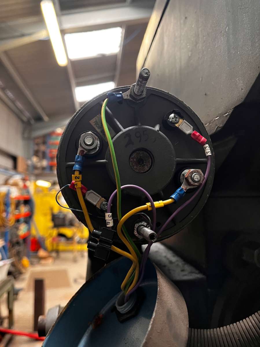

                                      Morning All,
                                      I’m trying to get the speed controls working for a Beavermill 5.
                                      The head motor runs fine as well as its hydraulic and pneumatic elements of speed control and mechanically the machine is largely sound.
                                      The X, Y and Z axis on this particular model have electronic control, via a small pair of rotary selectors the the left of the head, along with start button, speed control pot, tuning pot, indicator light, and quick traverse function. The top selector selects between “rev”, “off” and “for” and the bottom selector select “X”, “Y” or “Z” axis.
                                      Control is via a Quinton Crane Electronics Derby speed control board, in the lower LH cabinet on the main machine.
                                      The photo’s show one of the axis motors and the speed control board.
                                      Anyone else with this setup? Any schematics or diagrams for this setup available? Thanks Rory

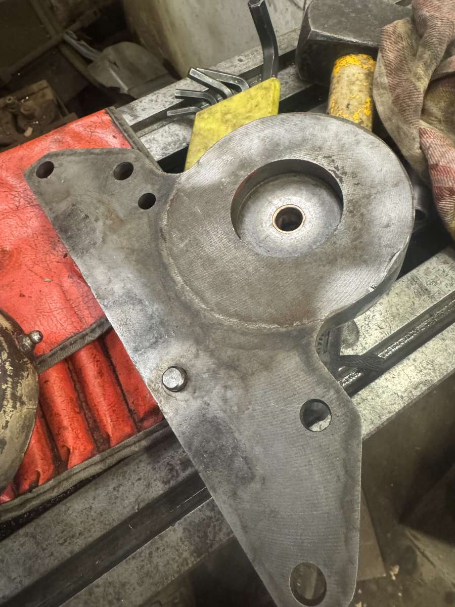

                                                  joshhansen1987
                                                    @joshhansen1987
                                                    Hello all. I recently bought a Beaver VBRP mk2 with a variable speed head and while cleaning it up I noticed some strange things with the speed control knob. I ordered a manual and started going through the parts list and found that the entire rocker arm assembly to move the front pulley up and down was missing.. if anyone could tell me where I can buy those parts, or have those parts I would love to purchase them from you because as it stands right now I essentially just bought a 2 speed drill press. Any help on the matter would be greatly appreciated. Thank you
                                                    -Josh

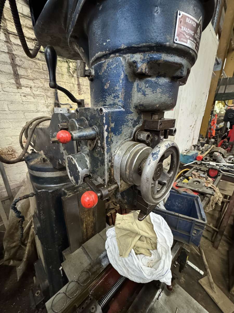

                                                    Andrew Skinner
                                                      @andrewskinner94774
                                                      I’ve just bought a Mk1 VBRP. Can anyone show me what the quill handle and hub should look like? It’s missing on mine:
                                                      IMG_1338
                                                      As you can see, all I have is a hub with four holes, and no obvious way of retaining the quill hub. The manual suggests there should be a taper pin, but there’s no drilling for that. Thanks.
