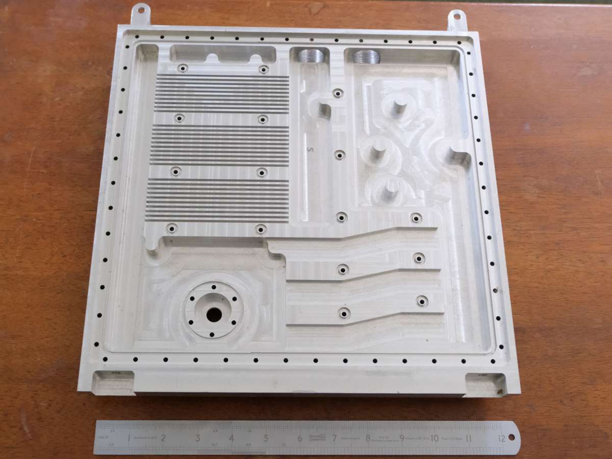

                  It can be frustrating, but hang on in there. By way of encouragement I managed to CNC mill this liquid cooled power electronics heatsink on my CNC mill a few months after I’d bought the mill:
                  Inverter Heatsink
                  Granted I was experimenting with the CNC mill every day making simple parts. But before starting I had zero experience of CNC milling and zero experience of CAM progamming, albeit I was conversant with 3D CAD.
                  It just takes perseverance!
                  Julie

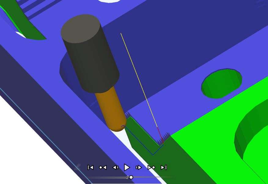

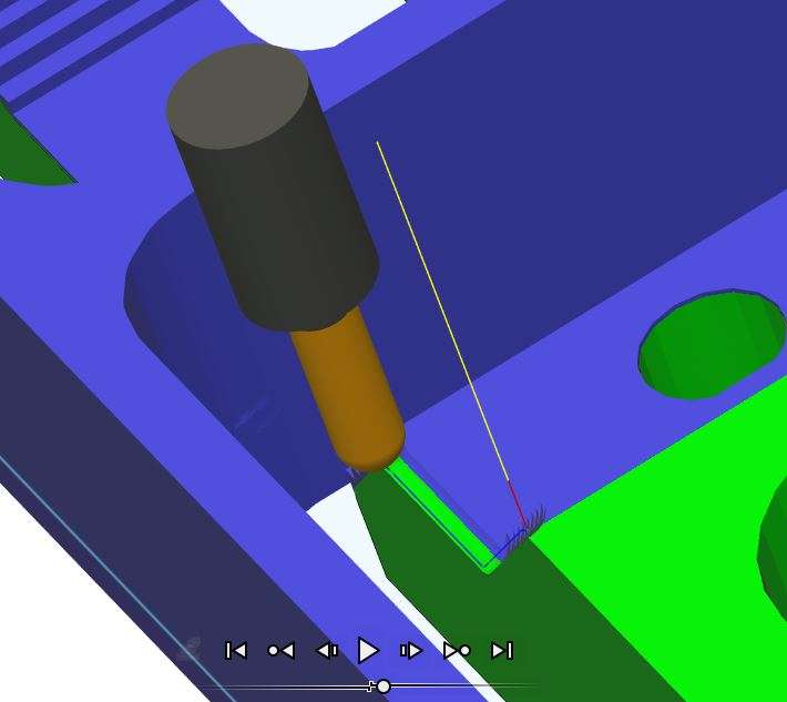

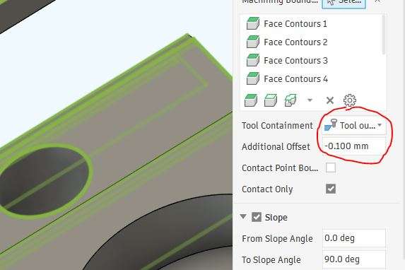

                            Make sure you have the tool ctr set to be outside the boundary. That way it will start taking light cuts as it works its way across. If you don’t do that at beast it will have the ctr on the boundary so the first cut will be 1mm wide.
                            set outside =0.1
                            on2
                            And the first cut
                            on3
                            If set on ctr a much bigger first cut
                            on

                                  Jason,
                                  When I checked, the offset that you highlighted was already in place.  I didn’t put it there I don’t think, so perhaps it’s placed by default to help people like me!
