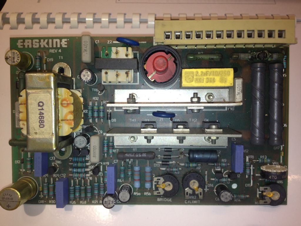

        Hi
        Can any one help please I have a electrical fault on the feed control module of my milling machine and am trying to find out the value of the resistor which has burnt out, the control module is a "ERSKINE Rev4 PD-1114-03-B" control box (on a Bridgeport series 1 mill) which controls the table longitudinal feed.
        if any one has a close up photo, or a circuit diagram of this its much appreciated…
        Here is the crunch all the manuals available that i can find on line, or have got copies of all show the American version which have different circuits.. so it is the English version i am after.
        I will paste a photo a bit later
        Thanks Mark
        #144930
        Clive Foster
          @clivefoster55965
          I have nice, re-drawn, versions in pdf format which I can send if you PM me with your E-Mail address.
          Many thanks are due to fellow forum members John and Ken who kindly supplied me with photo copies of original Erskine data and circuit diagrams just before Christmas which I was able to re-draw and re-dtp into native digital files which print out cleanly.
          Clive

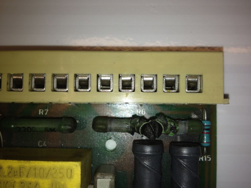

            erskine r6 2.jpgHi Clive
            Thanks for your reply, my email is
            [email protected]
            Many thanks Mark
            For any one interested the resistor in question is R6, which was damaged when a fault occurred with the micro switches and one was effectively welded / stuck, so both were being operated at same time. or thats my conclusion, as to the cause,erskine pcb front 2.jpg

                            Hi folks ,i too am having problems locating the identity of this resistor 6 on our Erskine Power Feed..my email is ……………..if there is any useful info on this please

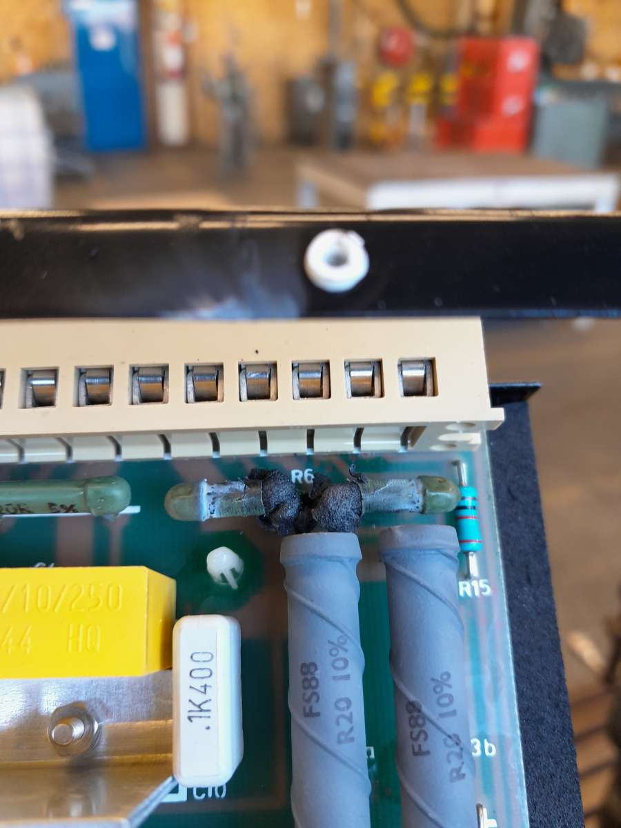

                                              Hi
                                              I am new here, and what led me here is the infamous Resistor R6 on the Erskine PD-1114-03-B Rev.4 on my Bridgeport.
                                              As what have happened to many other here my resistor burned up. when i was using it i smelled something burnt,I stopped and went for lunch and when i came back the feed motors did not work anymore
                                              I opened the Erskine drive and saw R6 bascily in 2 pieces.
                                              I started Googling and that’s how i ended up here.
                                              I want to keep my Bridgeport as original as possible and i’m looking for help to fix it hopefully.
                                              I saw that Clive here had made a circuit diagram and wonder if you can share it with me as well ?
                                              Also if any other here as any tips of what to check before i fix the drive, i saw some comment about cleaning the commutator
                                              Thanks in advance
                                              Henrik

                                                Hi
                                                Does anyone know what value R6 is
                                                #846288
                                                Clive Foster
                                                  @clivefoster55965
                                                  Henrik
                                                  My parts list says 100 Ω wire wound. Unfortunately no power rating given.
                                                  Send a PM to me with your E-Mail address and I’ll shoot the PDF data pack over. Or you could join the Bridgeport group on Groups IO and download it all from the files there.

                                                      Hi
                                                      Update on my Bridgeport.
                                                      I Changed all my caps and the resistor R6  and continued with the fault finding on machine.
                                                      The fault was the micro switches for the feed direction and also the button for one of the fast traverse was bad.
                                                      Everything was repaired and the machine is as good as new again.
