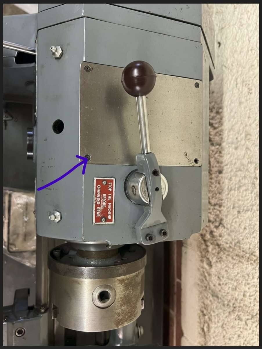

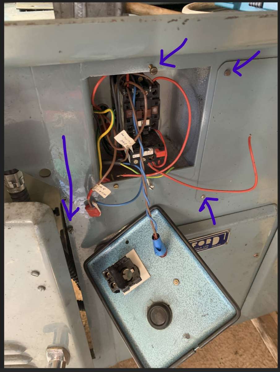

      I’m trying to source some missing / ill fitting screws for my recently acquired CUD and wondering what the correct sizes are for these headstock cover plate and cabinet covers are?

        @alecs
        Possibly BA.
        If you take out the existing ones and measure the TPI and diameter, you can cross check it with the online charts.

          Thank you, I need to buy some magnifying glasses!

            I have no particular knowledge of Boxford lathes but have noted that British industry went through a period of using Unified threads in the latter half of the 20th century before embracing the Metric system.  I suggest it may be worth considering all possibilities.

                BA is likely, but the age of the lathe (1950 – 1975) means they could also be BSF, BSW, UNC or UNF.  Metric might have been used on late models, but unlikely.  Even though the UK decided to go metric in 1963, and BA threads were declared obsolete in 1966, metric wasn’t widely used before about 1980.  In 1950, when the Type C first appeared, a British maker would probably have gone for BA (which are excellent for small fasteners), except the UK decided to standardise on UN in 1949, and Denford might complied with that.
                Best to measure threads – it’s a muddle. Even with a good eye it’s not always easy to identify a thread system, nor is it completely safe to rely on what individuals have today; they may have a variant.  Therefore I suggest coughing up for a couple of thread gauge sets and a jewellers eye-piece.

                    Thanks, I’ve a whitworth / metric guage and one of the nut / screw beads with UN and metric, but obviously need one with BA, as I suspect thats what they are. The very small ones on the top plate are difficult to measure.

                    Yes, and measuring the holes has not been too successful so far. Thnaks for the link to the owners group, I’ll join now😊
