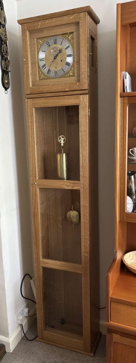

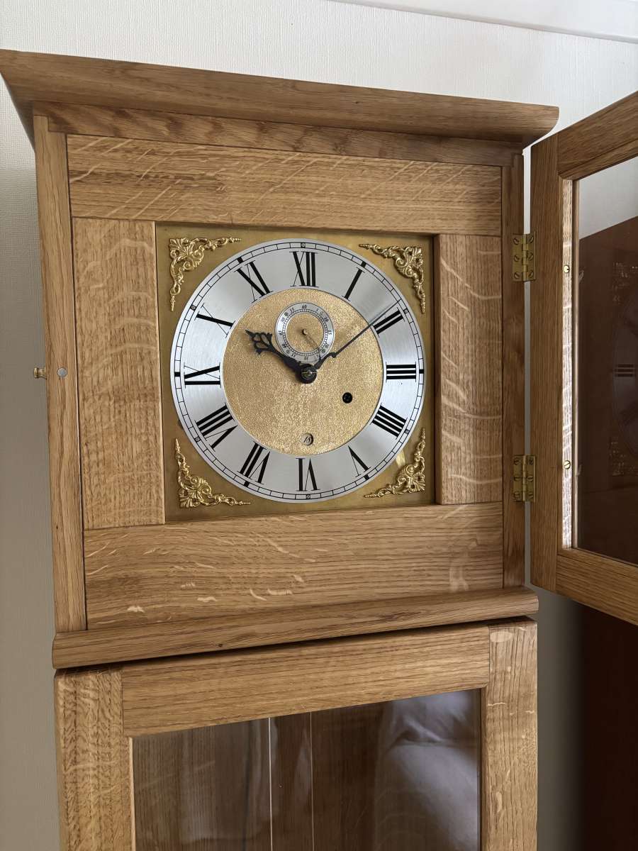

                                    Just finished John Wilding 8 day clock with calendar and chime and used 1/4 sawn oak to make the case. IMG_0015IMG_0011

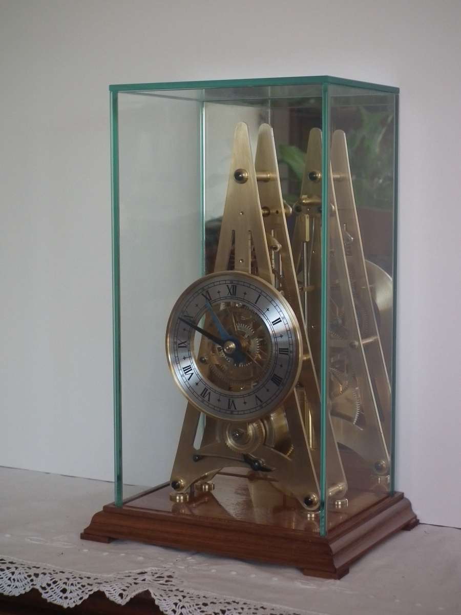

                                      My first clock was John Parslows 15-day skeleton timepiece.  It was a fairly straight forward build with detailed instructions given in a short series of articles in ME starting March 2008.  You should be able to find them in the archives.
                                      DSCF2209
                                      Still running well with just a clean and lube after its first ten years of running.
