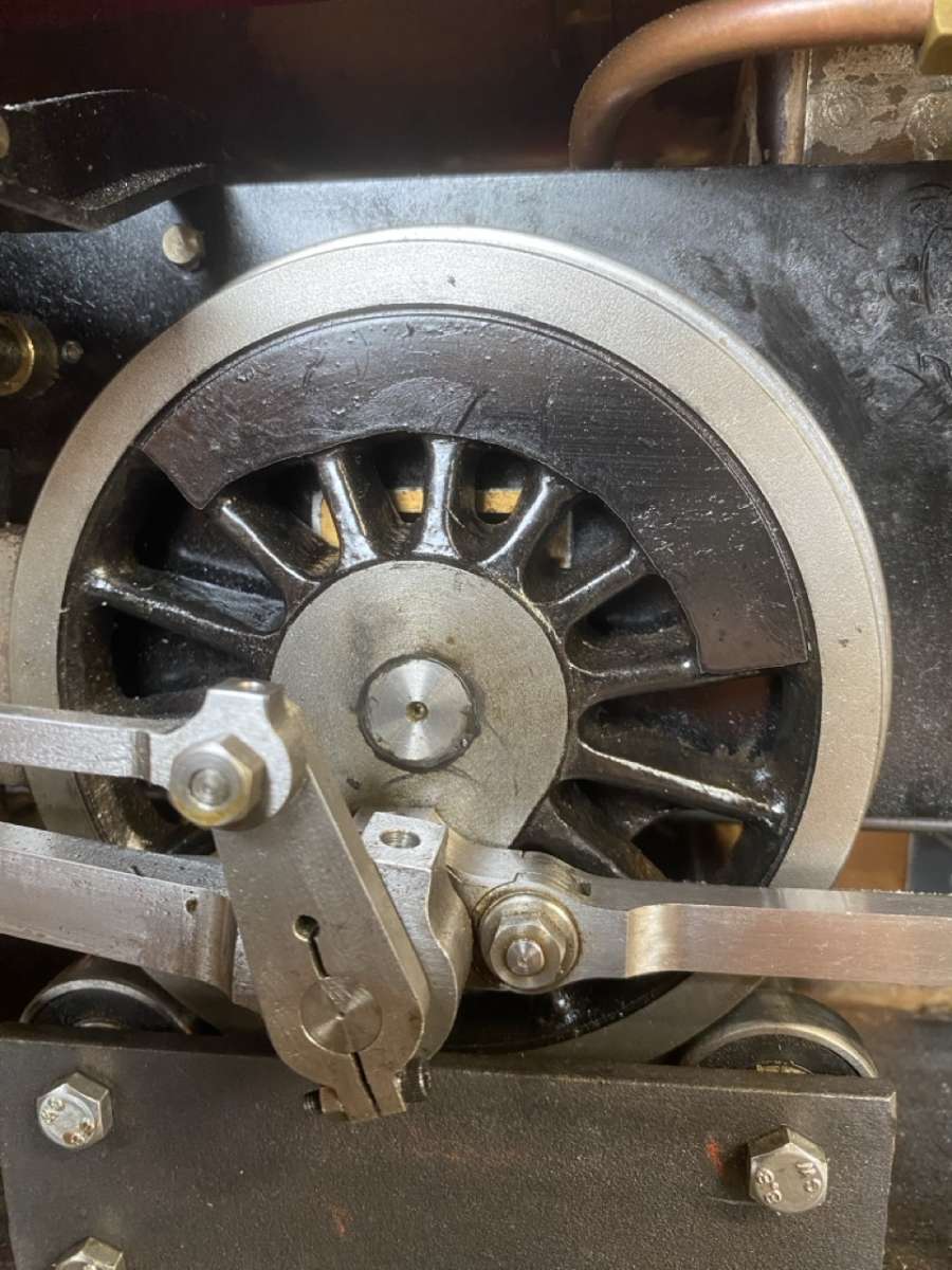

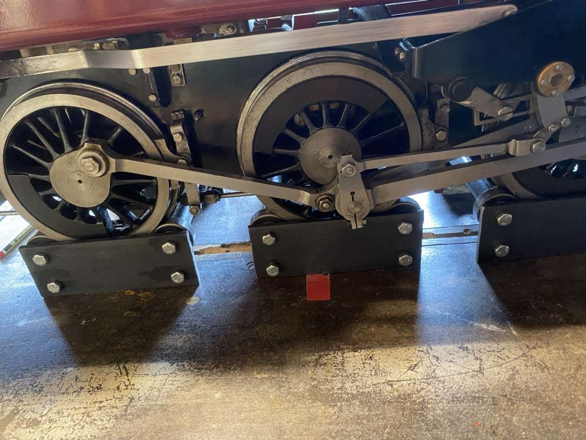

    Speedy Builder5
      @speedybuilder5
      I was going to title this BONDAGE, but thought better of it.
      The first of these photos are typical ??  signs of where wheel to axle bonding has broken down and perhaps should be part of routine mechanical checks. See the black oily ring where the axle is bonded to the wheel and “fretting” in service.  The second photo is the catestrophic result (fortunately in the workshop).
      WheelSlip2 Large
      WheelSlip3 Large

        Nigel Graham 2
          @nigelgraham2
          Shows the need for a key as well as any adhesive. I hope you were able to repair it satisfactorily.

            Nicholas Farr
              @nicholasfarr14254
              Hi, drill a hole *(or two if you wish) between the axle and the wheel, and put a pin in it, this will then act as a key.

              Clive Foster
                @clivefoster55965
                Nicks suggestion of a pin is good but a dutch key may be better as it’s easier to remove if need be.
                A dutch key is a threaded hole centred on the joint line so half the thread is in one component, the wheel in this case, and half in the other, the shaft in this case. I’d use a hex socket grub screw taken a bit below flush so a thin slug can be stuck in place to obscure the hex.
                Adhesive bonding is known to be sensitive to joint thickness when under repetitive pulsing loads tending to break down, as in this case, should it be a bit on the thick side.
                No doubt that press or shrink fitting with the appropriate interference fit between a nicely finished hole and shaft pair is best. But achieving the required tolerances with typical Model Engineering / Home Workshop equipment can be challenging.
                Regrettably the method isn’t appropriate for retrofitting without re-making parts but, in my view, this is a good application for self gauging taper fitting where both parts are made to a very shallow taper equivalent to twice the interference fit on diameter over the joint length. Called self gauging because when the components slip together over half the length of the joint before pressing becomes necessary the mutual sizes are correct. Swops a very tight differential diametrical tolerance between the two components for a much more relaxed longitudinal one applied to one component. If there is a thou or three error from true half way in the gauging position the effect on actual fit is negligible. Being tapers accurate alignment is much easier than with parallel shaft – hole pairs. If fitted cold there is no scraping effect where the front edge of the hole rubs down the, slightly larger parallel shaft. Pennsylvania Railways fitted their wheels in that way so its known to be effective on locomotive loads.
                Clive

                  Clive Foster
                    @clivefoster55965
                    Martin
                    The issue with Loctite, as with all adhesive processes, is “used correctly”. Many a slip twixt cup and lip so even apparently superficial errors by inexperienced, usually untaught, folk can lay the seeds for catastrophic failure down the line. Lets face it almost none of us are adhesives experts and a similarity low percentage are set up to apply adhesives perfectly as per the book. Even in factory production considerable care in setting up is needed to get reliably close to best results.
                    In practice there is a considerable margin where being clean and careful will produce entirely adequate results. Even though the bond strength may not meet advertised values. Quick failure is usually due to materials having incompatible surface energy that the adhesive won’t properly bond to or overly smooth surface with no mechanical locking. Naturally assuming no “I can’t believe I did that” class errors such as an inadequately clean surface so the adhesive sticks to the grease or whoever and does a super-duper cleaning job when it comes off.
                    Regular racking, pulsating and twisting stresses applied to an over thick adhesive bond pump energy into the adhesive causing it to break down. Back in the days before folk got to trust Loctite, before it wasn’t generally realised by ordinary folk just how thin the bond needs to be, it was often suggested that the ends of a bonded area should be a gnats thingy proud requiring a firm push to seat with more clearance in the middle for the “glue”. Presumably the theory being that the ends would do the supporting and the Loctite would stop things twisting apart.
                    A perversion of the whole Loctite thing.
                    These days folk seem to have gotten the message that a smooth, sliding, rock free fit provides plenty of room for enough Loctite to bond really strongly providing the appropriate sliding and twisting is done to ensure full coverage of the joint. Which can, I imagine, be an issue when quartering wheels. The thinner a Loctite joint is the faster it goes off. Which sometime doesn’t help. I’ve had one on a 12 inch to the foot scale job that almost went off before it was fully home. I wasn’t hanging around with fitting either due to expecting such problems.
                    Although Loctite has some, small, gap filling ability exploiting this can be chancy.
                    Clive

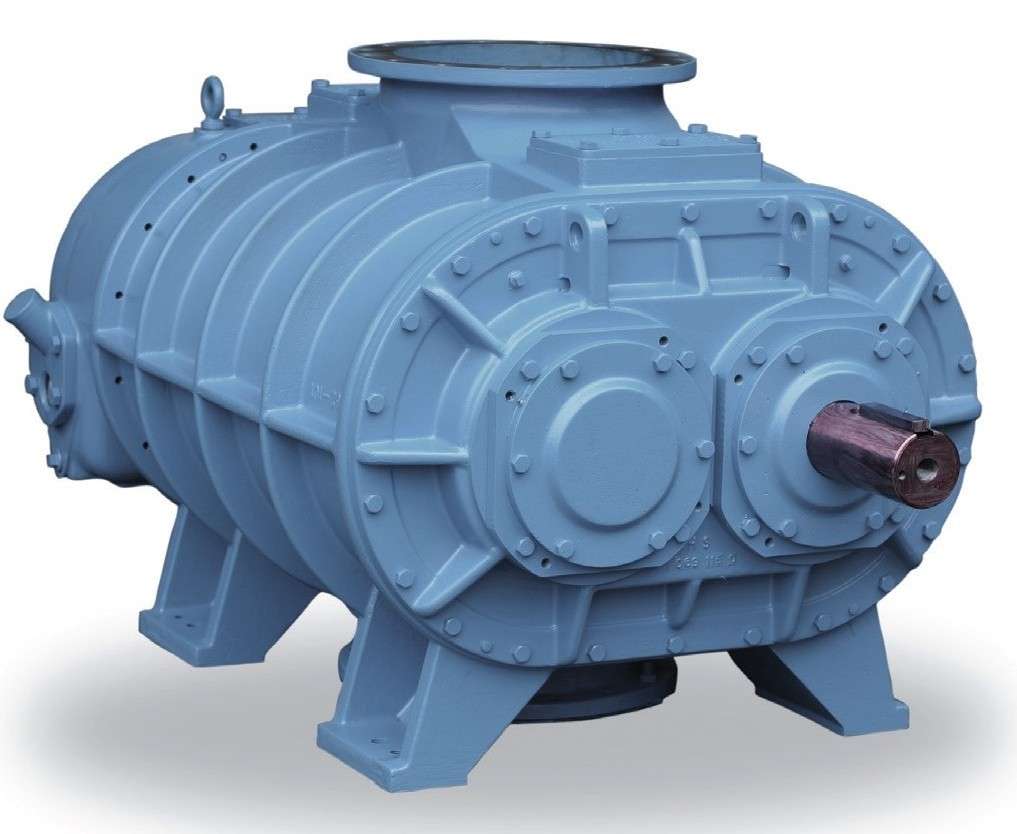

                              roots-positive-displacement-blower
                              The two at the end in the foreground were straight forward, but the two at the other end were a different matter, as these were on the other side of helical gears, which were on tapers, these are pressed on while very high presser is pumped down a hole in the end of the shaft, and into the joint between the shaft and the gear, which expands the gear a few microns, and when the gear has been pressed into it’s working position, the pressurised oil in the shaft is released, which clamps the gear to the shaft. Needless to say, to get them off needs the reverse procedure. The shafts for these bearings were about five or six inches in diameter, and the tapers were only a little smaller, and the company I was working for, didn’t have the equipment to remove and replace those gears, and so the bearings and the unit was sent to a company that could undertake the task,as the timing of the vanes inside was extremely crucial.

                                      Speedy Builder5
                                        @speedybuilder5
                                        I think it is worthwhile thinking that model locomotives and wheel bonding has been around longer than any of us here !!!  LBSC didn’t have Loctite or a similar product, he relied on a press fit.  We seem to have drifted away from the possibility that old methods did work, do work and in some cases are still working.  Going back to my earlier post, I think the constructor who started this project left using Loctite until he was sure that everything was working and running freely – but didn’t pass that information onto me at point of sale.  I bought with eyes open, “sold as seen” and have no complaint with the builder.
                                        Latest – I have now made the quartering jig and will “press” ahead with Loctite and pins. As to the pins, I have filed a very light flat on the outer edge to allow air, loctite to escape whilst being pressed in.
                                        Bob

                                                Speedy Builder5
                                                  @speedybuilder5
                                                  Just a final note, Wheels are now back on the axles with pins and coupling rods etc all fitted, and we have rotation once again.  However, not without panic !
                                                  The wheels are a pretty close push fit and the Loctite 648 probably 4 years old.  The first couple of wheel Sets passed without incident and each left to set overnight.  The third and last was all set up, Loctite applied and wiped around the joint and axle but the bonding started to grip before the joint was less than 50% pushed home.  I had only taken probably 30 seconds before I couldn’t push the wheel further onto the axle and at that point hadn’t got the wheel well aligned and had to break the joint and start again.  Here the problem started to move into panic stations.
                                                  Fortunately I had an aluminium drift to hand, a 2lb hammer and a wood vice and was able to break the joint and remove the wheel. It was well bonded and I feared the wheel may break in the process, but luck was on my side.
                                                  My second go turned out well and I only applied the loctite to the inside of the wheel and not the axle.  I can concur with Duncan that old Loctite behaves very differently to fresh product as the stated Cure Time at 22deg C is in the order of 10 minutes.
                                                  Thanks to various contributers
