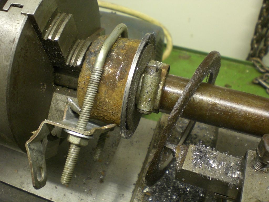

                        Hi, yesterday evening, I cobbled together this TV aerial bracket onto a worn out 4" conveyor belt return roller bearing and hub, in order to trim it down, while keeping it reasonable true so as to make a smaller roller of a similar type.
                        First of all the bulk of it was cut away with a parting tool and it was then turned to size to fit onto a smaller piece of tube. One for the other end is yet to be done in the same way.
                        Regards Nick.

                          What was someone saying about chuck guards?!?!?

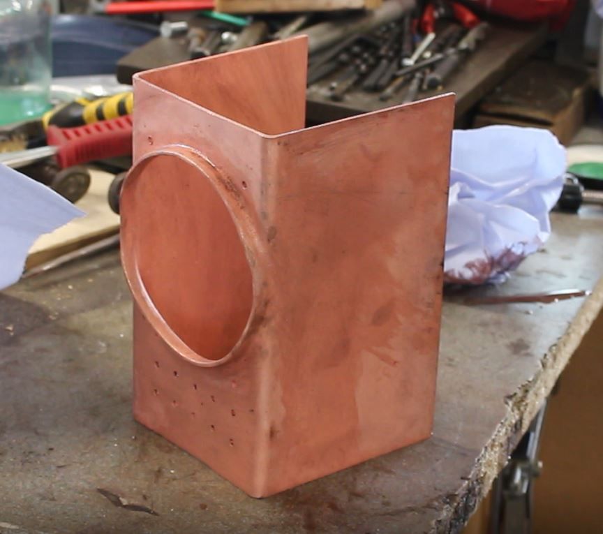

                            Continued my 5"g LION build series bending up the throat plate, proved to be a challenge to get good tight corners.
                            The previously flanged material pulled in at the sides so I learnt the lesson that I should have made an allowance when I made the blank ready for flanging and should have left some additional material at the sides. However, because the the sides are right up to the flange and the flange blends into the corner radius the width of contact for silver soldering remains pretty much constant, so it looks like I got away with that one.
                            For anyone interested in following my build here's this particular video: Bending the Throat Plate

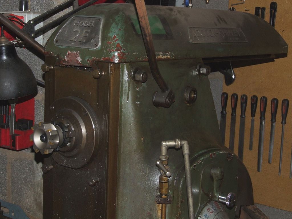

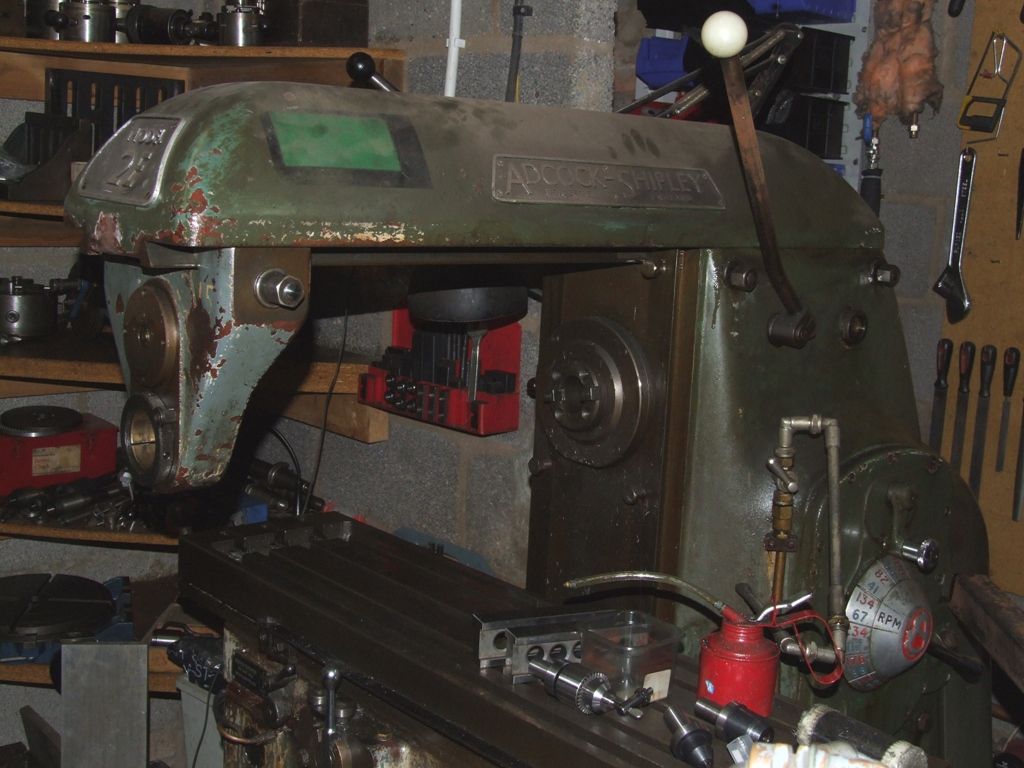

                                        Among other things I finally got the overarm on the horizontal mill shifted from this:
                                        To this:
                                        It maInly involved BF and BI, ie, hitting it with a copper hammer. Once I'd got the arm moved 8" or so, plus copious amounts of oil on the dovetails, I could move the overarm all the way in and out simply by pushing on it. Which is where I was 10 years ago. Must remember to exercise it now and again and add oil. The reason for moving the overarm back is so I can use the face mill shown to start roughing out the cylinder castings on my traction engine without said overarm getting in the way. The face mill may look small, but it is 80mm diameter.

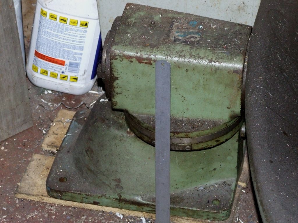

                                        I might even get around to fitting, and trying out, the vertical head for the mill I bought years ago on Ebay:
                                        That's a 12" rule against the head. The main issue is working out how I'm going to lift the vertical head onto the mill table without involving a trip to A&E. When I bought the head I lifted it from the car boot to where it is now. But that was years ago, no way I can just pick it up and lift it now. sad
                                        Andrew

                                          If you ever get the ram off, take the opportunity to install a few oil nipples, so you can jack the surfaces apart and make everything slide easily.

                                            Andrew those 2 Es are nice machines,watch out when you go to get one of your files from the wall clips,dont come up quick and bang your head under the mill overarm sticking out the back,I found that the vertical head gets heavier as you get older,I used to get my mate to help me lift it,they can be lifted with an engine crane,Adcocks should have built in a lifting arm and a parking place for the head on the mill column like some manufacturers did. At least with a head like that and a 40 int spindle ,some really decent cuts can be taken with end mills ,and facing cutters,we were going to downsize so I passed on the mill to a friend,then the house sale fell through ,I will never get rid of anything in future unless the sale documentation is completed.

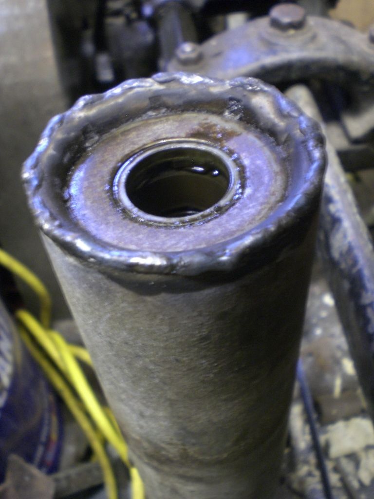

                                              Hi, I had a little time to do a bit more on my roller with the reclaimed hubs and bearings. I cut and trimmed a piece of tube to length and fitted and welded the hubs/bearings in place.

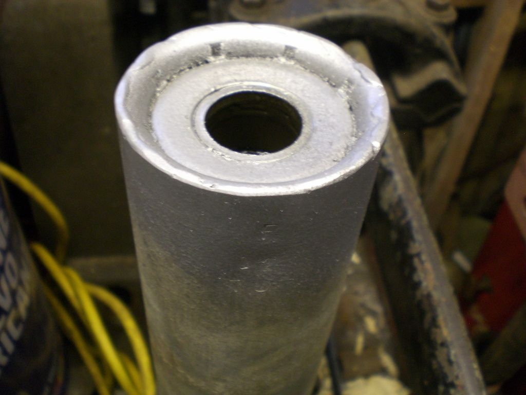

                                              They were then dressed using a flap disc and spray painted with a Zinc paint rattle can.

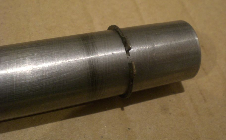

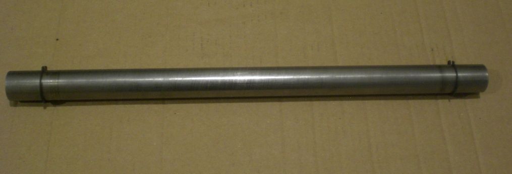

                                              Then I faced up the ends of a piece of 25mm EN8 round to length and cut in a circlip groove 30mm from each end, this being the new shaft for the roller.
                                              Just need to mill a couple of flats on each end and it will be ready to assemble.

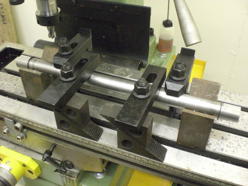

                                                    Hi, I milled the flats on the ends of the shaft for my new roller. First side was set up on "V" blocks.

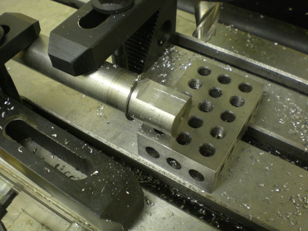

                                                    The second side was set up on my 1-2-3 blocks on the first side flats.

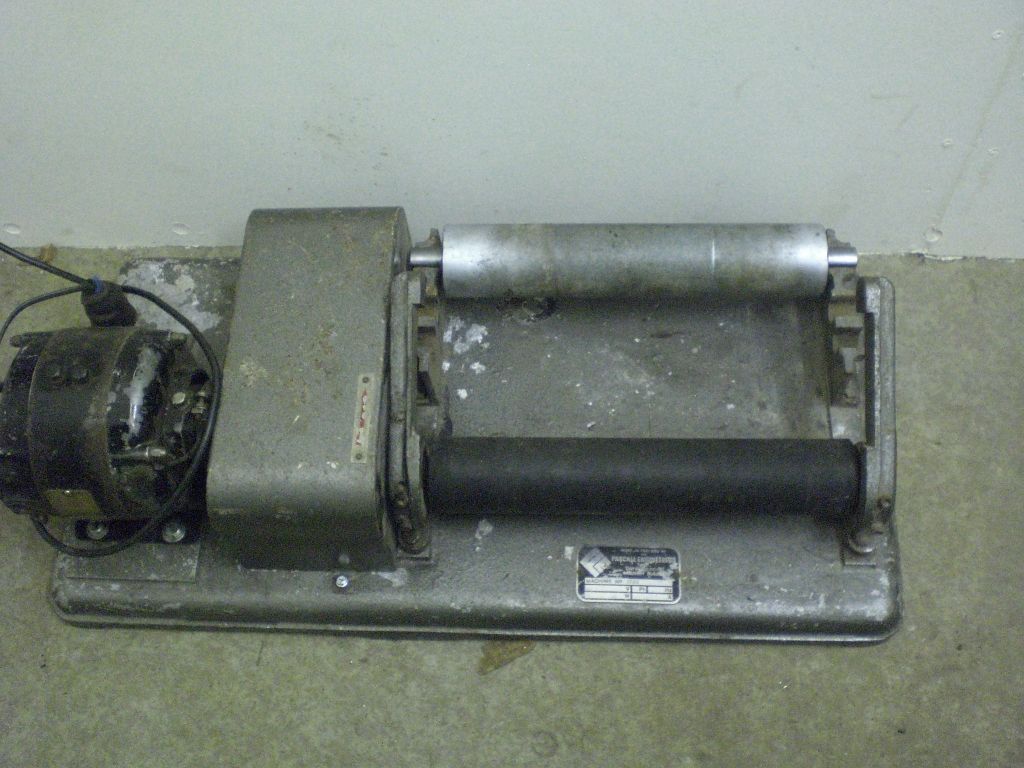

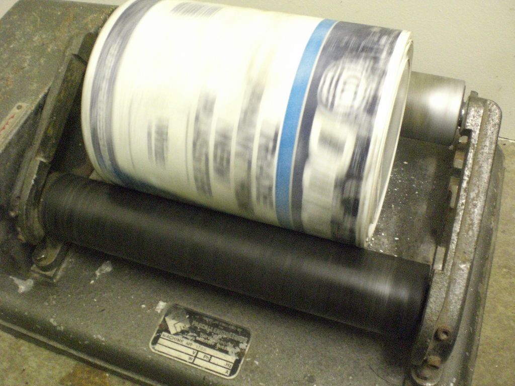

                                                    The shaft was then fitted into the roller and then put onto the machine that I've been making it for.
                                                    This is a tumbling machine that was scrapped by the company I used to work for several years ago now, but I had to remove the motor that was on it first, and fit it to another different type of machine. The original roller and any drums that were used on it, had been missing for quite some time. So for a trial run I've used an empty 5L emulsion paint plastic pot and filled it just above half way with some dry sand and put in a few rusty wheel castings.

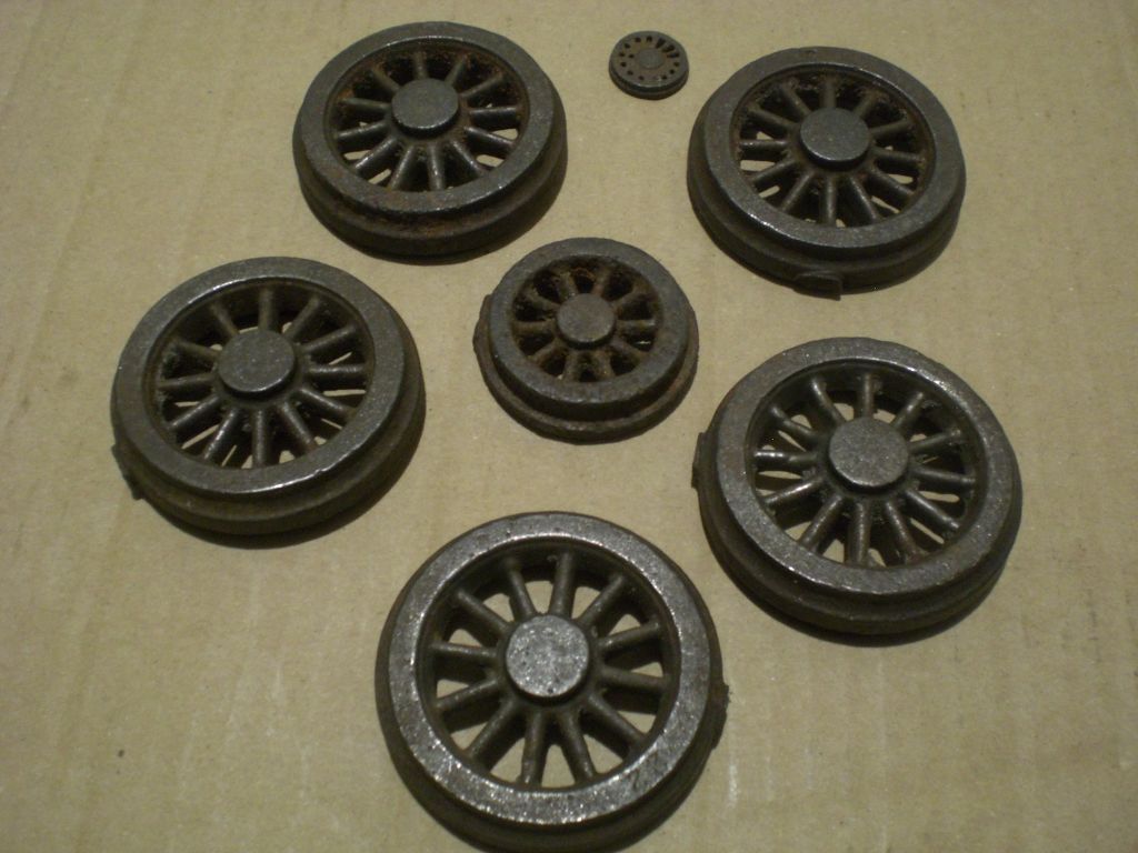

                                                    I gave it a run for about 15 minuets and although it wasn't ideal, as there are no baffles to make the sand and wheels tumble properly, but it did drive OK and cleaned the wheels slightly. Just need to buy or make a proper barrel.
