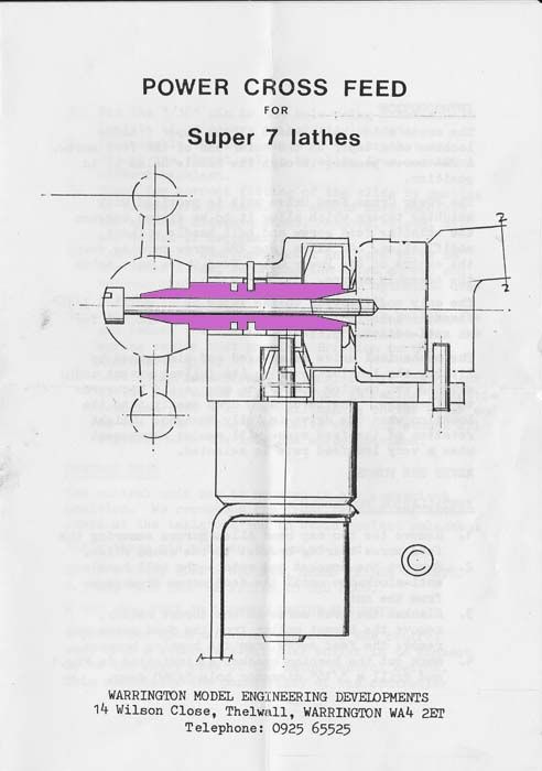

                I have had a hunt on line for information on the WMED power feed attachment, but can only find a couple of pictures and a cross section drawing on this site.
                Has anybody got information on these they would be willing to share?

                    MEW issue 236 ( December 2015 ) had an article describing a similar power feed for the Myford Super7. Pages 21 to 25 inclusive, if you wanted to make your own.

                      Ken,
                      I think they made versions for the ML10 as well as the ML7 & S7. The machine specific bit seems to be the main shaft that I have coloured pink:
                      Fitting on the S7 is straight forward. The ball handle fits on a taper and is retained by the screw. Remove the ball handle. The device has a matching female taper which fits on the end of the cross slide screw in front of the dial and a male taper for the ball handle to mate with, the whole assembly being retained by a new longer screw. I am unfamiliar with the ML7 and do not know how they changed the design to fit.
                      HTH,
                      Rod

                        Rod
                        The one I have is for a ML7 but I can make it fit the Super 7.
                        I can see that it all "hangs' from the cross slide screw, and the motor and gear slide for in and out of gear.
                        The whole thing is stopped from rotating by a pin in the cross slide end bracket.
                        The pin is missing from the kit I have, could you give me some idea of what size this pin should be please
                        Thanks to you and everybody else who took the time and trouble to post
                        Ken
                        #304744
                        Roderick Jenkins
                          @roderickjenkins93242
                          The pin is 3/16" diameter and the instructions call for the hole to be drilled 3/16" x 5/16" deep and the pin to be retained with Loctite.
