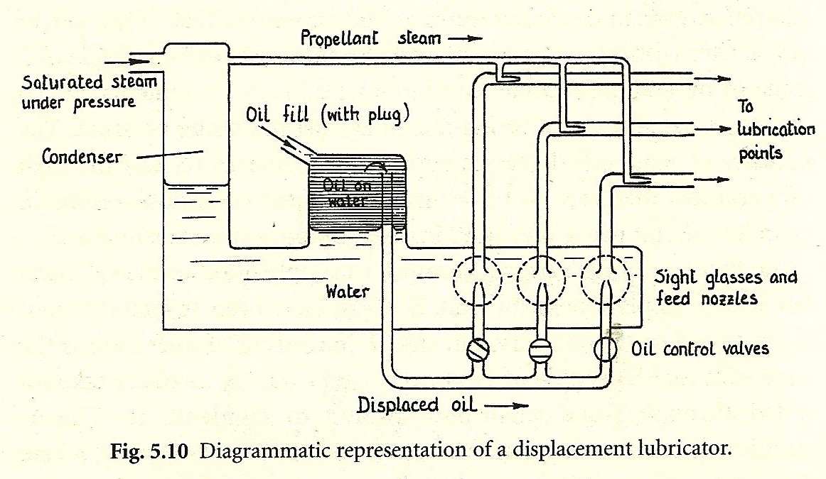

      duncan webster 1
        @duncanwebster1
        this diagram might help. The ‘saturated steam’ was fed through a jockey valve attached to the regulator handle on GWR locos, regulator fully shut, steam off, slightly open steam fully on. The oil is driven out of the oil container by the head of water in the condenser. In GWR locos the condenser was a coil of pipe in the cab roof. Oil feed is not dependant on how far the regulator is open. If you miss out the Propellant steam connection, it still works but oil feed is dependant on difference between boiler pressure and steam chest pressure, and the wrong way round, regulator wide open least oil feed.. There was an excellent article by I think Fred Cottam in ME many years ago, but I can’t find it.

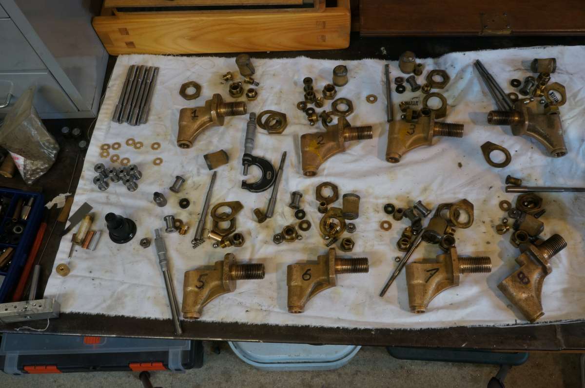

          Advantages are comparative simplicity, and that the crew can see oil being fed, drop by drop, and the individual feed rates can be adjusted. Mechanical lubricator pumps are much more complicated, require finely fitted parts, and it is a lot more difficult to adjust individual feed rates.
          Here are most of the innards of an 8-feed Silvertown mechanical lubricator on my bench:
          Silvertown Lubricator 2020

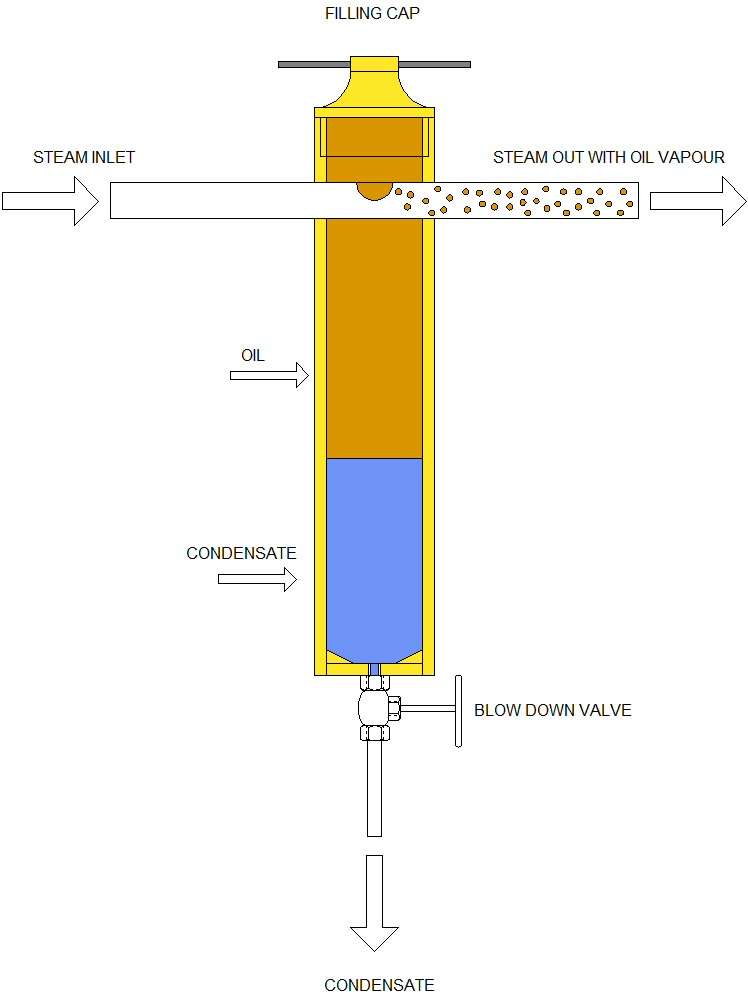

            Its basically how most model boat lubricators work, but we call them displacement lubricators.  The principle is precisely as above, condensate collects in the bottom of the lubricator, which then displaces the oil out at the top.  In model boats this is actually into the main steam line to the engine to lubricate the internal surfaces but in the locomotive example above it obviously then drip feeds bearings and slides etc.  On such small engines as used in many model boats a mechanical lubricator takes too much energy.  Just for interest this is a boat version:
            IMG_0001

                      Looking at it again, it’s not a good diagram, I just found it on the web. In the gwr system, the condenser is in the cab roof, so there is a constant head of water between that and the oil container pushing the oil out into the propellant steam supply. Hence the name hydrostatic.
                      The difference from displacement is that hydrostatic is fed with boiler pressure saturated steam and has the propelling steam, whereas displacement would be fed by superheated steam at steam pipe pressure and no propellant. Actually I’ve just realised that Richard’s drawing is different to most displacement lubricators I’ve seen in that usually there is only one connection to steam pipe, the steam goes in the same hole as the oil comes out,  so it’s a sort of cross.

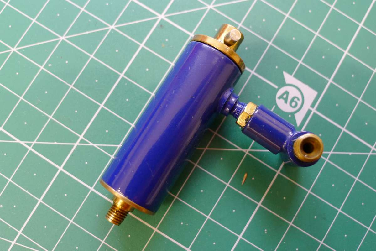

                              Thanks Duncan, I guess the basics is that in a hydrostatic lubricator the driving pressure is from a constant head of condensate in a tank, hence hydrostatic, whereas a displacement lubricator is driven by live steam creating the condensate in the lubricator.  It may not necessarily be superheated, particularly in many model steam plant.  The difference then being that the driving pressure isn’t static, it varies with the steam output from the boiler.

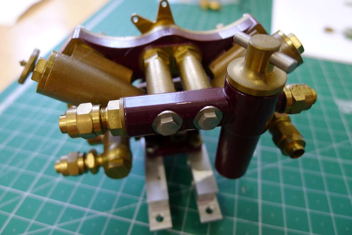

                              Even in the niche area of model boats there are many different takes on what may be considered a displacement lubricator.  From the most basic straight through connection with no drain facility:
                              26-03-24-02DisplacementLubricator1

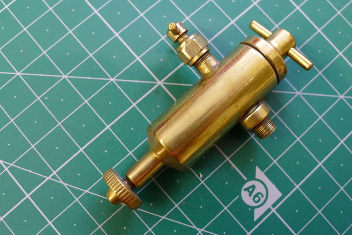

                              To a straight through type again with no drain facility but incorporated into the engine:
                              26-03-24-03MonahanHeronEngine1

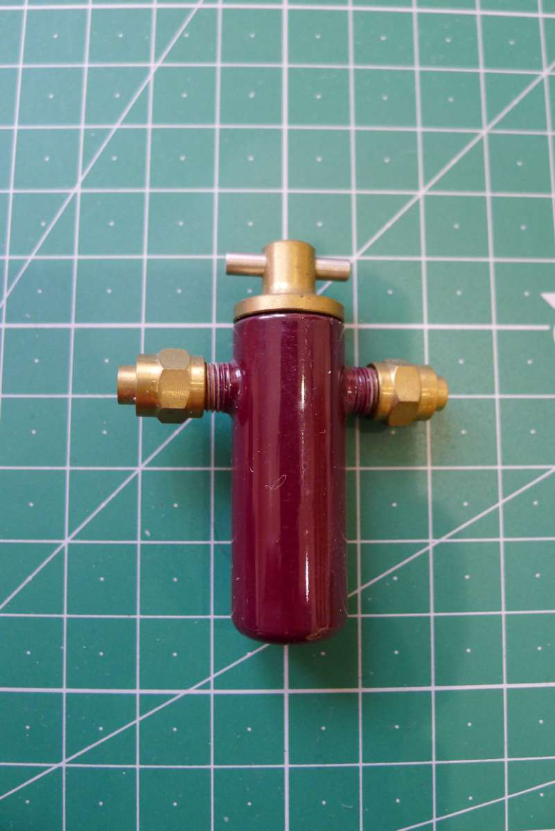

                              To the type described where the steam going in is a common connection to the oil coming out, now with a drain connection:
                              26-03-24-04DisplacementLubricator2

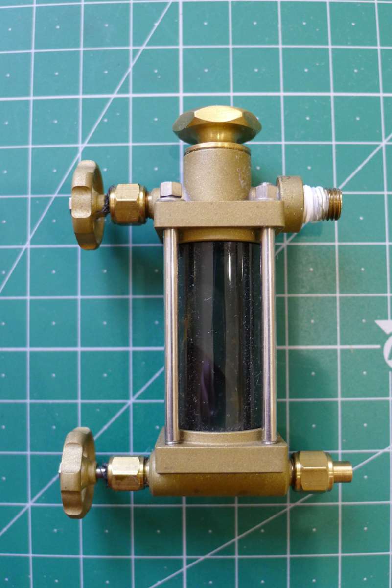

                              To the most sophisticated with needle valve control, built in drain valve and a glass body so the oil can be seen:
                              26-03-24-06DisplacementLubricator4

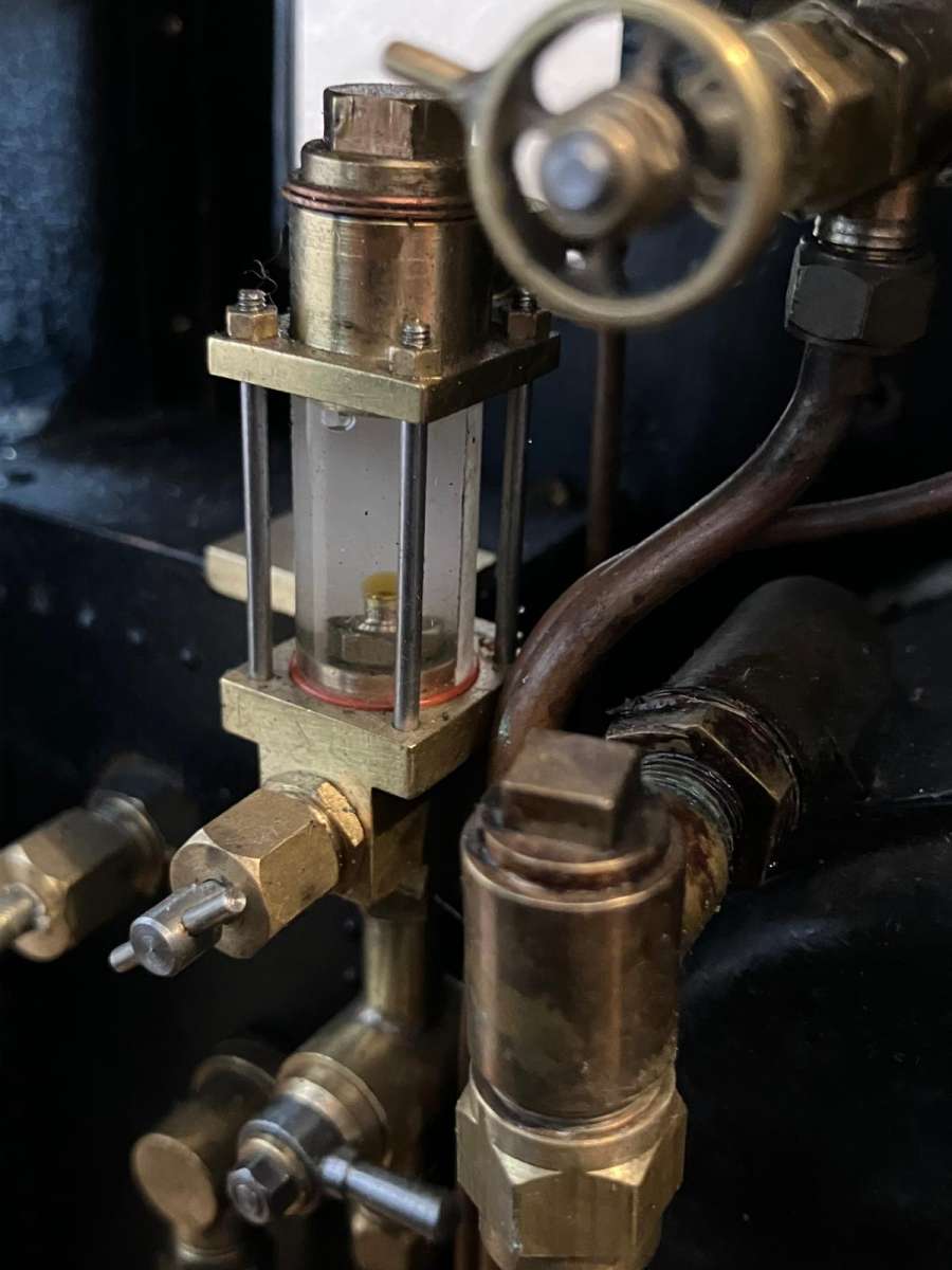

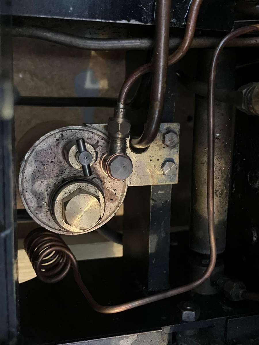

                                  As the original question was about locomotive use, here are some pictures of a system I installed on my ancient Simplex, and I will try to explain how this particular installation works. The bottom picture shows the sight glass fitted in the cab, the top picture is the tank fitted under the footplate, I’m afraid I can’t re-orientate the picture so will have to be described as above or below instead of left and right. below the oil tank can be seen the condensing coil fed from a steam valve on the manifold, this connects to the base of the oil tank. The hex headed plug is the oil filler cap and the tee handled valve is the tank drain, the connection banjo union fitting goes to the oil feed sight glass in the bottom picture. In the bottom picture the valve below the sight glass is the oil on off, the tee handled valve regulates the oil feed via the small nozzle in the bottom of the sight glass where a blob of oil can just be seen forming, at the top of the sight glass is the connection to the cylinders, a small bore pipe is run to the tee connection of the main steam pipe feeding into the steam chests, via a restrictor to prevent gulping of oil, feeding the cylinders.
                                  In operation the steam fed via the condensing coil which is at boiler pressure, condenses to water pushing the oil up into the sight glass, if the oil valve is open the regulating valve can be opened until a steady flow of oil blobs can be seen to float up through the glycerine in the sight glass, around two a minute seems to keep my engine happy, through the oil delivery pipe to the cylinders where through the restrictor mentioned earlier it feed to the cylinders, in this case to the steam feed tee. My understanding is that because steam chest pressure is less than boiler pressure when running there is always a positive pressure to force the oil through. I don’t know if it is classed as displacement or hydrostatic but it does work well and is very controllable. You do have to remember to close the oil delivery valve if stationary for a while or you get a bit spotty. Hope this helps I’m afraid written explanations and theory are not my forte, but i thought some pics of an installation might help.
