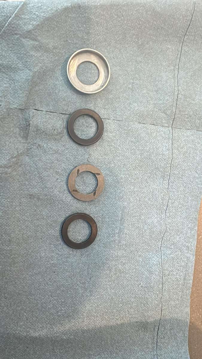

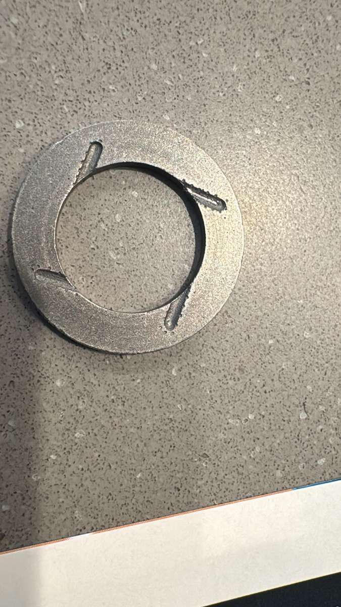

      Hi All, A friend in the USA is renovating the Kingpins on his very old Citroen 2cv car. A box containing all of the relevant replacement parts duly arrived. There are 3 replacement thrust washers, 2 hardened steel and a phosphor bronze one, for each wheel, or should be PB. It turns out to be a silvery colour, instead of a normal pinkish brown. There are 4 grooves for holding grease and he scrapped one and the resulting mark is silvery. I googled alternatives for PB and the result was only different grades of PB, nothing resembling what he has received.
      Photos included, the right hand groove has the scratch mark clearly visible. Any ideas? ps Made in China. Also looks like minute  auto centre punch markings around each groove? Surely a mass produced part like this wasn’t marked out?  Thanks, Graeme.e4559091-2bb9-4de9-abd7-28904339e6c22fc1eeaf-3e8a-4dc1-8571-8a92dca4ca4c

        The picture of the thrust washer makes it look like a sintered material – an oilite type of material?

          I’d go with Dave, an oilite type material. Not sure it will work well with grease though. Some one with a lathe could soon spin some up. Good luck. Noel.

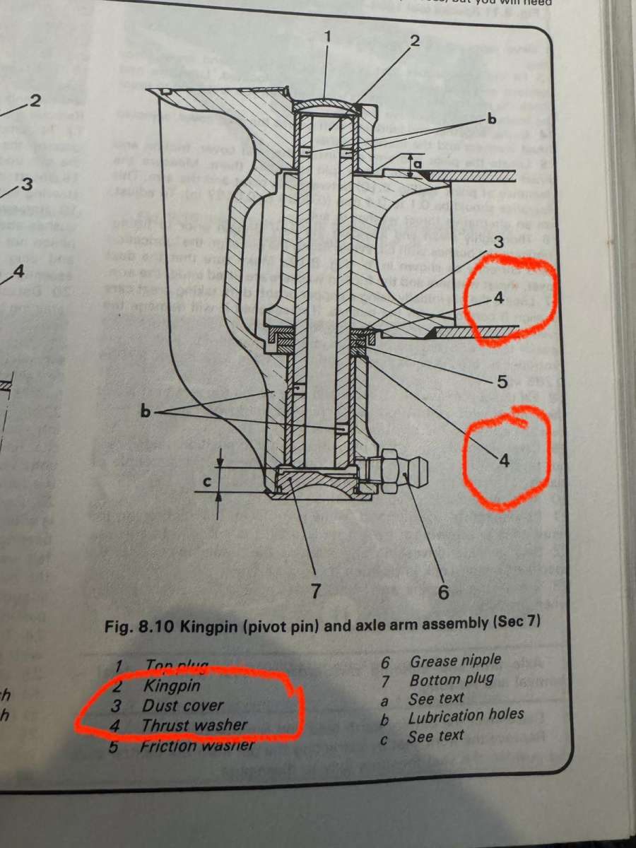

            That looks like standard 2CV king pin kit.
            Top Hat washer is the dust seal, Black thrust bearing, then the friction washer and finally the second thrust washer. Clearance between the hub pivot and the suspension arm should be 0.1 – 0.4mm (0.004″ – 0.016″).  If available, use thicker thrust bearings or steel shims between dust cover and thrust bearing.
            It looks like the “friction” washer is sintered and perhaps should have been called “low friction” washer.
            The Thrust bearings should be hard.

              Aftermarket car and motorcycle parts made in China have a widely varying range of quality.  Having been caught out multiple times in the past, I will no longer fit them in any critical application. Inferior material is one of the most common problems. Sintered washers are cheaper than bronze and may or may not work OK.
              And yes, small volume production runs such as for specialist restoration parts quite likely have a good amount of hand work on them, such as manualy marking out and cutting those grooves. Labour is cheap there.

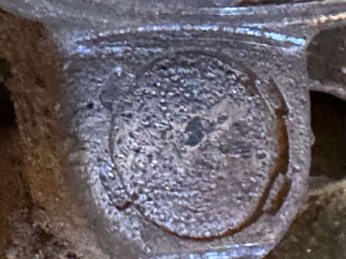

                          Hi, this topic started with myself asking about a supposed PB thrust washer as an alternative unknown metal type. I’ve learned that Rio Tinto supply a powder for sintering this type of item to the motor industry.
                          Bernard knows his stuff, but doesn’t mention “peening” after the plug is hit flat, as official workshop manuals specify, as supplied by Citroen. The plug hole is 24mm dia, the plug is 24 dia, once flattened its supposed to seal. The 4 original peen marks impede the plug and its correct seating/interference fit. People make the plug more concave with a big ball bearing to get past the peen marks and then severely overhit it and then add another 4 peen marks. Now we have 8. Next time 12 and so on. Ends up looking like the craters on the moon. Citroen didn’t explain fitting engineering items together very well, utilising mallets and sharpened chisels to  dislodge and insert axle arm bearing taper roller cups. Maybe “peening” was an oversight too. here’s a couple of photos of two originally fitted Citroen Welch plugs. Back to my washers, Rio Tinto engineer says the powder is low nickel stainless steel, they are magnetic. thanks, Graeme. 746fb0a1-ceb4-41ad-932e-efacad6ddefd88764185-0d12-4eff-b7a7-9b6aa2c6ee09

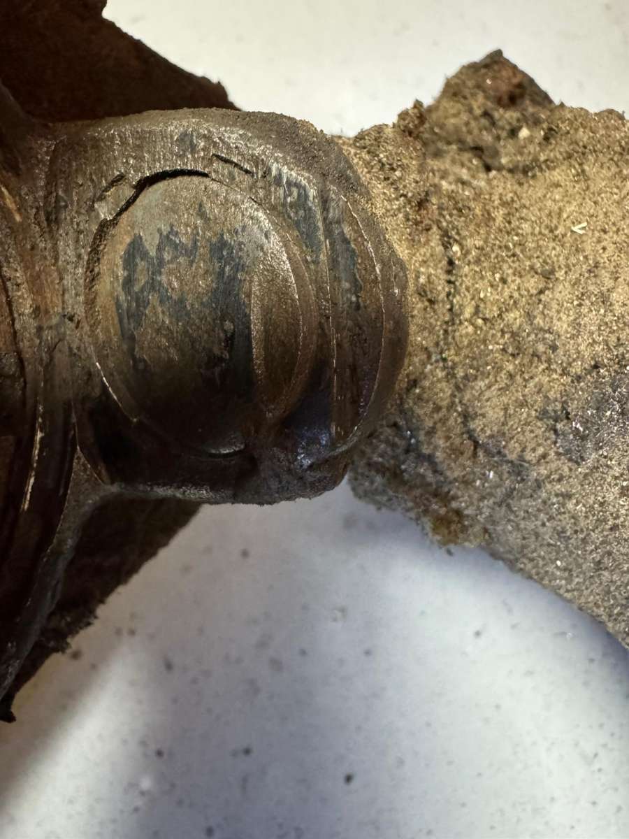

                                  going with Wikipedia’s definition, its a welch plug [very good post, as usual, Michael] Its 24mm diam and 2 thick and is domed. It’s flattened and forms some kind of interference fit, with its edge[s]. The staking or peening is an additional securing idea [Citroen], to prevent high grease pressure pushing it out, far higher than an engine block pressure. You can see, from the 2 photos, that both are not sitting completely flat and have risen a bit on one side, encouraging leakage and blow out. Believe it or not, I’ve seen the severely damaged top casting with these plugs, due to many center punch marks, WELDED in. A sorry state of affairs.
                                  A new plug cannot fit past the original stake marks, so people make them more domed with a large ball bearing and  attempt to fit them in. Never works. So they Dremel off the stake marks, fit the plug and add 4 more indentations, eventually destroying the top cap area. I suppose that car makers designed things to fail and this is a prime example. I encourage  a screw thread in here with a Delrin washer. It’s done quite quickly. The screw in plug cannot stand proud of the casting as it will interfere with the rotation of the uv joint. Not all hub castings can be done this way because of severe damage, so causing less threads.

                                      @graemeseed34272
                                      Here’s the drawing and king pin assembly. there’s a clearly defined curved plug on top.16256b06-c35d-4a66-9711-2a797fd8b48c
