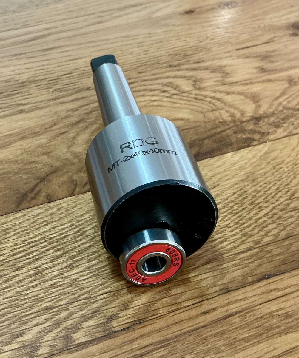

                    Ok, the arbor has arrived. The only one I could get big enough for a good price is this 40 x 40 from RDG. Thinking about the video I posted earlier. Would you remove some of the bulk or leave it as it is? Also, if you watch the video, it only has one bearing. I know some revolving centres use two, so is it worth adding another? I’ve got the bearings. Your thoughts please chaps.
                    IMG_5597
                    #818684
                    bernard towers
                      @bernardtowers37738
                      considering the load I would have thought 3 or 4 mm walls to be sufficient and the more bearings the better.
                      #818687
                      Vic
                        @vic
                        I suppose I could use it as is, and perhaps reduce the diameter at a later date if it becomes intrusive. I think I’ll fit two bearings whilst I’m boring it out.
                        Thanks for the input.

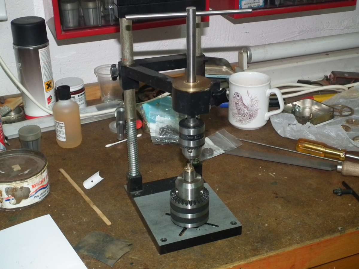

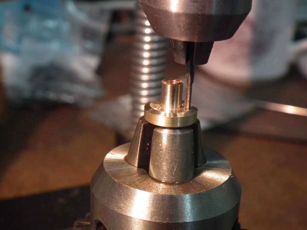

                          I bodged up a tapping stand from an old Dremel stand for tapping 10 BA in clock wheel collets:
                          Not a single broken tap.
                          Russell
                          DSCF1895
                          Tapping collet
