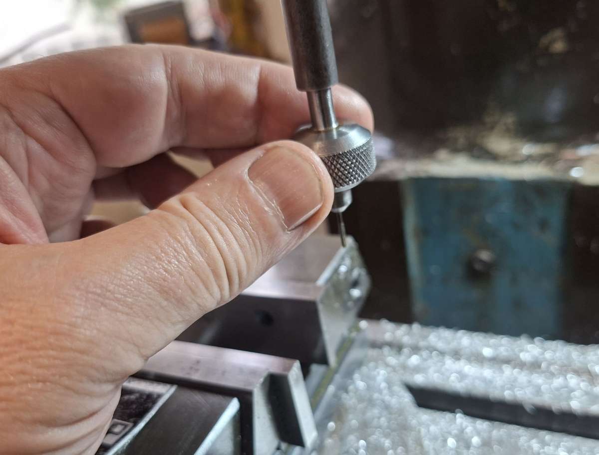

      I may need to drill and tap some small holes in some rod on the lathe, possibly down to M1.6. It’s notoriously easy, at least for me, to snap drills etc this small. Do any of you have any experience/suggestions for tooling to make this easier? Material will likely be brass or stainless. TIA.
      #818095
      Bill Phinn
        @billphinn90025
        Spot drill first. Then use stub length drills held in either a “sensitive drill chuck” or a Mason Master D-Speeder.
        Chamfer entrance of hole with a countersink.
        Blow out all swarf.
        Then tap with ideally spiral flute taps (again held in one of chucks mentioned) using plenty of lube. If the tap gets tight to turn at any point wind it out a bit (just like you would with a standard hand tap). Turn the tap gently with a slow smooth action throughout so you can stop in time at tight spots and avoid breakages. If tapping into a blind hole mark the tap shank so you know exactly how far you can afford to wind it in before it risks bottoming out and snapping.
        Make sure the tap is good and sharp, especially in the case of stainless.

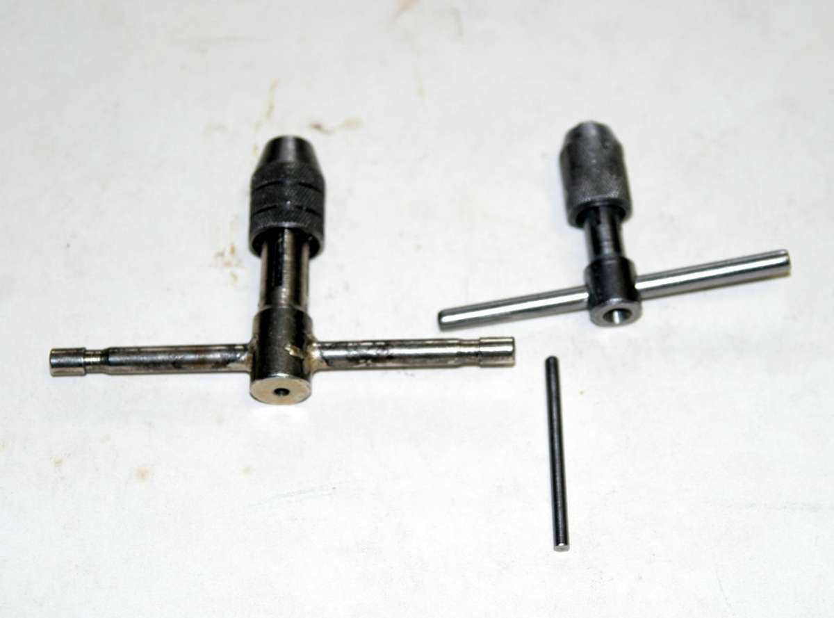

                          Vic
                          This is what I use when using small taps in the lathe (or the mill or drill press). I have two “T” handle tap wrenches that I have modified by drilling an 1/8″ inch hole down the centre so they can be held in alignment on an 1/8″ rod held in the chuck on the lathe, mill or drill. The picture is with a 1-72 UNC tap (1.85 mm) in the lathe. By supporting the tap wrench like this, all side thrust is eliminated and it allows a very fine feel of the rotation to sense any tightness telling you to stop and back the tap out to clear the flutes. I find backing out and clearing the flutes is beneficial even with spiral point or flute taps
                          JohnTap Wrenches

                              My method is like John’s except the tap-holder is supported by a home-made spring loaded pusher in the tailstock.  The spring provides the pressure rather than me, which helps because I’m clumsy.
                              #818231
                              John Purdy
                                @johnpurdy78347
                                The small one in my previous picture holds taps up to #10 (2BA, 4mm) the larger 1/4″ (6mm). Anything larger than that I tap free hand as it takes considerably more torque. The tap in the picture is 1-72 UNF not UNC, mental lapse.

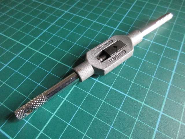

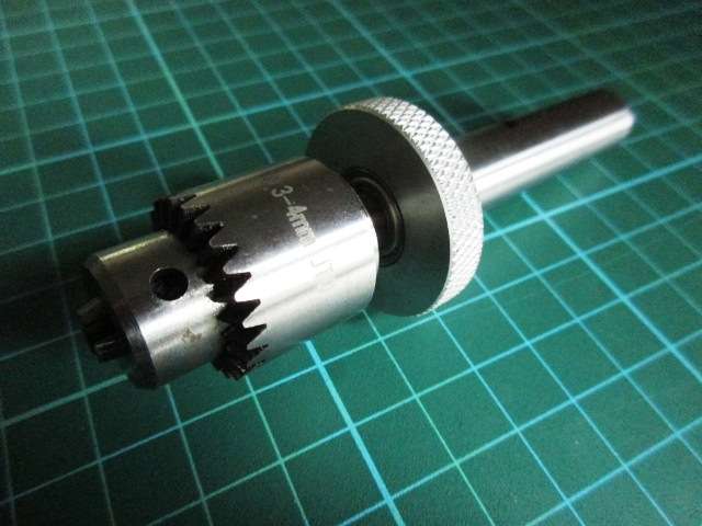

                                                Hi, when using small taps in the lathe, I use my micro drill adapter with a J0 chuck, ( the one MichaelG has referred too) to drill the tapping hole, and then just lightly deburr the edge with a larger drill, then I hold the tap in the chuck to get it established for a few threads, and then swap over to my No. 0 tap wrench.
                                                001
                                                002
                                                The No.0 tap wrench clears the bed of my mini lathe.
                                                Regards Nick.

                                                  I regularly drill & tap down to 1mm & I never use the lathe or the mill yes I start it in the lathe Pultra usually to get it straight but then do it by hand , I always use my spiral flute taps as they don’t bind although saying that I always turn a few theads then remove tap clean oil & go again

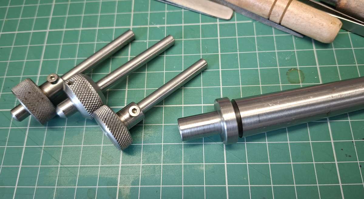

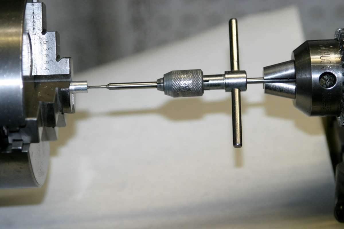

                                                  Chris Kaminski
                                                    @chriskaminski64716

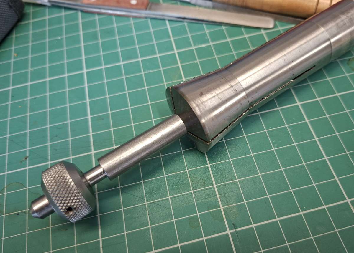

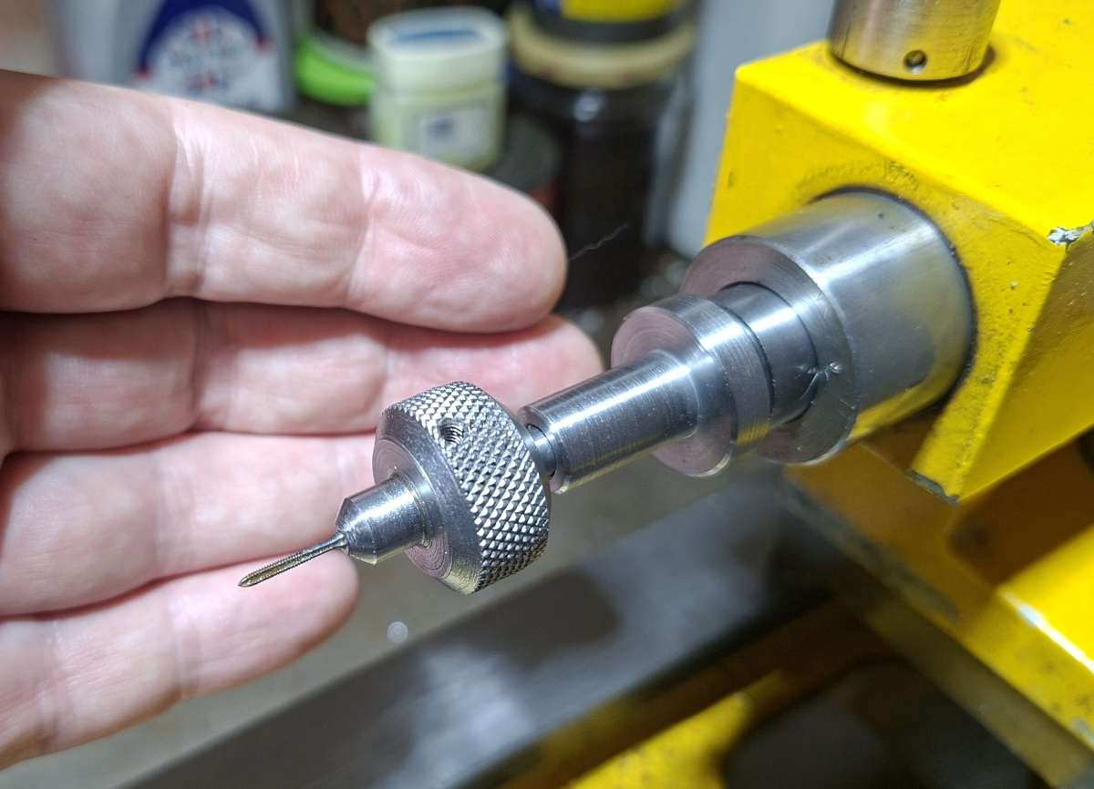

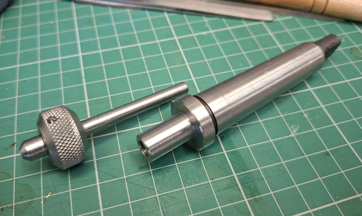

                                                    some photos from my workshop
                                                    tap holder, sliding fit in M2 tailstock holder:
                                                    01
                                                    using in my lathe:
                                                    02
                                                    selection of tap holders:
                                                    03
                                                    using in my mill with R8 adapter:
                                                    05
                                                    04
                                                    I have tried “micro drill adapter” and found it to be disappointing (maybe because it was cheap Chinese knock off copy).
