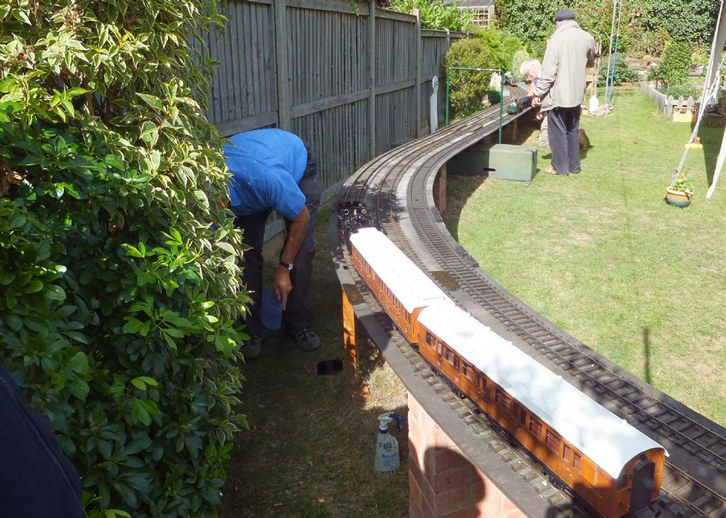

                              And should you decide not to torture test your new engine (by having it drag you around an MES track) then there are Gauge '3' Society members that have some very fine looking GNR/LNER teaks that would look particularly nice behind your engine at one of the G3 Garden Get-togethers (GTGs).
