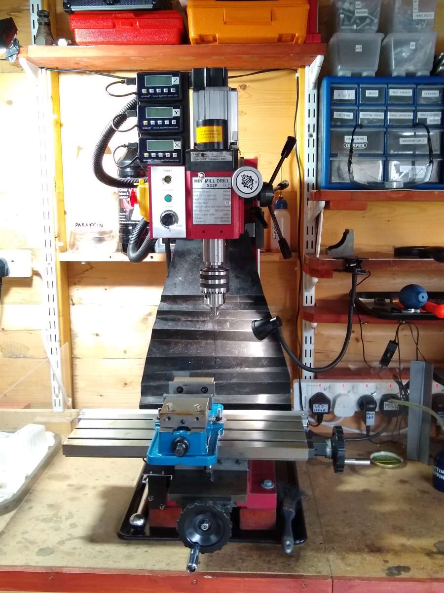

                          IMG_20240223_114934909
                          The studding, being made of wood, is probably soft enough to take out and high spots on the underside of the mill feet.
                          I use the mill for making Stuart and PM Research models, plus some odds and ends. So it has a reasonably gentle life.
                          Ches.

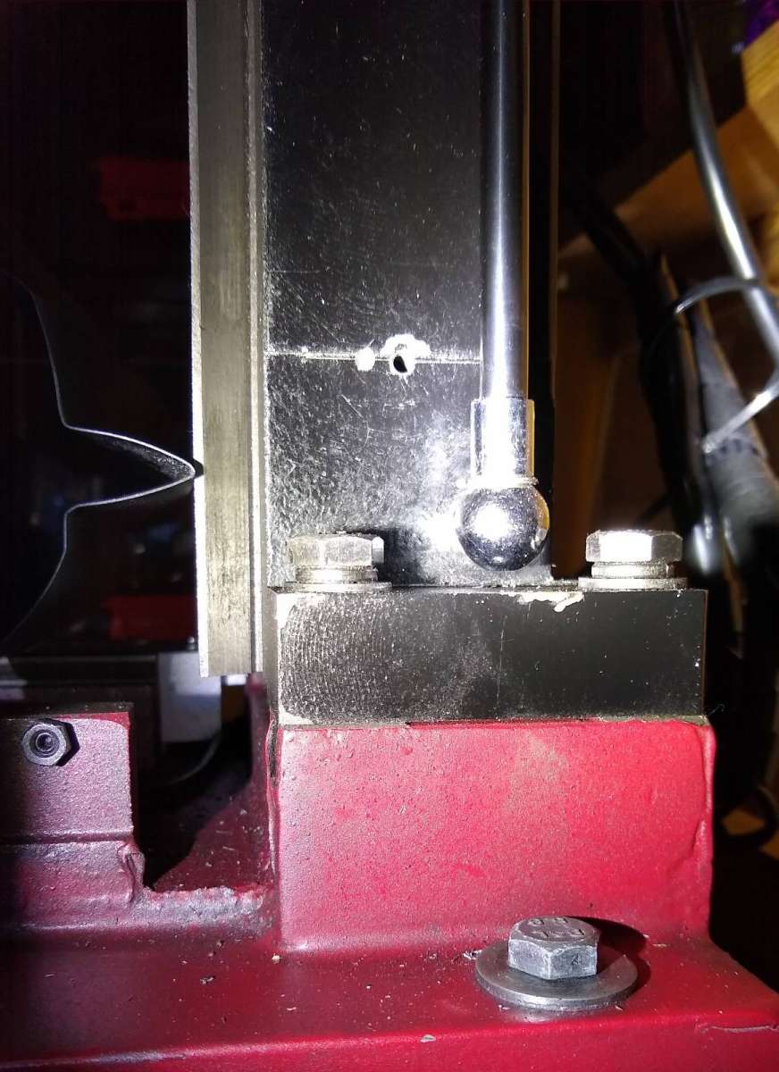

                              A couple of hours ago I put positioned a DTI on the mill bed with the DTI plunger near the top of the mill column. I then pulled the motor towards me with both hands to get a ‘flex reading’….I saw about 7 thou (…about 0.2mm) movement.
                              I kinda feel that is acceptable, although I’m not sure what the reading should really be.
                              All I know is that I have never suspected that column flex was an issue with any models I made. I tend to take only light cuts….maybe a max of 0.5mm deep on cast iron with a 20 mm dia mill, say.
                              I misunderstood you earlier on when you mentioned the 4x pads at the base of the column, I thought you were referring to the Base itself…my mistake.
                              I’ve just had a quick look at the pads on my mill column….the column bolts are done up snugly but the ‘pads’ seem to be made of a hardened metallic paste/filler or have a filler material surrounding them?  It is difficult to visually inspect the pads properly as the mill is tucked into a corner. I have never separated the column from the base so don’t have a clear idea of what the pads should look like.

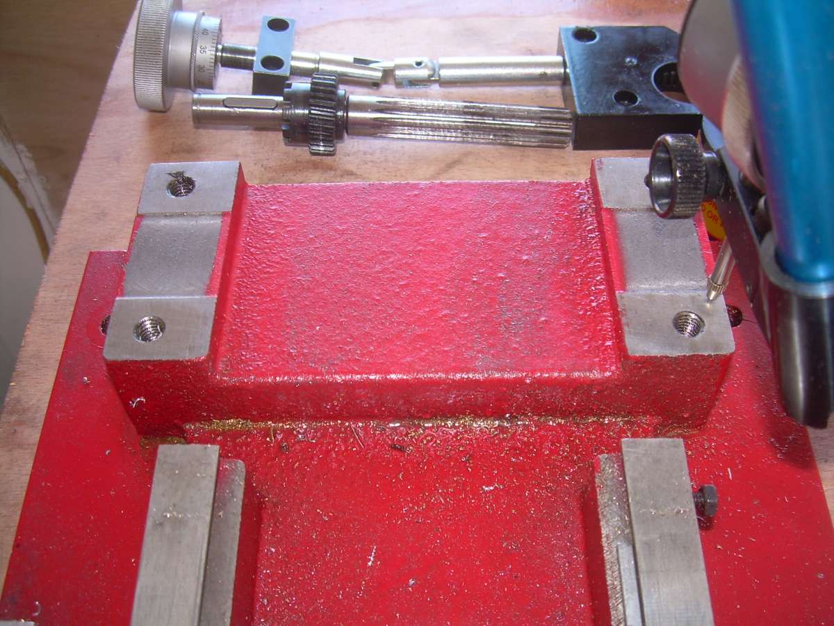

                                You have better readings in the flex than me. Total flex on my machine is 0.47mm (push and pull). I think I might get a few quotes from local machine shops to square up the mill column and base. I need the column feet skimmed perfectly square to the dovetail slides, and the base pads skimmed flat to match. I think I won’t be able to overcome these errors just with shims.
                                The four small pads (about 25mm x 25mm) on my machine are on the mill base. I have attached an image. Good luck with the Stuart engines. They are a pleasure to machine. All the best, Mark mill base

                                  For reference, here is a pic of the base of my column… what I thought was some kind of filler at the pads is probably just the bare cast iron shining through.
                                  column base 1
                                  All the best with the machining exercise.
                                  Ches
                                  PS: The empty tapped hole on the column is where I used to have the Z axis DRO, but it interfered with the gas strut, so was shifted to a different position on the opposite side.

                                            On my Sieg SX2, there is a slight rock between the column feet and the four small matching pads on the base. The column doesn’t sit positively on the base, which is causing flex – fore and aft, and issues tramming the mill in the x-axis. I did manage to reduce the x-axis errors to about 2 thou on a roughly 12″ dti total sweep but I cannot solve the flex as the error would require quite thick shim(s) and this would then undo the tramming along the x-axis.
                                            Ches – I think the ‘filler’ you see is actually the small metal pads on the base. They are roughly 25mm x 25mm square. The pads are clearly visible in my picture just above your last post.
                                            Anyway, thank you all for your good suggestions. I might head off to a machine shop and get the column feet skimmed at right angles to the flats of the dovetails, and the base pads skimmed parallel to the y-axis rails/ways.
