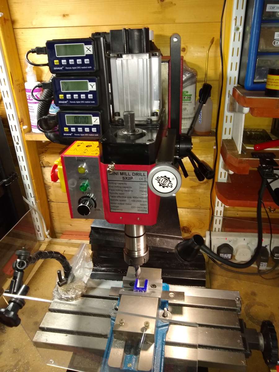

      Below – The mill itself. 4 yrs old, been problem free. Stays in a wooden shed so subject to some condensation during wintertime.
      0 Seig SX2P mill

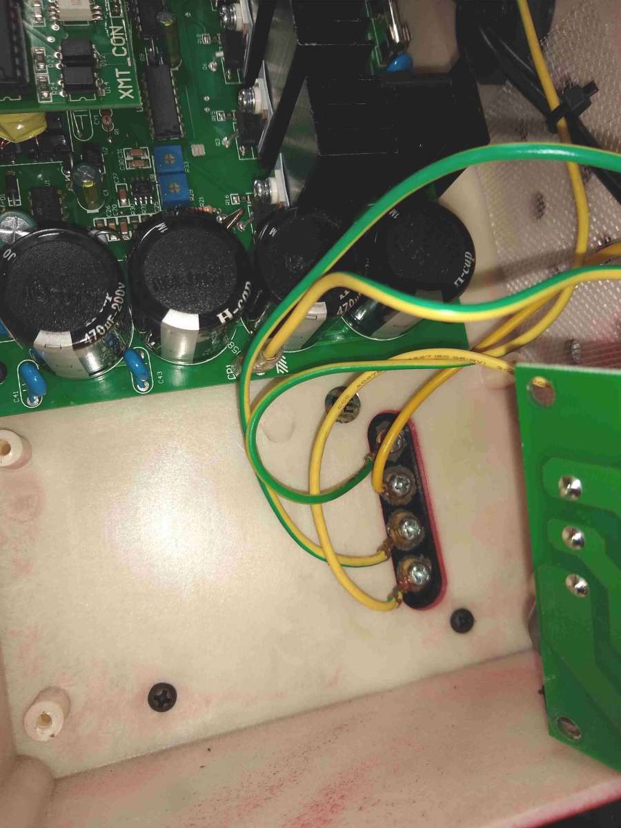

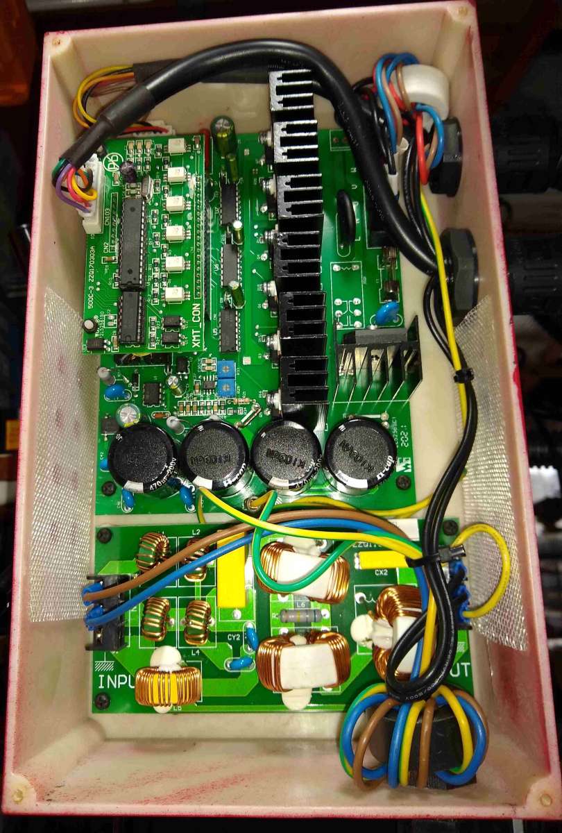

      Below – The electrics box with circuit board. No burning visible. Capacitors looked OK eg no swelling etc.

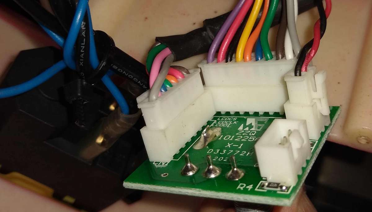

      Below-  4 ‘hidden’ connections underneath the small filter board.

            Noel’s suggestion is likely, and you should act on his advice.  The pots used are the domestic variety, unsealed and liable to pick up dirt, damp etc.  The wiper arm loses contact due to vibration and temperature.  Track damage tends to wear concentrate at popular settings, so the pot behaves across most of the range, but it’s sick.
            Worth giving the pot’s innards a squirt of switch cleaner – I use Servisol.   Also good when reseating contacts as suggested by Arc.  It dislodges dirt and grease, and lubricates.
            Although domestic potentiometers aren’t ideal in a workshop, they are cheap and easy to replace.   I wouldn’t recommend an industrial grade sealed component – expensive, e.g. Vishay 4k7 at £74.71 from Mouser, which may not include VAT or p&p!

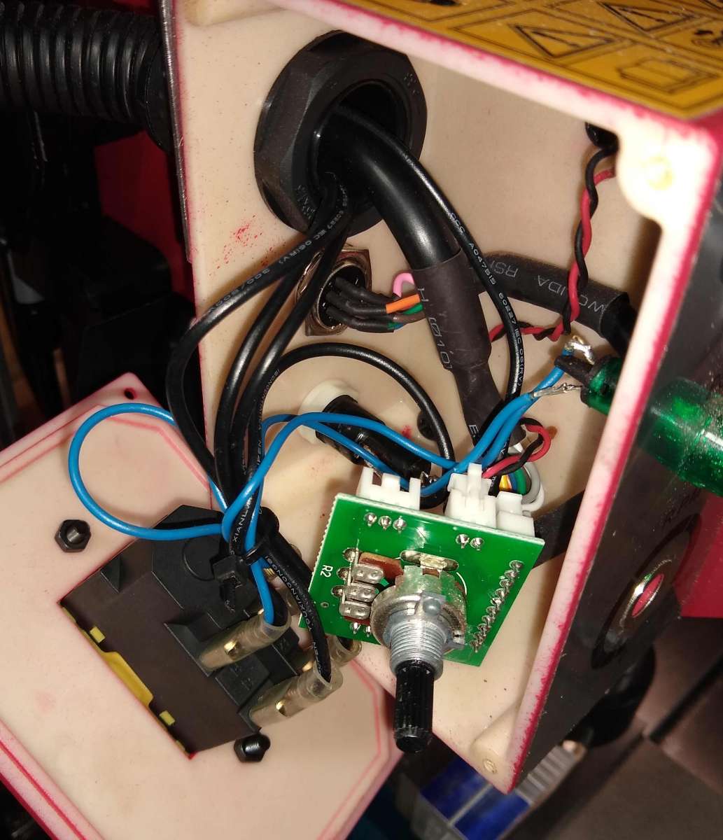

                        I’ve now opened up the Switch Box on the SX2P mill to get access to the Potentiometer.
                        See below. The wiring was a bit tight inside but just enough slack to get the Pot out and also disconnect the white connectors. I noticed one of the spade terminal connections on the main On/Off switch could easily slide up and down about 1mm+, so I gently crimped the female part- that made the fit tight.

                        One connector isn’t used…I guess that is for the speed readout accessory.
                        5 switch box

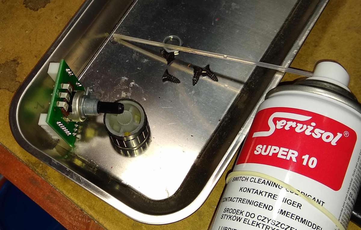

                        Below. The pot has an opening on the underside that allowed the cleaner spray access to the insides. Before using the spay I noted that the spindle was quite stiff to turn – has the grease hardened up? Anyway, after spraying (and removing the grease?) the spindle rotation was almost frictionless. I did check on the web to see if I needed to somehow replace the grease but apparently Servisol is non-acidic and does leave a thin protective lubrication layer.
                        8 switch box
                        I let the parts dry out for about an hour before reassembly into the box. Now I can get back to milling.

                                    Hmm, might be a speed control board fault. Have a look at all the electrolytic capacitors for signs of leaking or buldging. It’s mostly the small ones that fail not the four larg black ones. It might just be the light but the top of the green one at the top of the board looks a bit buldged.

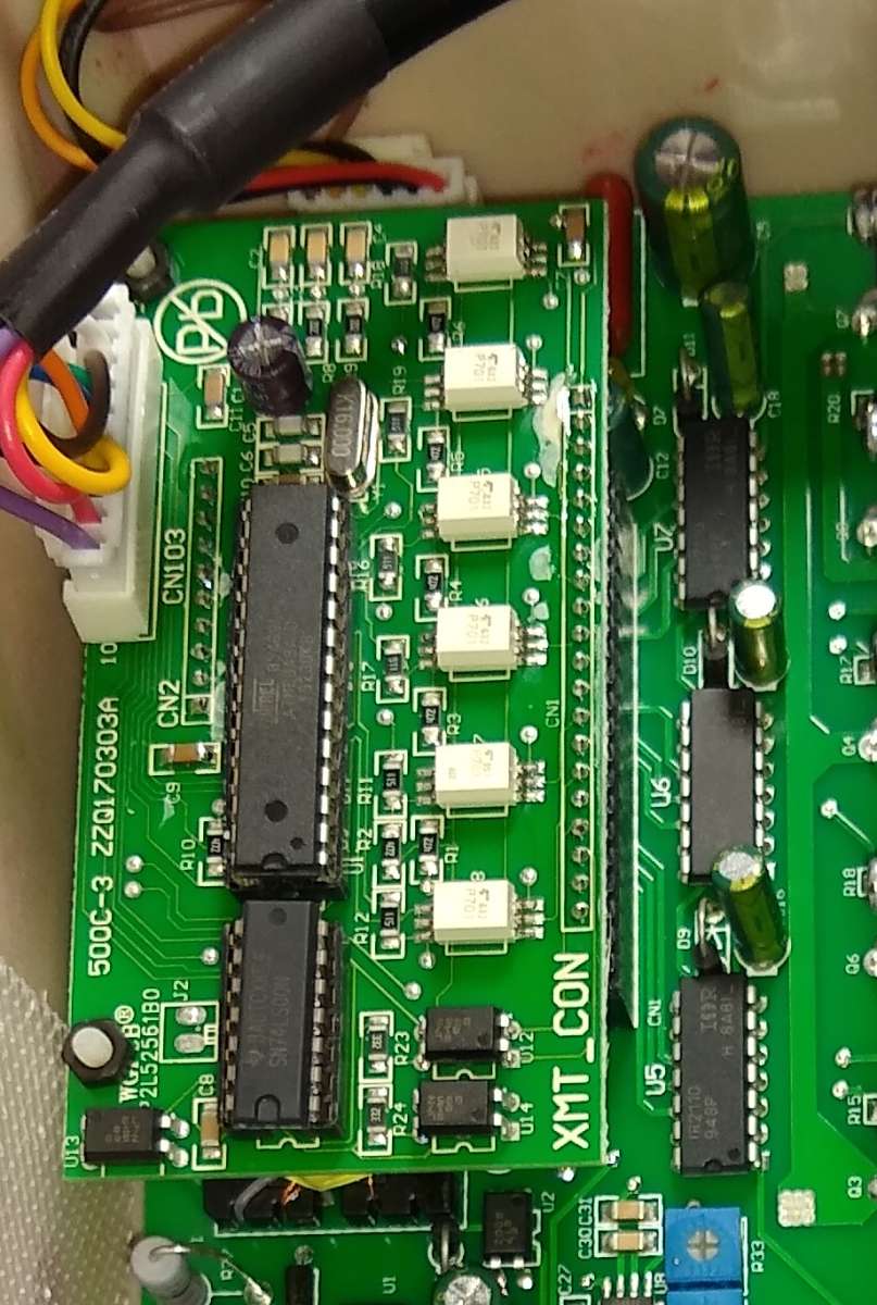

                                    Ches Green UK
                                      @chesgreenuk
                                      Robert,
                                      Below, a crop of the area I think you refer to. That cap is slightly out of focus but kinda looks OK?
                                      crop 1
                                      As I mentioned earlier, I have ordered a new potentiometer. If that doesn’t work then I’ll dig in to the control box again…a replacement board isn’t cheap, but if I can identify a bad capacitor I can fairly easily replace that myself.
                                      After today’s fault I then milled about 60 cuts x 50 mm long x 0.1mm deep with a 1/16″ cutter without further any issues – the mill performed well.
                                      It’s a strange intermittent fault …. I don’t know if a capacitor would cause that, but don’t really have the experience to be sure.
                                      Ches

                                        I think I can see another electrolytic capacitor lurking under the top board, is it the only one? Check for any hidden ones, the tops tend to start to bulge before they fail.

                                          #821206
                                          old mart
                                            @oldmart
                                            The long black chips may be in sockets and the top board may also plug into the lower one, at CN1 and CN2, perhaps.
                                            #821218
                                            Robert Atkinson 2
                                              @robertatkinson2
                                              The capacitor at the top does look distorted. even with the focus. Compare it to the one at the bottom of the picture.
                                              A way to rule out the pot is to replace it with a pair of fixed resistors two 2.7k will set half speed. You could as set it mid way and put a pair of 10k resistors across it one from each end to the wiper.
                                              If it’snot the pot or a capacitor it’s likely the self protection circuit is cutting in when it shouldn’t
                                              Robert.
