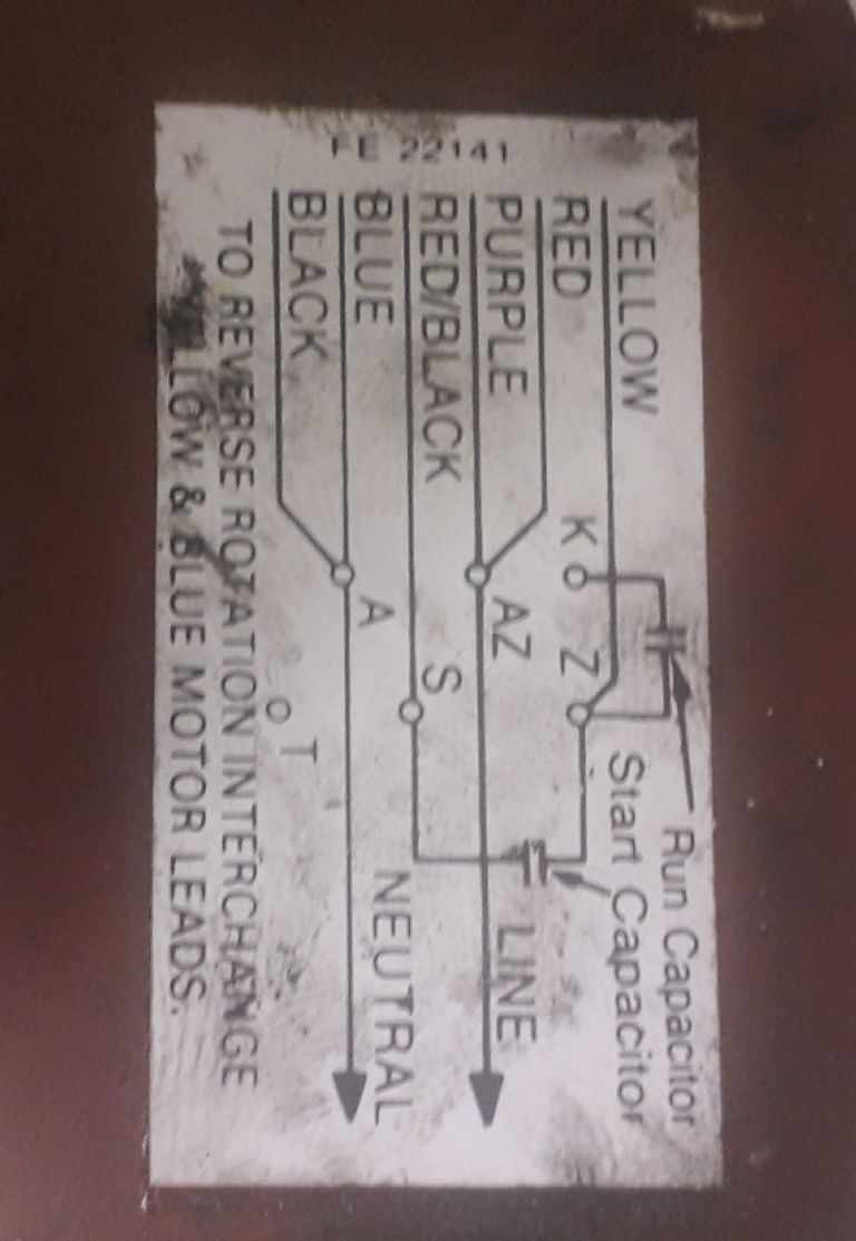

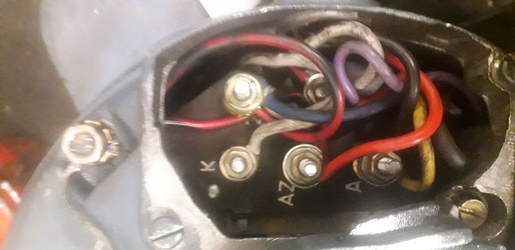

      I have been searing the net for a few hours per night trying to find information on an AER single phase 750w 1425rpm motor, cap start cap run on my lathe and want to fit a forward reverse switch, the switch didn't come with great instructions and I can not find any info about the AER motor, so I wondered if someone here had any knowledge of motor reversing and switches.
      Under the motor cover the wires are K, AZ, A, Z, S. The cover says to swop Yellow and Blue to reverse the motor but that just pops the trip.
      Any help would be much appreciated. I can post more details, what ever is required.

                Emgee
                  @emgee
                  Keith
                  The yellow and blue wires referred to are the start winding ends coming from inside the motor, not the blue neutral from the power supply.

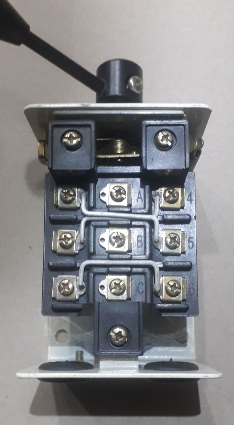

                                            #524906
                                            Keith Jenkins 1
                                              @keithjenkins1
                                              plate.jpgswitch.jpgGot there in the end…
                                              #524907
                                              Keith Jenkins 1
                                                @keithjenkins1
                                                The 2 you can not see are Z(top left) S is to the right of Z
                                                #524911
                                                Keith Jenkins 1
                                                  @keithjenkins1
                                                  Z S
                                                  K AZ A

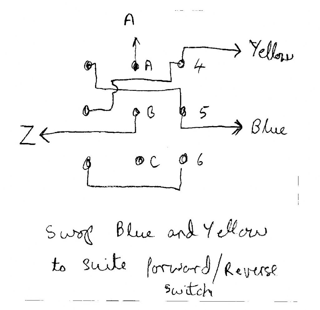

                                                  Nicholas Farr
                                                    @nicholasfarr14254
                                                    Hi Keith, assuming that A, B, and C on your forward/reverse switch are the common connections, I believe the schematic below should work, but you will need to disconnect both the yellow and blue wires from the posts and bring connections A, Z, yellow and blue out to your forward/reverse switch, you may need to swop yellow and blue to suite the switch.
                                                    Regards Nick.

                                                    Keith Jenkins 1
                                                      @keithjenkins1
                                                      Thank you Nick I will try that, but I had swapped blue and yellow in the motor and popped the trip. I will let you know how it goes
