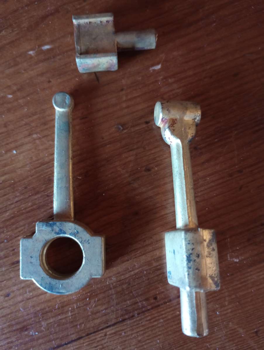

                            #864856
                            Mick Bailey
                              @mickbailey28509
                              If anyone needs some parts I have these that came with a box of lathe tools 35 years ago. They look like 10v.
