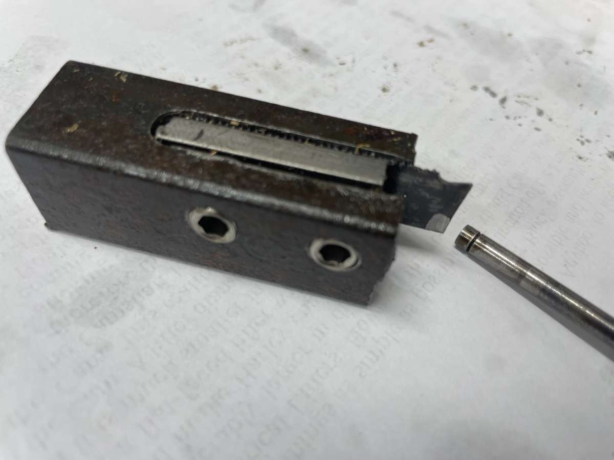

            I quite often use broken hacksaw blades as either grooving tools or narrow parting off tools. Some hold their edge quite well others not so. A simple rough holder can be knocked up on a few minutes, one day I’ll make a more photogenic one. Pictured also is a 5/32 silver steel valve stem with a  25 thou e clip grove. IMG_0208

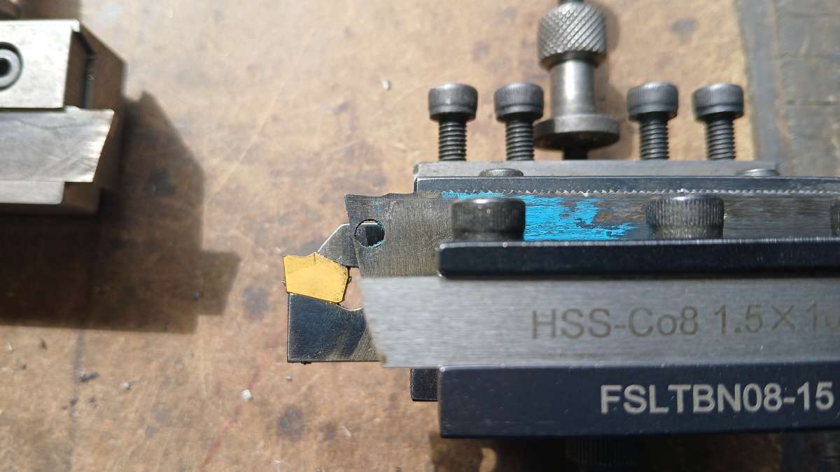

                    Could a bi-metal be used if you placed the cutting tip where the wavey “set” of the blade is central and you flatted off any of that set behind the tip. Does not matter if what is backing up the blade is soft as it is not doing the cutting.
                    #862171
                      Yep, just as I thought, no need for all hard as it is just the cutting edge you will be using not what is backing it up. 12mm steel, 500rpm. Front mounted QCTP with plenty of overhang. That is also the blade I used when everyone was saying you can’t use a standard drill to put holes in hacksaw blades.

                              Well I suppose if you have a need for a lot of top rake you might cut into the backing but again the actual cutting tip should still have some HSS on it. Or just grind the blade with a flat top and hold it at whatever angle you need to get the desired top rake.
                              I managed to get a few degrees top rake on the one shown in the video and can just see the weld line is intact. It was just done freehand on a linisher, no doubt those that have spent half their life making and finishing a quorn or similar could do better. It actually have more top rake than the HSS blade who’s holder I used and about the same as an insert all of which have no prroblem grroving and parting ferrous an dnon ferrous metals.

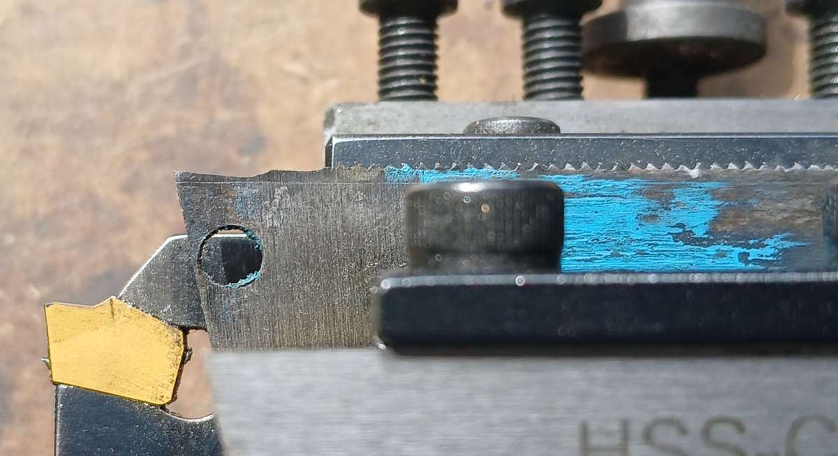

                              #862186
                                Close up showing the weld line
                                weld line

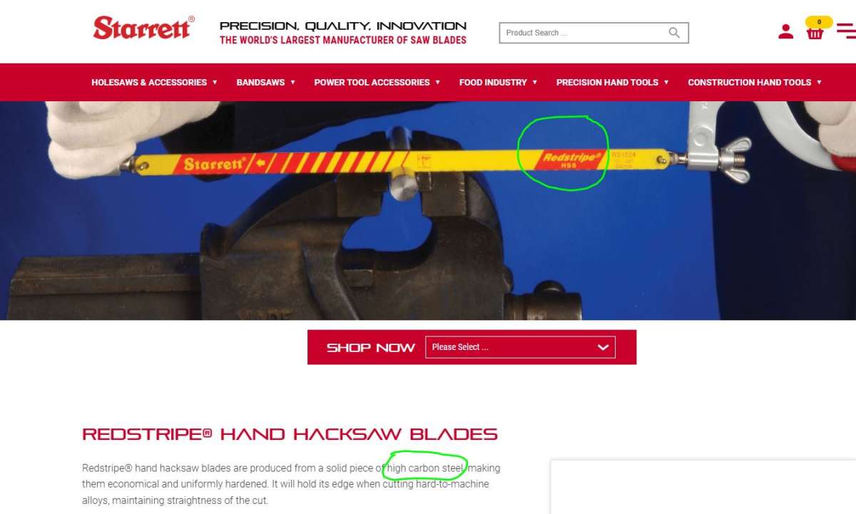

                                    #862222
                                      here’s one to keep Michael amused this evening. 😊😊😊
                                      redstripe
                                      #862242
                                        Neither designation would mean much without great elaboration !
                                        … I just know them as being very good “all hard” blades
