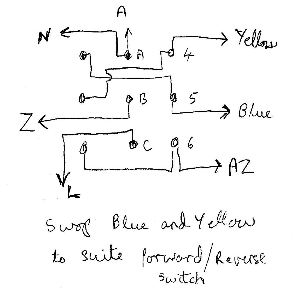

        Hi Keith, I do agree with Les though, you ought to check out the motor as he has said, or get it checked, before you go to the trouble of wiring the forward/reverse switch, otherwise you'll not know why if it's still tripping.
        I have also updated the schematic which should also work and you should be able to use a single 6 core flex from your switch to the motor, one of the 6 cores would be an earth, but failing that you would need at least a 5 core flex, or you could use a flexible conduit and use single wires.
        Regards Nick.

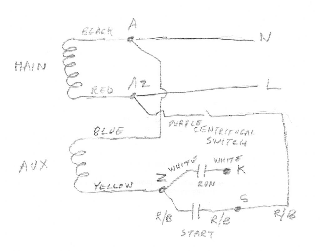

            I am assuming the wire that you call grey is the one marked black on the diagram. (And was connected to terminal A) Am I correct ?
            Above is the way I think it is connected. but it looks like the marking for the start an run capacitors are the wrong way round. Can you follow the wires from the terminals to the capacitors and read the values of the capacitors so we know the values tied to the start and run capacitors as marked on the diagram from the motor.
            With the 6 wires not connected to any of the terminals can you test for continuity between each of the 6 wires and all of the terminals. This is to see if there is any connections that are not visible. I suspect there is a connection that we don't know about as from the diagram I have traced out above swapping the blue and yellow wires is the correct way to reverse the motor and should not trip the breaker, I think the centrifugal switch is connected between terminals K and S. I would like to confirm this.There are a few ways to do this.1! dismantle the motor and follow the wires. 2 Spin the motor using an electric drill or other means to about 1500 RPM and check that there is no longer continuity between K and S, 3 With all the wires connect as originally connect your meter set to AC volts between S and K and apply power. There should be a short pause after applying power when there is no reading but once the motor is up to speed there should be some reading. This will probably be less than 240 volts.
            4 Repeat the above but with the meter connected to K and Z. The meter should briefly read a voltage and drop to zero when the motor is up to speed.
            Les.

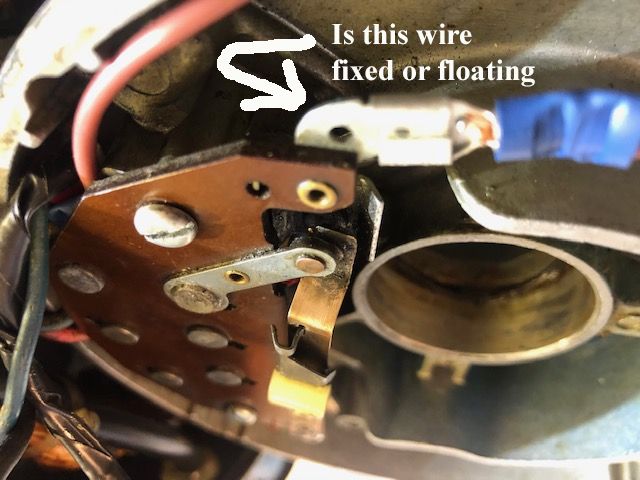

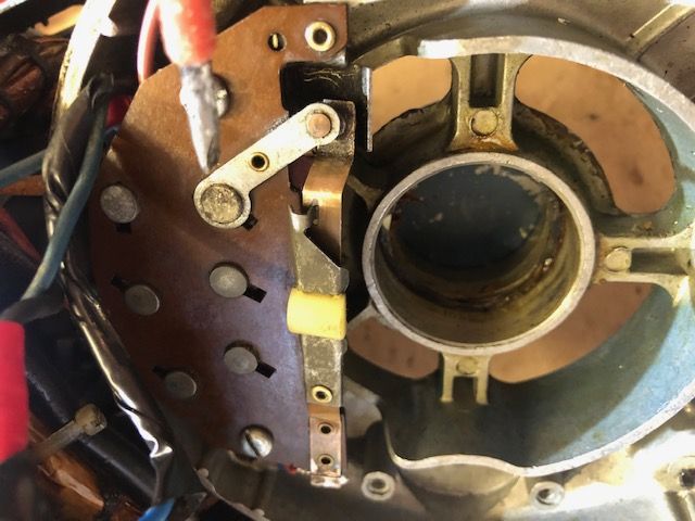

                          I also had never seen a change over switch until Nick clarkes. The centrifugal switch had a wire crimped to the moving contact terminal, the normally closed cotact had a male spade and the normally open contact is K. Noel

                            Terminal wire colours as they were originally, no swapping as follows:
                            K – White
                            AZ – Purple, Red, Red(Mains supply)
                            A – Yellow, Black, Black(Neutral mains supply)
                            Z – Blue, white, Red with black stripe
                            S – Red with black stripe, Red with black stripe

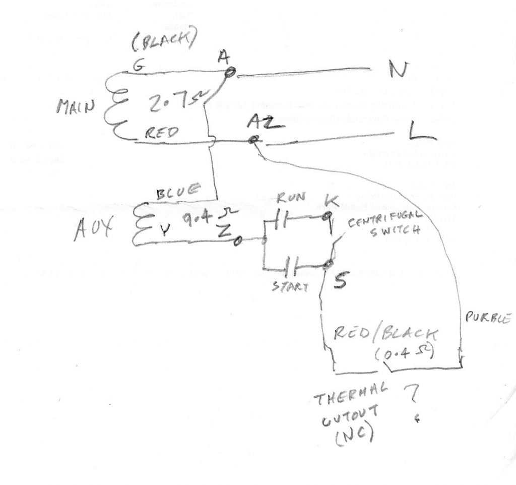

                              I have no solid conclusions but here are some comments.
                              As a result of some further tests after I posted what I thought was the way it was wired at 9:27 on the 6th my diagram is wrong. The centrifugal switch is NOT connected between K and S which I had assumed as a result of the zero ohms reading in the post at 23:12 on the 5th and the fact that it would seem to connect the start and run capacitors in parallel. The post at 16:12 on the 6th now shows no continuity between K and S and Keith has since proved that what I thought MIGHT be a thermal cut out (Even though it not in the right place to remove the supply to both windings.) is in fact the centrifugal switch. I seems that there is nothing connected to K other than one wire from the run capacitor. When the motor ran with the original way the auxiliary winding (Yellow and blue wires) was connected I think it was just running as a capacitor start motor as one side or the run capacitor does not seem to be connected to anything. The only explanation I can see for swapping yellow and blue over is that one of them is shorting to (Or flashing over to.) earth. This is what Emgee suspected in his post at 18:37 on the 4th.
                              Keith, Can you check the insulation between the auxiliary winding (Yellow and blue wires) using an insulation tester / megger and earth. (It would be a good idea to test the insulation between the rest of the wiring and earth at the same time.)
                              Keith, Was the picture of the connection box taken before or after you swapped the blue and yellow wires over ?
                              I would be interested to here comments from Emgee and/or John Fletcher as they may have spotted something I have missed.
                              Les.

                              Les Jones 1
                                @lesjones1
                                This is my revised diagram.
                                070221.jpgLes.

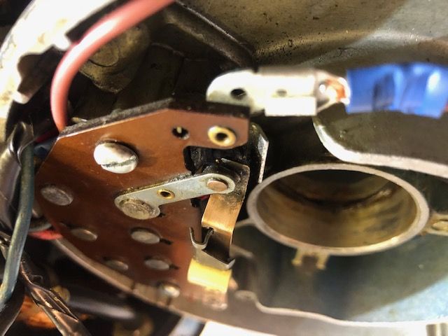

                                              The first photo shows the moving contact and the K contact , metal link. The rivet and spade connector are the N/C contact that goes to S. The lower pic shows rather better the moving contact that had the purple wire crimped that goes to AZ. The position of the moving contact is in the running position ie purple switched to K the run capacitor. When assembled the moving contact will be pushed back to the N/C position, only when near running speed will the bob weights fly out and allow the ring to move away from the NDE and the switch change over from S to K. Noel.
                                              Edited By noel shelley on 07/02/2021 15:06:08
