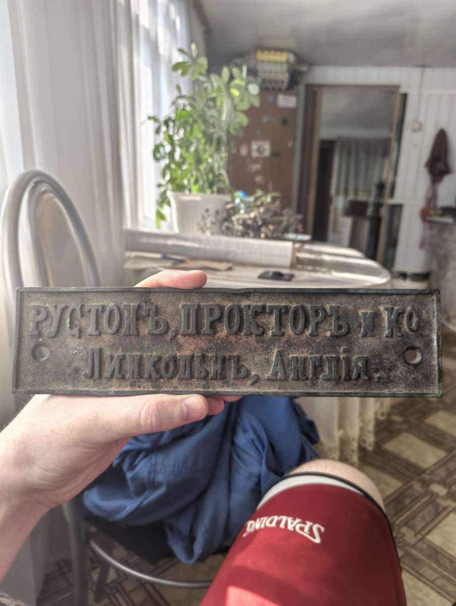

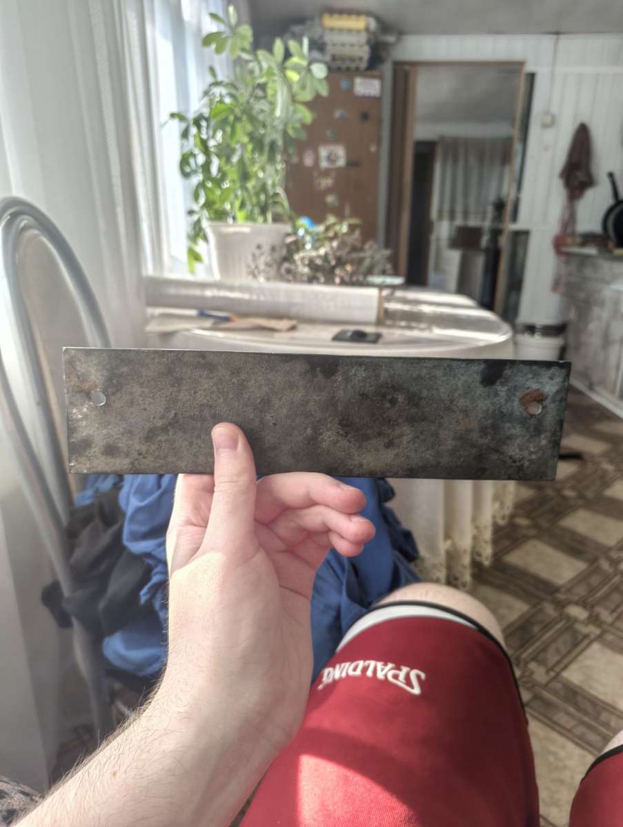

      The company plaque of the mobile steam locomotive Ruston, Proctor & Co., Lincoln, manufactured for the Russian market, approximately 1890–1917. The exact model and power are not established.
      Maybe they can help me determine exactly what this label is from, since I haven’t found any precise information in my region.
      The forums say it’s from a locomobile. But I couldn’t find a specific model or examples of where it’s used. And the fact that the plate is in Russian (Russian Empire) for an export model only made my search more difficult.
      1000001255100000125210000012531000001254
      Надпись на дореволюционном русском языке:
      «РУСТОНЪ, ПРОКТОРЪ И КО ЛИНКОЛЬНЪ, АНГЛІЯ.»
      Ruston,     Proctor   and CO   LINCOLN,    ENGLAND
