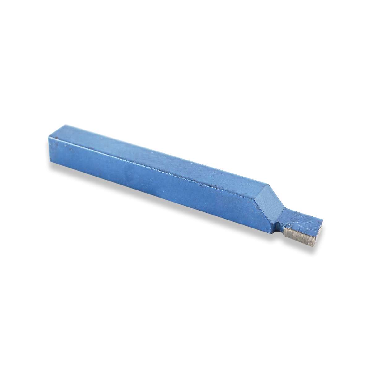

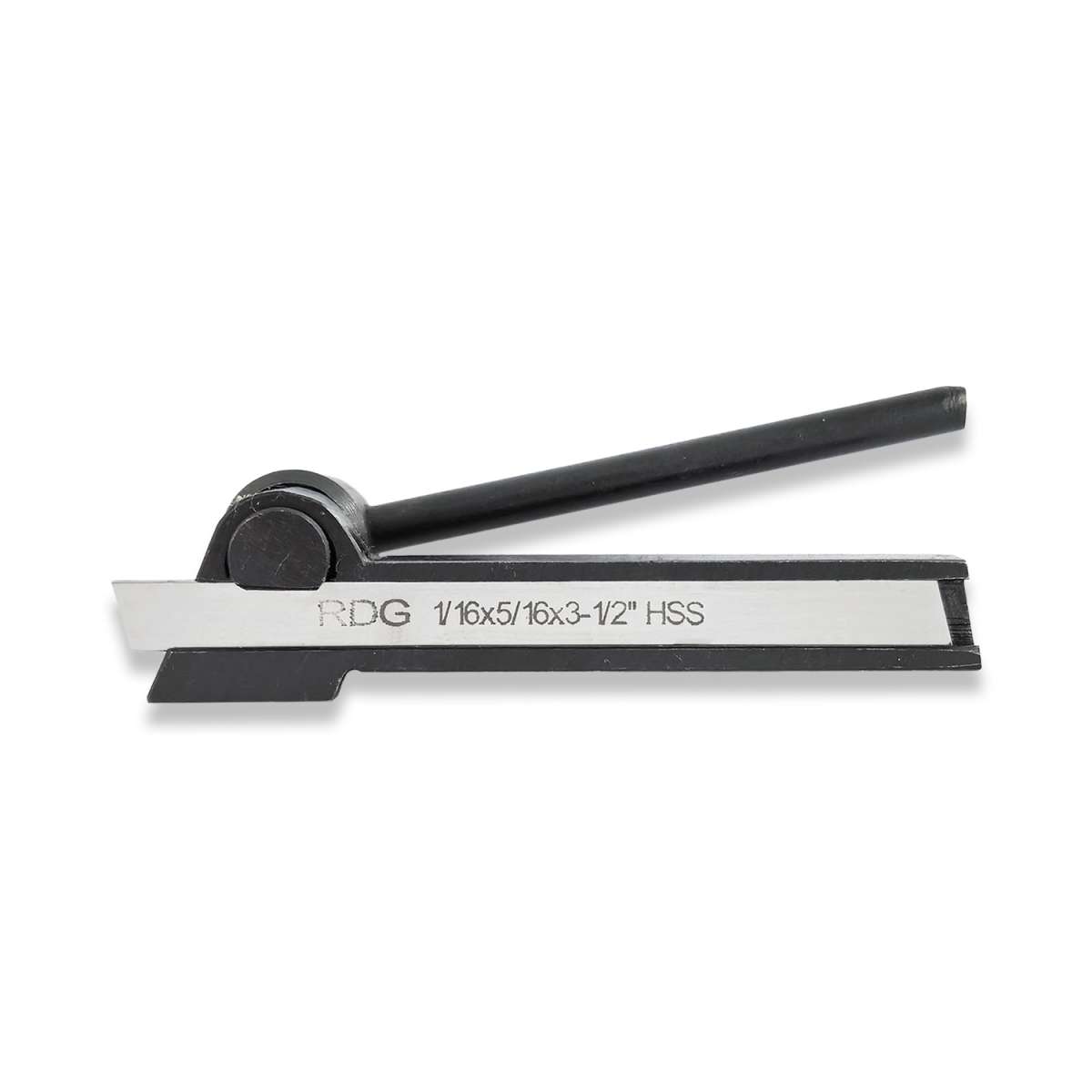

      I fully appreciate that parting off the piece would have prevented this issue entirely. This brings me to my first question: What parting tool should I buy?
      My lathe has the original Myford quick-clamp lever system (with the spring-loaded black block).
      AI  suggested a blade-style holder PARTING-SYSTEMS-FOR-SMALL-LATHESHowever, I also saw this traditional-style tool on the Myford website 10mm-Brazed-Tip-Parting-Tool-2I am not sure how the blade style works with my specific tool post, whereas the second one looks like my standard tools (though the blade doesn’t look very deep).
      Which style would you recommend for my setup?

        Of the two parting off tools that you show, the one with replaceable blades is best. However you will need to make an adapter to hold it in the traditional Myford tool holder. Unless anyone else has a smarter idea.

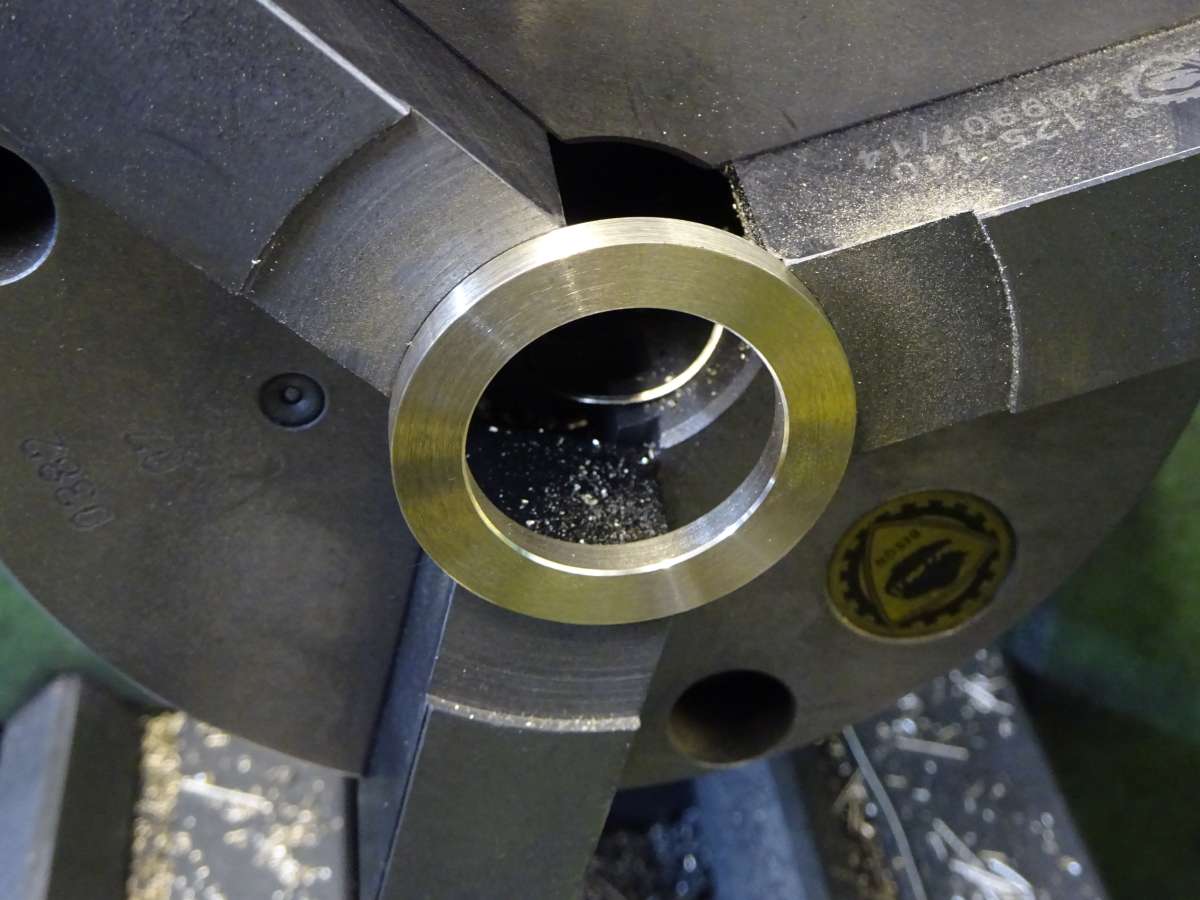

          To save us repeating a lot of things have a look at this post from earlier in the week
          Parting off
          regarding facing thin parts, a set of soft jaws are the ideal thing for this. You machine a shallow recess in the jaws the same diameter as your part and the back of the cut gives you something to push the good true face against.
          DSC02558

              As for parting tools, I like the carbide insert type with the “U” shaped grooved tips. Get the thinest one you can. 1-2mm ideally.

                  The HSS blade will probably last far longer than a brazed carbide tip (I seem to be able to chip them rematkably quickly.
                  In contrast to the HSS tapered blade that i was given when buying a “pre loved” ML7 some 40 years ago, used on its successor, and still not worn out.

                                Some people confuse brazed finishing tools with parting tools which should be no more than about 2mm wide at the tip. Any tool wider than this is likely to be a finishing tool, intended to ‘rub’ the ‘thread’ off a longitudinally turned piece. A bit like setting a knife tool askew to rub to produce a finer finish. I seem to recall GHT or Sparey  had something to say about this.

                                      For a beginner, the RDG blade and holder is much superior, and easy to keep sharp and on centre height. There are lots of printed plastic spacers to fit in chuck jaws on the market, you do need to find out if there are any to suit your chuck. Soft jaws are very good for holding difficult work and even when worn down can be drilled and tapped to hold new home made tops. With your chuck you would need to know the exact dimensions of the jaws including the “actual” pitch of the teeth before chancing buying soft jaws.
