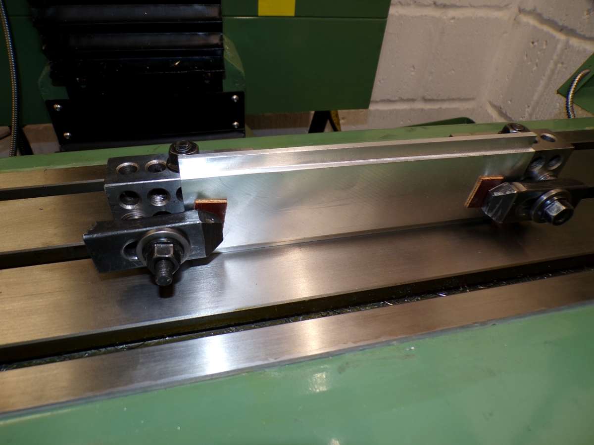

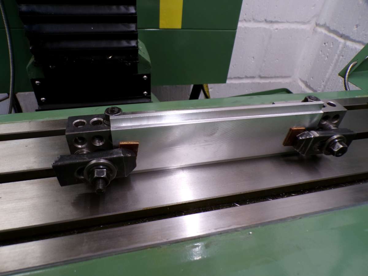

      I’m building a model which I hope will appear in the magazine at some point, therefore I’m taking photos of set ups, assembly etc as I go. My photos aren’t coming out great, they’re clear enough but have annoying shadows, flash reflections etc.
      I’m not a photographer, and have no real interest in it beyond this particular use. I’ve tried with and without flash, and got it set to close up photography. One problem I have had is the flash being shadowed by the lens, I’ve seen flashes/lights that mount on the end so will get one of those. Camera is a Kodak AZ425.
      Has this topic been covered in the magazine before?
      This was taken with the flash, giving a washed out too bright bit at the left and leaving the right in shadow:

      This is the same shot with no flash, less dark to the left but still too bright to the right and looking a bit washed out

        I never use flash, look through my builds and you will see no reflections. Last few years have just been taken with the phone, get in close and don’t use a digital zoom. Editor Neil likes my photos as did the publisher of my book.
        Typical thread https://www.model-engineer.co.uk/forums/topic/v-twin-kelsey/
        Your white wall may not be helping as the camera will be adjusting for that bright area which makes the subject darker.

          I don’t have a smartphone, so can’t use that. Some photos are OK without flash but some come out quite grainy and/or dark.

            Suggestions: Don’t use flash. Use a tripod, aperture mode, and stop down as far as this camera will go, about f/7 or 8, (I use f/22 on my Sony) to maximise the depth of field. Set to 100ASA. Use the self timer to avoid jogging the camera when releasing the shutter. Set the focus about 1/3 of the way into the desired depth. Don’t use more zoom than necessary. Light from the side or behind the camera to minimise glare – no backlight.

              Flash is very difficult to use and best avoided. Better would be to get a tripod and use a slow shutter speed with a low ASA value. If you don’t have a cable release use the portrait/selfie timer on the camera. Sooner or later, if you are going to publish the results, you will need to edit the pictures. Forget about fancy editing programs such as Affinity and Facebook, ordinary .jpg viewer on Windows Office or Microsoft has a good, simple, very easy to use editor.
              Remember you have all the time in the world to take many photographs. The more obvious is remove the swarf and take the key out of the chuck.

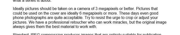

                  #862274
                    If you have not done so already run the details past Neil and also get him to send you an author pack wich has guidance about photos, text etc
                    Bit about editing taken from the guidelines
                    picks

                      Hi Pippin, having it on your shiny milling table doesn’t help, and a somewhat mixed and a little cluttered light and dark background won’t help either. Try to get a background that is the same shade all over, with a matt white or suitable  pascal colour that doesn’t clash with your item, have some good lighting that is even over the whole area, flash is not very good with close-ups, but one way is to defuse it, by covering it with a white piece of fabric, or a few layers of white tissue paper. It would also help if you used a tripod, and used the shutter’s self timer when taking your photos, then you could try directing some light in the right place, with a piece of matt white card or a board. And yes do as JasonB has said about the size of the photos, and don’t crop them, or edit them in anyway.

                                  You are getting a bright streak from some light or other. I would switch that off for a start. If you need to light the scene then use a light bounced off the ceiling or an adjacent wall.

                                      As has been mentioned, try to get bright, even lighting across the subject and avoid high contrast backgrounds eg a white wall behind the darker mill table.  Flash can be good but can also make certain scenes look worse.
                                      Maybe also, if possible try to capture only the area of interest ie get closer in if focusing allows.
