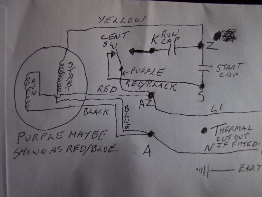

      Hi All,
      My final check before I was about to put the motor wires back as I found them revealed the blue wire having a shaving of insulation missing, which must have just touched the motor frame when it was moved onto the other terminal. It looked like a knife slice with only a small amount of wire showing, it was revealed because I pulled some of the slack through from behind the board to have a look for cracked insulation as so many of you knowledgeable people mentioned and I thank you all for your input that solved the problem.
      So now the wire has been sleeved, I can swop Yellow and Blue to change rotation and it runs fine. All that's needed now is to wire the forward/reverse switch.

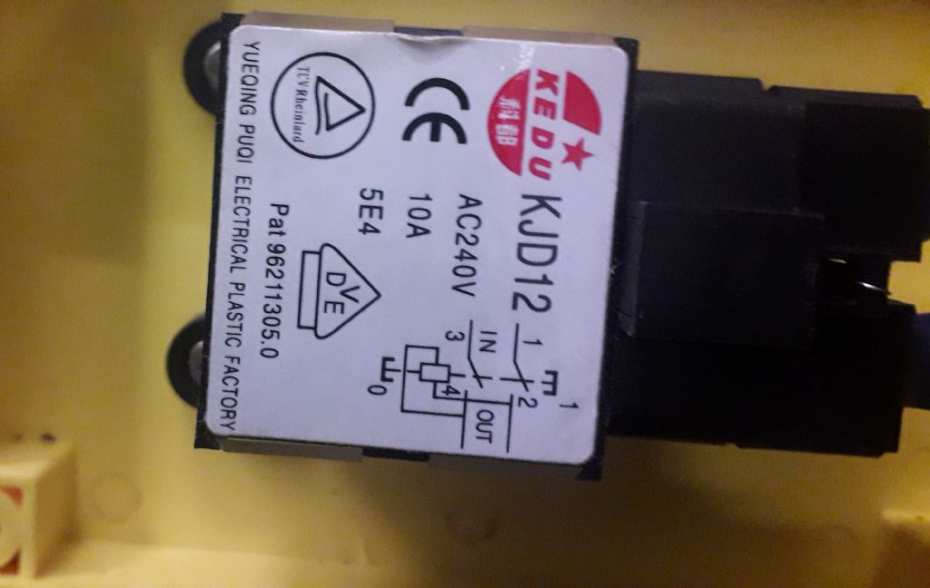

          Hi Les, would the diagram that Nicholas Farr on 05/02/2021 11:02:23 be the correct wiring? I bought the switch new quite a while ago and don't have the diagram. I have an NVR switch on the lathe already so I could use that.

            Hi Keith, your NVR switch should work with the schematic that I've shown, just connect to the connection marked L, but Les's suggestion of a contactor and stop/start buttons would be a better idea. Something like NVR switch if you don't have this type already. (this type is also available from other suppliers)

              Gentlemen, To those who say they have never come across a change over switch in a start circuit I would respectfully direct you to Tubal Cains The Model Engineers Handbook, Electrical memoranda, where it is shown as a cap start, cap run(special ).
              To simply reverse the motor changing blue and yellow is correct. To make the motor reversable one needs to bring out blue and purple as the start windings which must be swapped to reverse and red and black as the run windings which DO NOT need to be swapped. Terminals A and AZ are now redundant ! As a means of reversing the start windings the switch it will work ! As a means of starting and stopping the motor, only by using the unsafe practice of leaving the run windings connected to neutral will it work ! The use of a cheap no volt release as a stop/ start switch, whilst it will work will offer no protection to the motor. The start current of this motor may be welll in excess of the rating of the NVR. I suppose at the end of the day one has to temper good practice with the fact that this is a hobby and the constraints of cost. Some help may be found in ME4643. Noel

                You can probably use the NVR switch that you have. Post some pictures of it so I can check if one end of the coil can be accessed. If it can I will post a diagram of how to connect it.

                    Les, the run capacitor is not connected because no one wants to accept that the centrifugal switch IS a change over switch. When the motor gets up to speed the run capacitor is swiched in ! Good luck, Noel.

                        Gentlemen, I have copied the circuit diagram from Tubal Cains book which I hope makes sense. It confirms the description I gave of the circuit on Saturday. There are ONLY 2 wires to the centrifugal switch the third connection is a link to K, clearly shown on the photos I posted, as is the fact that there are no wires on the underside of the terminal board, nor are any needed. The wires to the capacitors may be white but are not polarity sensitive so can be fitted either way round. Good luck. Noel.my pictures11 141.jpg

                          The resistance between K & AZ just kept rising the meter I have is only 6000 counts.
                          There is a rivet just above K on the board there is continuity between the two, is this significant?
                          Purple(AZ) and Red/Black(S) are connected to the centrifugal switch
                          I have a scope for my phone somewhere, I'll try to look behind the board at the wires

                            The NVR switch in the picture is not suitable for the way I suggested wring it. This is because both ends of the coil are directly connected to the output. In this NVR switch on ebay there is a picture showing that one end of the coil winding is brought out to a separate terminal. (Marked A1) Any NVR which with one end of the coil brought out to it's own terminal can be used. It looks like there is no direct connection between K and AZ. The way your meter behaved is what I would expect when it is effectively connected to a capacitor. (In this case the run capacitor..I think the only way to confirm that the centrifugal switch is not the changeover type that Noel suspects is to partly dismantle the motor.

                                                I ended up using my original NVR switch that does not have the extra leg and just ran Blue and Yellow out of the motor to the forward/reverse switch and back to motor again. Everything is earthed and seems to work fine.
                                                Start and stop with the NVR and change direction with the forward/reverse switch.
                                                According to some this is not the correct way to do things but it does seem safe and used the lathe all day today.

                                                  No problem with that as long as you only operate the FWD/REV switch when the motor is OFF and spindle stationery and never change direction without stopping the motor first.
                                                  It would offer more protection to the motor if you had a DOL starter with overload fitted but as you say will work without it.
