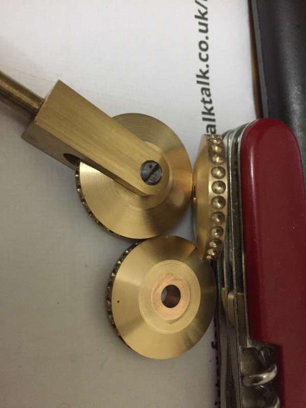

      Here is a pic of an embossing tool  I made for a local ceramicist:
      Rolletts+holder-scaled
      I made several wheels, but only one holder.  He now wants another holder but can’t give me the original to measure because “it’s in constant use”. And of course I can’t find my construction notes if ever I made any.
      What I’m wondering is if there is any way of reconstructing the dimensions of the holder from the photo when given:
      a) the diameter of the wheel
      b) the information that the ‘corners’ of the holder are at 90 degrees.
      I sort of think that mathematically it could be possible because (b) might allow calculation of the perspective angle from which a ‘face on’ perspective could be generated and then (a) would give a metric.
      I realise that the most direct approach would be to tell the guy that if he wants an exact copy he’d better give me the original to measure or no deal, but now I’ve got interested in whether it’s possible to do this sort of reconstruction.
      Robin.

                  Thanks for replies.  The ‘fiend’ (nice one Michael!) has left a spare wheel with me, so I know its diameter.  What I was wondering was if it is possible to reconstruct the dimensions of the 3D  object given the diameter of the wheel and the fact that the ‘corners’ are 90 degrees.  It has the character of what maths people call ‘an inverse problem’.  They can be difficult, but having seen what modern 3D CAD can do with the ‘direct’ problem (ie generating arbitrary 2D projections given a 3D dataset)  I wondered if the inverse process had been cracked.  I suppose someone with CAD skills could draw the general shape and adjust dimensions/projection angle until it fitted. But true inversion may be an ill-posed problem.
                  I shall probably get my hands on the original, one way or another, and make the thing though the ‘customer’ can sometimes be frustrating!  But my purpose here was really to enquire about the feasibility of the reconstruction of a 3D image from a single 2D projection given the constraints I’ve indicated.
                  Regards, Robin

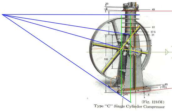

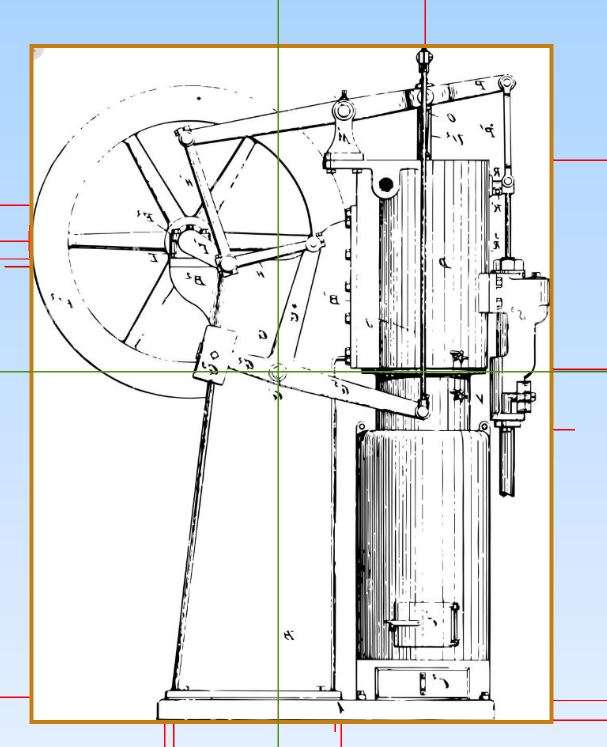

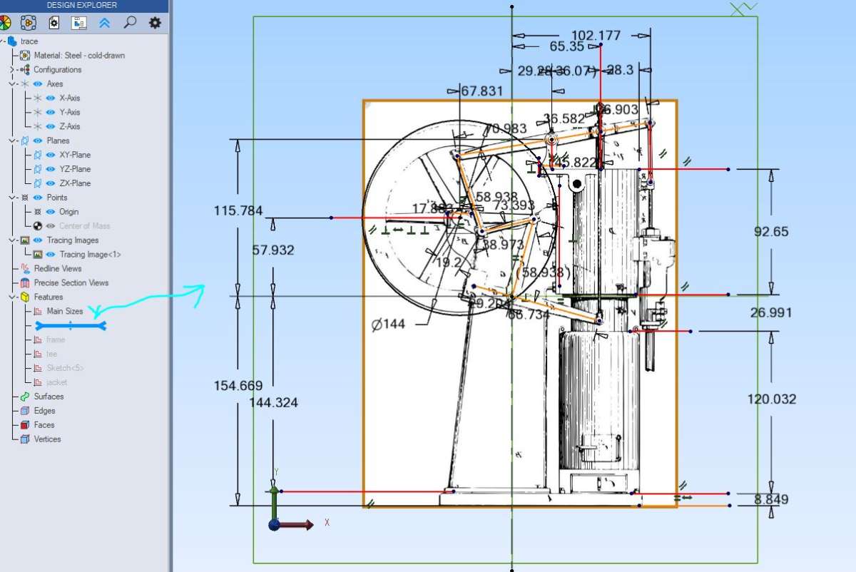

                          Post what the diameter of the wheel is and I’ll show you what is possible. I do it all the time with old engravings or photos of engines to pull a buuch of sizes off to enable me to design a new model. Probably 1″ if the photos with a steel rule in your other thread are anything to go by.
                          There are some programs that can take into account perspective or you can even construct your own vanishing points on a CAD drawing, the two red lines on this one go to a vanishing point

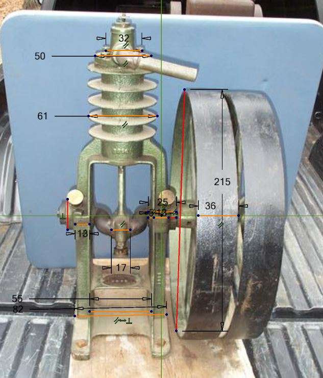

                                Being rather pedantic, it would be better to allow for components further away appearing smaller. Here the two green lines are intended to indicate how much smaller, in proportion, the flywheel appears than the cylinder because it is further away: about 7%.
                                compressor

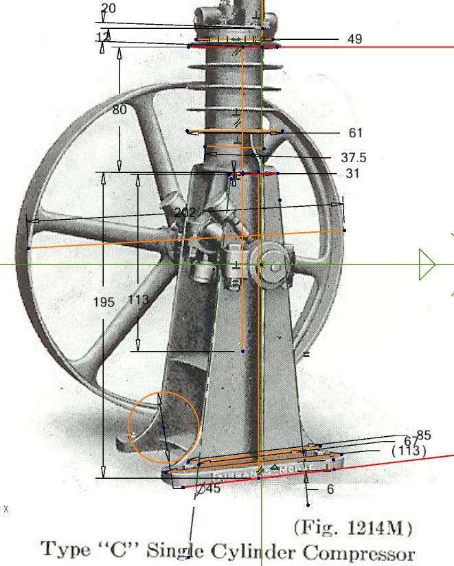

                                  Luckily I have several image sof those pumps and can take an average or use the best view for any particulat item. based on keeping the fins the same diameter as they are at eye level my 215 flywheel on this drawing is not far off 7% increase on 200mm. 😊
                                  I mainly just picked that image as it is recent and showed a vanishing point

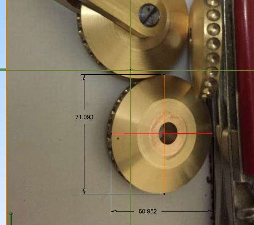

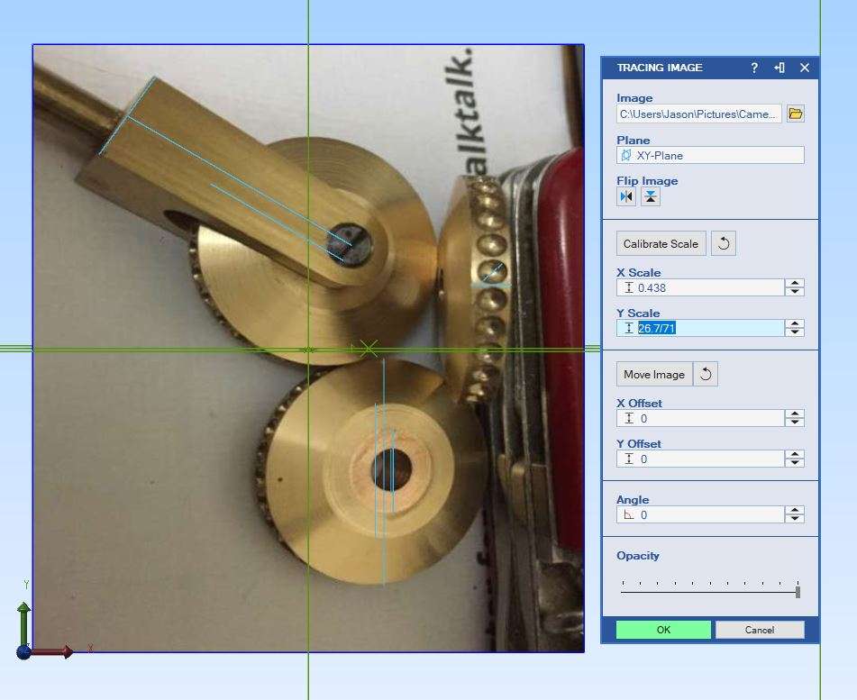

                                          I made a copy of your image and then imported that into Alibre.
                                          I then sketched two lines over one of the wheels and show the length they measured. As you can see these were quite a bit bigger than the known dimension.
                                          wheels 1
                                          The dialogue box for the image allows me to scale the image in X and Y. I have done X and you can see my entry in Y as 26.7 / 71 which Alibre will convert to a decimal as it has done with X. It can also be done by using the callibrate scale but I have always done it as described particularly if the image is squashed up in one axis as yours is.
                                          wheels 2

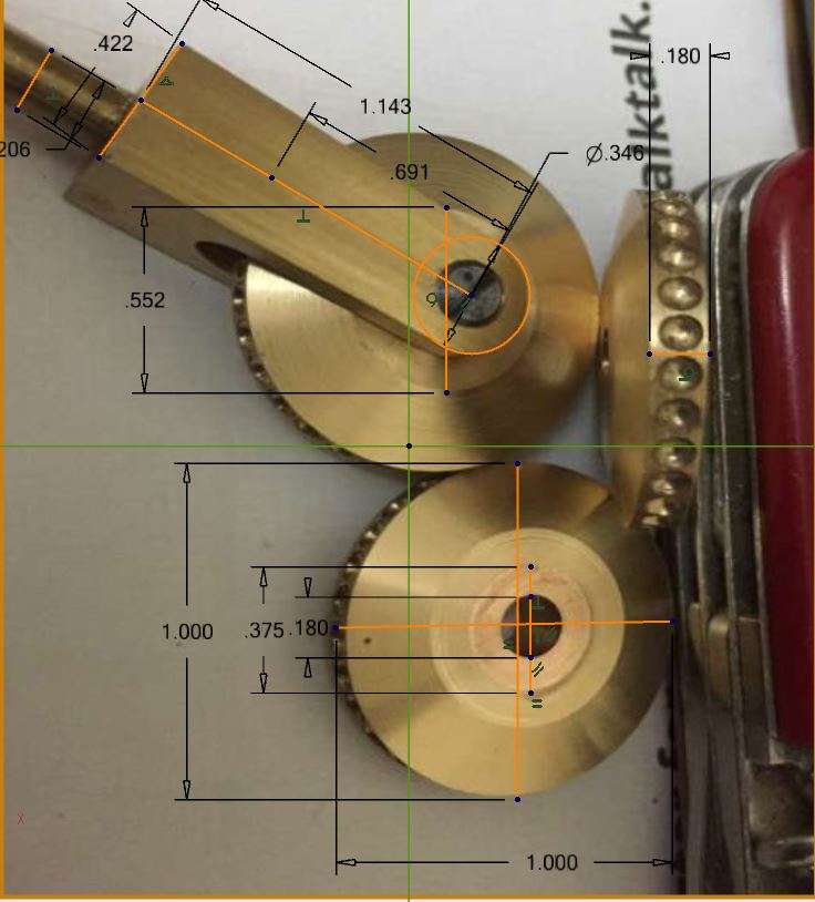

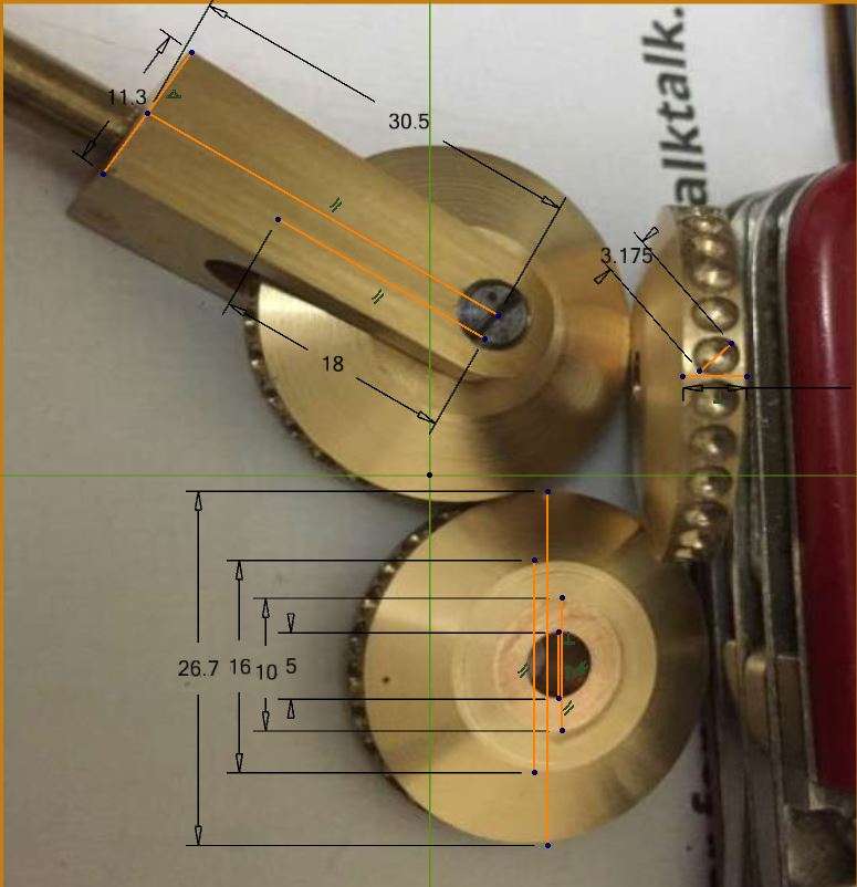

                                          With that done any further lines that I draw will be to the correct scale. It does need a bit of intuition for example my line may have been 4.92 for the hole but as you gave the OD in metric I suspected you work in metric so 5mm was the obvious number to go with.
                                          The other options in the box can be used to position my 0,0 datum at any point by moving the image up, down or sideways and I can also rotate it if the image is not level. You can see I have moved this one to put the axis through the central pivot
                                          wheel 3
                                          I can then start taking off dimensions knowing whatever line I draw it’s length wil be to scale and in most cases below from a known datum point
                                          wheels 4
