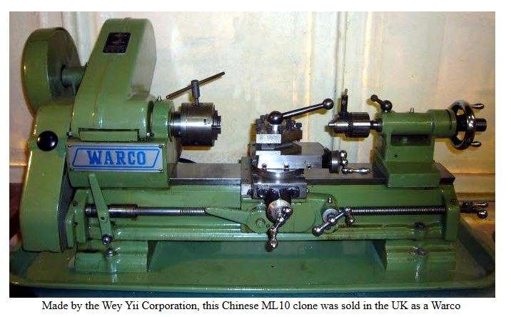

                                    If your lathe arrives tomorrow will you have a bench to put it on and another bench for manual work, and materials to work on and the plans for the loco? So let the advice settle down while you get that sorted and find surprise surprise 90% of the work on a loco does not involve a lathe. You have a year of non circular bits to occupy you.

                                              The quality of Chinese manufacturing and quality control as regards machine tools, increases as you give them more money.  That shouldn’t be surprising but a lot of people do seem surprised by this.
                                              That’s why you hear of so much discontent with Chinese mini lathes (so the 7″x10″, 7×12″, 7″x14″, and 7″x16″ models) and much less with the benchtop lathes 9″x and 10″x and above.
                                              If you can possibly afford (in space and financial terms) it, avoid buying a Chinese mini lathe.  They can be made to work really quite well, but it’s really rather a daunting first project to tackle, when you should be just making chips and having fun (ask me how I know).
                                              None of the Chinese lathes fresh out of a Weiss or Seig factory, are as well manufactured and QC’d as say a Harrison, Boxford, or Colchester would have been fresh out of the relevant British factory.  That’s not the fault of Chinese manufacturing though, it’s the fault of the West wanting things on the cheap.
                                              The Chinese lathes are, however, with a bit of fettling and adjustment, entirely good enough for our purposes and they are accessible.  You can buy a brand spanking new Myford Super 7, made in England, today but it will cost you around £10,000.  Depending on the model you buy, the Chinese lathe will be at least as, if not more, capable than the 10 grand Myford.
                                              I would also recommend Warco as a supplier.  They’re more expensive than other suppliers but you do get something for your money.  The customer service is great and their spares department people are some of the most helpful bunch of people I’ve ever had the pleasure of dealing with.
                                              Finally, I would absolutely recommend going larger than you think you need.
                                              Obviously I’m not suggesting you buy some 16″x40″ behemoth, but if you were to buy, for example, a WM250V from Warco, you will be unlikely to say to yourself “Damn, this thing has too much capability size-wise“.  You might conceivably find yourself saying “Oh, I wish I had a bigger work envelope“, were you to buy a smaller lathe of equivalent or greater quality.
                                              (p.s. apologies for the use of imperial in describing lathe swing and distance between centre, I use metric often when in the workshop, but still find inches easier to visualise, in terms of lathe size)
