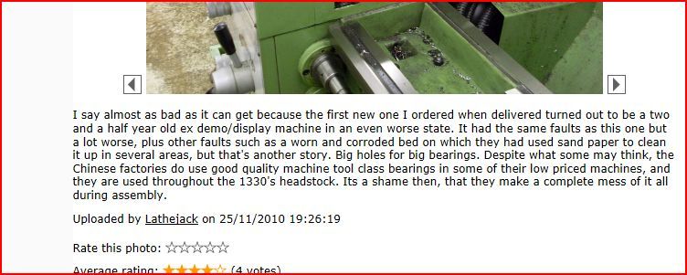

          Hopper, there are comments or maybe captions under each photo in the album for example
          Lathejack does not post much on the actual forum but las a lot of albums with comments about each picture, almost a small article in their own right.

            Thanks Jason. I managed to figure out how to see the comments when I looked at a few of the other pics.
            Still not seeing a header bar with Mike E's name, avatar, post count etc in it, and no footer bar with quote/reply etc in it, hence the confusion. Yet another quirk of the automatic "upgrade" to Windows 10 I suspect.
            Yes, certainly a shame that poor assembly lets down otherwise nice machines in some cases.

              Once I'd worked out that clicking each of the photos in the album an explanation is provided for each shot it all makes sense. Many ways of skinning a cat and that’s just another way of posting on the forum. Not the usual approach but effective.
              Now I'm going to have nightmares about my Chinese lathe. So many similarities to the Warco in the design of mine. That said I believe the 'Chinese way' is to have a common design and many different manufacturers so there's a bit of luck as to which factory your supplier uses. So Gizzly, Chester, Warco, Machinery House, Hare and Forbes et al may use different sources for similar products. I have a Chinese copy of a Deckel tool and cutter grinder. I've seen about 5 different variants with slightly different features and build qualities (mine isn't that good).

                    I can't find a thread called Chinese torture. I did read all of the comments in the album. Of interest. If I bought a chinese lathe it would be from that range. What the comments indicate to me is that if I do buy one I will take a good look inside it. I probably would anyway as there have been comments before about sand in castings.
                    It does sound like Warco shouldn't have sold the first one to anybody unless is was ex demo and at a reduced price.
                    The rust is interesting. Small Chinese lathes did come in heavily coated with preservative. May still do so. Stripping and cleaning it all off was a lot of work. I'd suspect that cropped up where the parts were made.
                    Hand fitting as I understand it is pretty normal on items like this. Maybe they should have found some other way of locating the part where the drill went through an O ring.
                    He's fixed some aspects that he didn't like the look of. Might have needed doing might not. The feed pattern problem would probably be down to something wobbling while it rotated. Sort of reduced level of problem Brian had with the lead screw support on his Opti that may or may not be a one off. Could be that some adjustment was needed on the saddle, maybe hand work on the bed as per Brian's again.That's bad really if that is needed as it should have all been done in one setting on a slideway grinder but even those have marginal errors.
                    What struck me is once he had cleaned it up he seems to be pretty happy with the lathe. Then comes the low cost Harrison mentioned. Likely to have done enough work to have a noisy gear head and wear in the slides and head stock bearings plus any others in the gear head. Another lot of work to get it back to ex factory fresh. A lot more I would say some of it being impossible and or rather expensive.
                    All in all it wouldn't put me off but I happen to have found a pretty old Boxford that has done very little work. Even so the cross slide stiffens up when wound fully out and the headstock bearings should ideally be replaced. There is a bit of oval wear in the front one. It's not easy to find lathes like this and often they can be a lot worse and there is far more that will wear out on gear head lathes.
                    Pity he didn't publish the accuracy reports and compare them with his own measurements. The few reports I have seen indicate that they all aren't that bad really what ever they are compared with except what might be called very high precision lathes – when those were new and came out right.
