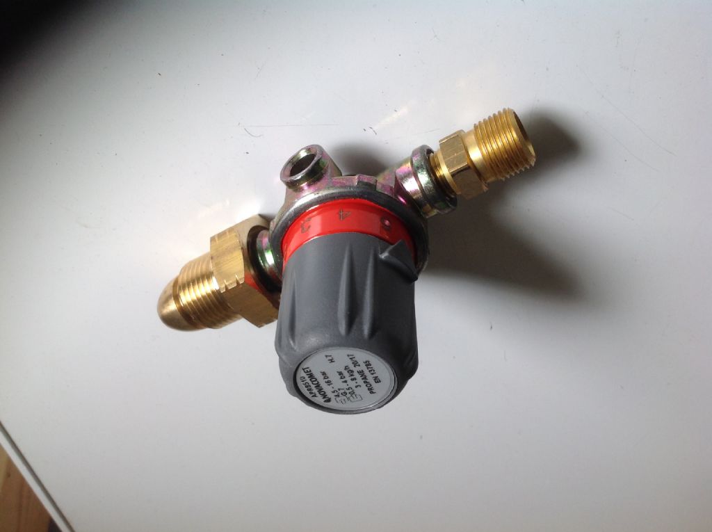

        I've just bought a Sievert Pro 86 torch kit and it came supplied with an unexpected bonus item in the form of a "0.5-4 bar" regulator as pictured.
        There is a dial that goes from 1-10, which I assume marks 0.4 bar increments. The only puzzle is that the adjustment knob cannot be turned beyond the 5 mark or thereabouts.
        Is this because the manufacturer has limited the output to 2 bar on this regulator, do you think, and has done so because the standard nozzle/burner* that comes with the kit is designed to be run at 2 bar? Or is there a fault with the item?
        I have two other 0-4 bar propane regulators and neither is restricted in this way.
        *Much bigger Sievert nozzles/burners (that need 4 bar) can be fitted to this torch if required.

          I think we had a thread about one of these regulators a while ago.
          link

            Thanks for the link.
            I take it, then, from Iain's reference in that thread to turning his regulator up to 7 that I should be able to turn my dial at least that far as well, and because I can't I have a faulty regulator.
            Anyone that knows better, your insight would be welcome.

              Just tried ours, it goes all the way to 10 but it is VERY stiff past 5, perhaps due to the spring pressure.

                      I recently bought the same torch kit with identical regulator, which gets a bit 'tighter' around the 5 and the 9, but reaches 10 OK. Mine is not like Brian's, it is not 'very' stiff. Perhaps a bit of use will bed it in.

                        Taking my cue from Brian (eta: thanks, Bill – only just seen your post), I put the regulator in a vice so that I could get better hand leverage on the dial (I've got limited use in one of my hands). I'm pleased to say that it did turn further than 5 and after a few vigorous back and to turns it now opens all the way to 10, albeit with some difficulty (for me at any rate).
