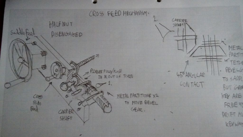

          Hi Naughty boy,
          I have thought about this in the past and as far as I can tell a motorized option would probably be the most straight forward route.
          A mechanically operated version from via the leadscrew gear train would require, A. a means of separating the apron from the leadscrew such as using half nuts, and B. keywaying the entire length of the leadscrew so that the force of the leadscrew can be carried over onto a crossfeed gear train.( You need to separate them because otherwise the saddle will start moving at the same time as the crossfeed)
          As I said option 2 is very difficult and would be hellish in it's own design terms, the only people who might have an easier time of it would be the people who were lucky enough to own the rare updated version of the CL430 known as the Warco WMT300/02 which has an apron and rack/pinion feed, (you don't necessarily need a rack and pinion as there is very little room to install this, and instead you could have a wormwheel feed on the handle but would still need the half nuts.)
          That is about the gist of it for how most mechanically driven setups work, a plunger pushes a gear into engagement with a train that operates from revolving the keywayed leadscrew which the keyway is also holding a gear, which in turn is free to slide up and down the length of the bed and only engaged when you need it.
          PS. It's very easy to criticize Clarke/ whoever in china designed this lathe, for not using an apron with rack/pinion arrangement in the first place but instead chose to permanently couple the leadscrew to the saddle, but it's also a lot to do with the surface finish of the work, it can operate in very fine movements and not twist so much from left to right as the saddle and tool progress into a cut, all it has to hold onto is a gib otherwise, and this is why most modern lathes have a polygonal profile bedway because the Vee shape alone doesn't hold onto the saddle very well without some additional form of support, like a guide rail, to keep the linear movement straight, that's why this conversion is about more than just decoupling a nut.

                #270054
                MW
                  @mw27036
                  Fair dos naughtydog, i'll PM you tomorrow when I get it up. I'll start snapping pics and getting some material together. I will include what I propose what I think is the easiest way to get a decent outcome even if I haven't made that yet!
                  It will just gather up my findings into one place for anyone to either glare at or gaze upon!
                  Michael W

                          #270325
                          MW
                            @mw27036
                            Ok sorry I've been a bit late coming on here but man of my word here I am;
                            I have decided to keep my project of a rack and pinion operated saddle a separate post from this one so that I don't convolute it with two different questions (although they are inextricably linked together!) I found a diagram yonks back (like a number of months more like) that showed a simple crossfeed system on a myford. I'm not using the same computer as I did then so the images are lost unfortunately. But I am largely basing my design upon them.
                            Just thought i'd put this image up first that really underscores one of the big problems with making saddles/aprons;
                            That's just a view from the inside of a Colchester master I found on practical machinist. One of my favourite lathes actually but by no means the most complicated one out there, and yet were trying to achieve the same functions with a fraction of the space available. Its huge!
                            Here is my squiggle of the idea I formed about making a cross feed operated saddle, again, I don't touch on the issue of rack n pinion, and the whole thing assumes that's already done and you've got some half nuts, i'm sorry if it's a little hard to understand but i'm not on a commission for this drawing. If anyone has any questions i'll do my best to explain, and as you can see, these things are so crowded it was a little hard for me to fit it all in.
                            crossfeeddrwng.jpgOk so here it is, the trapezoid type objects to the right are the critical first step in this chain and they represent bevel gears, on the same shaft as the carrier, another gear sits behind the bevel gear which is an ordinary gear, the plunger is pulled in/out to complete or break the chain of force carried over onto the cross slide gear. They all need to be keywayed and grub screw hold down other than the leadscrew bevel gear which is free to slide up and down along the keywayed leadscrew, it is kept "tethered" to the saddle by (just one actually) metal bracket, you only need 1 because if we traverse back up the lathe bed it is just carried by the contact of the adjoining bevel gear.
                            So if you aren't all worn out after that i'll put a link to my failed racknpinion write up, which i'm obviously disappointed with but in light of recent questions, is perhaps worthwhile by the community.
                            Michael W
                            Edited By Michael Walters on 06/12/2016 18:39:48
