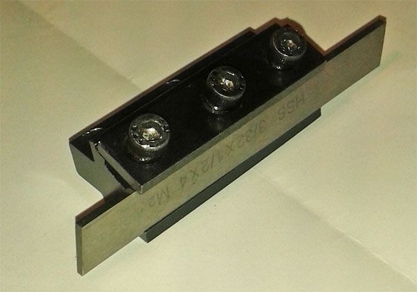

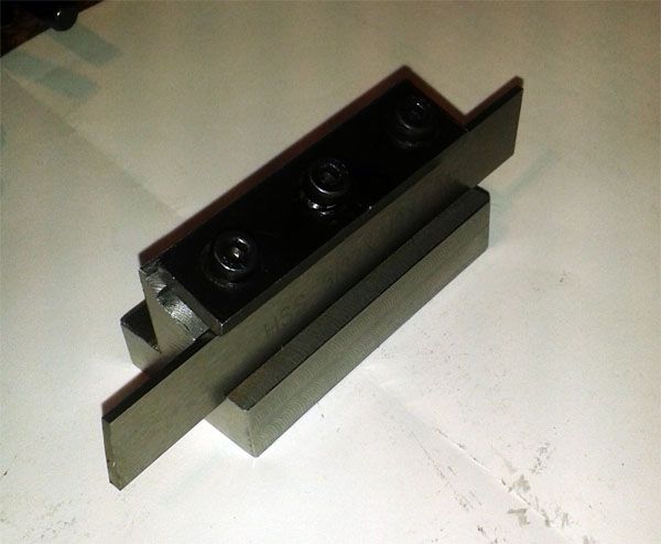

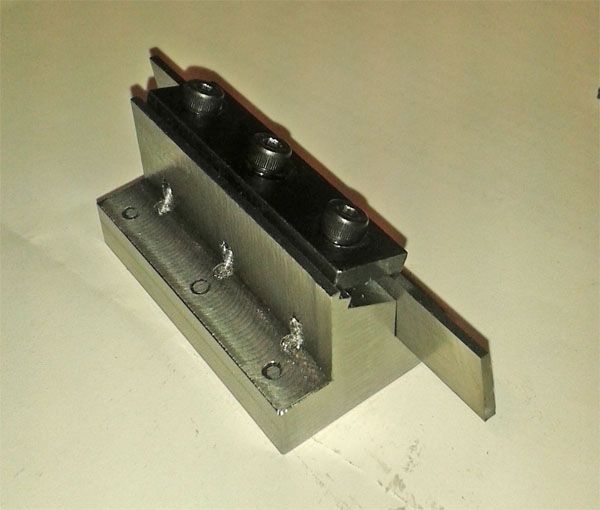

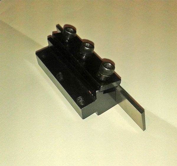

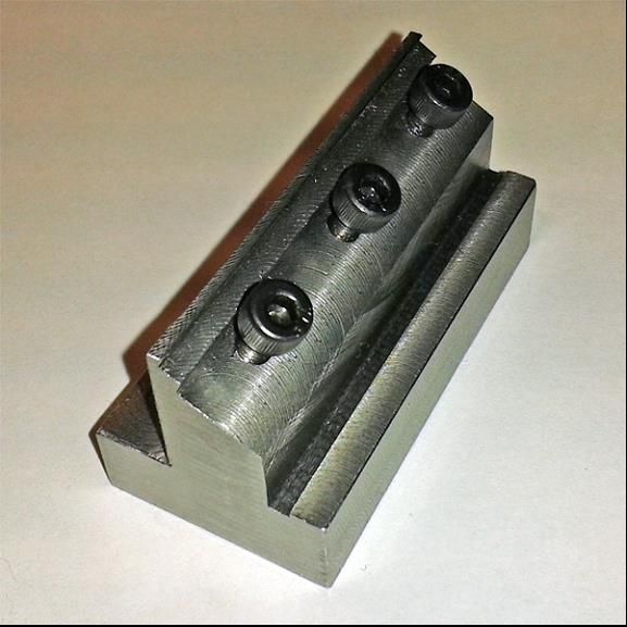

                                  David Cambridge
                                    @davidcambridge45658
                                    Thanks everyone for the input on this. I tried to get the inverted parting tool holder from eccentric engineering, but unfortunately they didn’t have any in stock so yesterday I made my own. What a result! It was magic and I parted off a 1.5 inch aluminium bar without issue.
                                    David
                                    Home made parting tool holder :-

                                    Vic
                                      @vic
                                      Any more pics David, perhaps with the blade in it please?

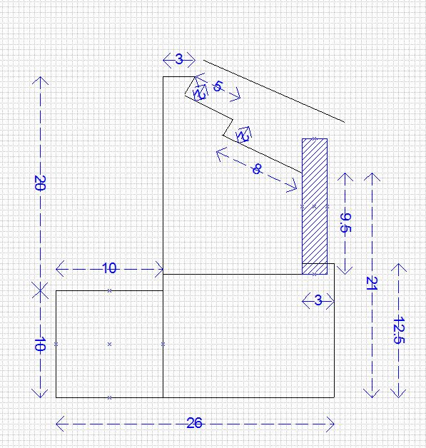

                                      #177391
                                      David Cambridge
                                        Vic (and everyone else)
                                        My original parting tool came from RDG tools and had a 4 x ½ x 3/32 blade
                                        When the blade is upside down then the cutting edge is at the wrong height. The home made parting tool is similar, but with the section that clamps in the lathe at a different height to correct for this (see below)
                                        I used a tilting table for the ~25 deg angle at the top, and a 3/32 slitting saw for the groove the blade sits in at the bottom.
