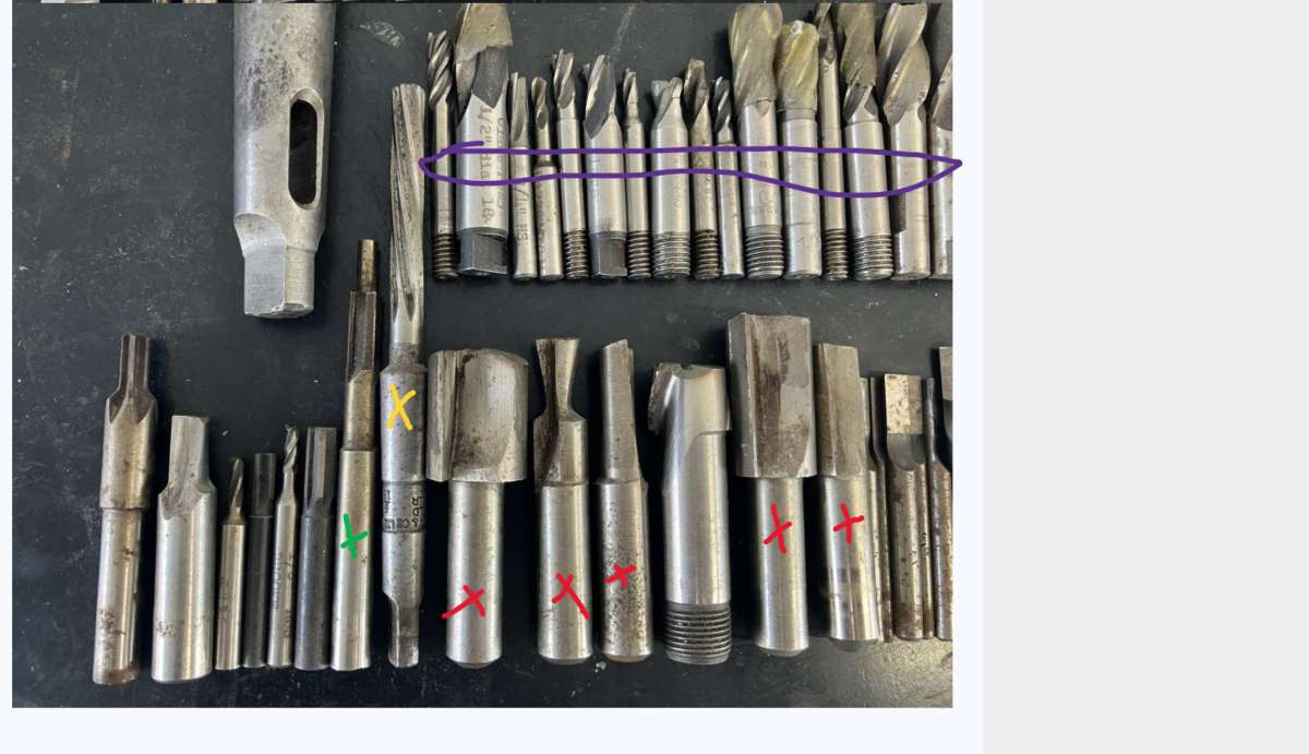

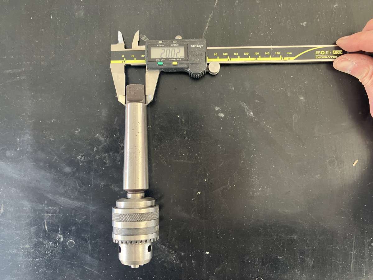

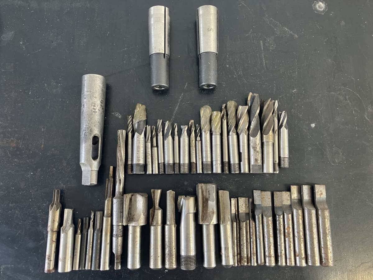

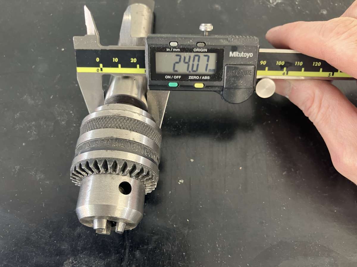

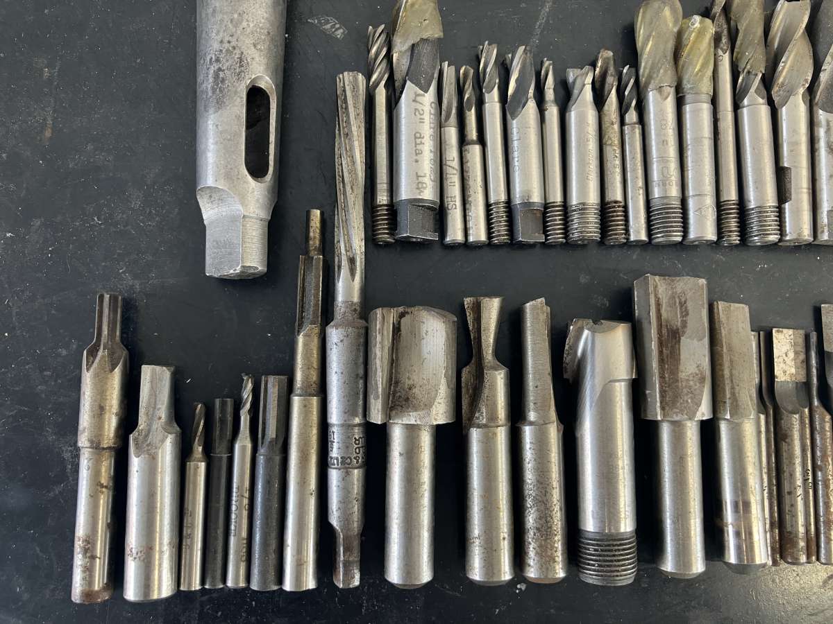

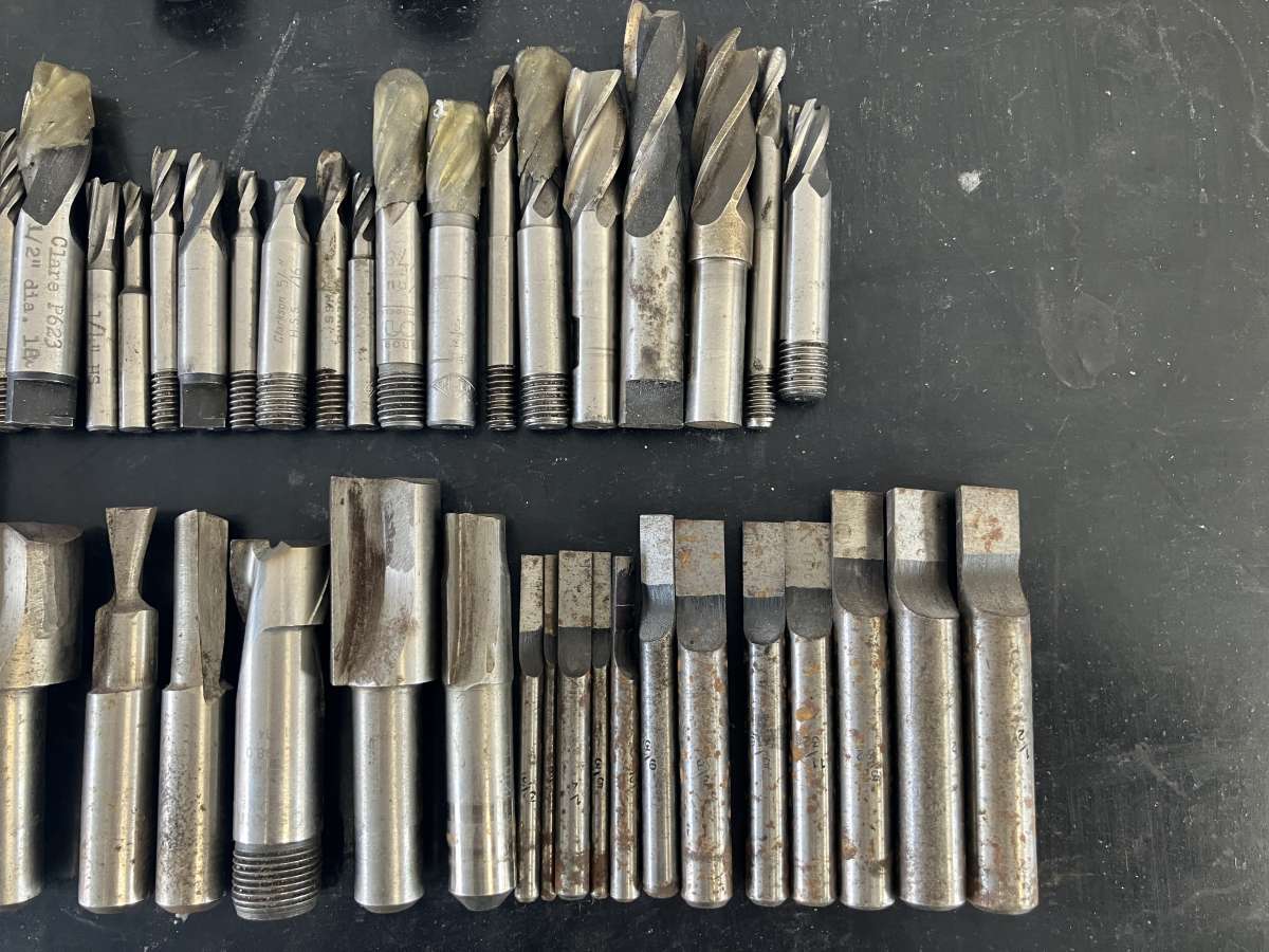

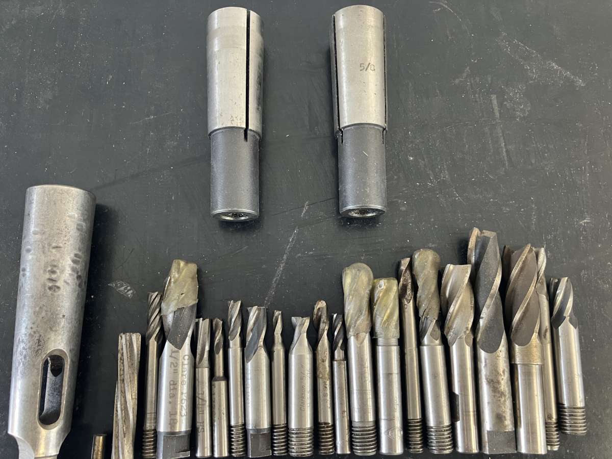

        Just updating this as I secured the mill, broke it down to transport and have just got it back together again – thanks for all the help and advice.
        I’m about to sell my original mill which came with a series of tools, many I have no idea what they are for.
        I’m trying to establish whether they are any use to me, or if their fitment / taper are not compatible with the VM-C?
        You’ll need to forgive my ignorance, but I really don’t have a clue at this stage, so just need to know whether I let these go with the old mill, or whether I can use them on the VM-C?
        Here are a few shots I took with some measurements which may help confirm suitability or not?
        Thanks in advance.

              Mark Easingwood
                @markeasingwood33578
                Red are Router cutters for woodwork.
                Purple are HSS End Mills or Slot Drills, (generally, 4 flute = end Mill, 2 flute = slot drill)
                Green looks like a  counterbore.
                Yellow is a morse taper machine reamer.
                The two items with thin slots look like morse taper collets.
                The large tapered item with a slot is a morse taper reduction sleeve.

                    Am I correct in thinking that anoy of the tools shown will need a collet to fit, therefore the key element is whether I have or can get collets to interface between these tools and the VMC, once I find out what they came with new?

                        Yes, you certainly do need collets for the tools; but they will be of a standard fitting to the spindle so finding them should not be too difficult.
                        First, the spindle form: on the Myford VMC most likely Morse Taper or (as on mine) R8. The latter is or was very common industrially, thanks largely to Bridgeport using it on their ubiquitous turret-mills, so we can find R8 tooling quite easily. It holds securely but is easy to release, important for efficiency in production shops.
                        It’s easy to identify those types, especially if you happen to have a suitably large Morse-taper drill or something to use as a basic gauge. Look in the end of the spindle: the Morse fitting is a single, slow taper over a fairly long length. The R8 has a very short entry cone into a cylindrical bore.
                        The taper-shank tools you show, including the drill-chuck, are all of Morse taper form. If you slide one into a Mores-taper spindle it should fit sweetly overmost of it length, and be gripped tightly when you tighten the drawbar. If the spindle is an R8, the Morse-taper shank will soon let you know. It won’t fit! And vice-versa, of course.
                        There are essentially three main types of milling-cutter collet, both pulled into the spindle by the drawbar (like a long bolt) whose operating head protrudes above the pulley when the quill is fully raised. They are…..
                        1) Direct split collets. These are long tubular tool holders, of either Morse or R8 spindle form, that have three slots cut part-way along them from the business end, so when the collet is pulled into the spindle the matching tapers squeeze it down onto the shank of the tool inserted into it.
                        They hold the plain shank of a cutter, irrespective of any screw-thread or flat the shank happens to have.
                        You show two of a simple form of these, to a Morse taper.
                        I have a set for my R8-spindle mill but am a bit wary because if they don’t grip fully the tool can slip back upwards or worse (I have had it happen) wind itself down into the work.
                        2) Screw-collet. These, perhaps the best-known being as the Clarkson ‘Autolock’, use short, stubby collets that fit a special chuck that itself has a stem that fits the spindle.
                        The collet has a split, spring-action grip like the direct collets, but its top end it also tapped to take the thread on the end of the cutter. About half of the cutters in your photograph are of this threaded form, and if you examine them you will see that end also has a centre-drilling that engages a centre within the chuck.
                        They are assembled and tightened in a particular way, involving a large, special spanner.
                        3) ER-number collets. These seem standard issue on the smallest milling-machines. Like the ‘Autolock’, the collets themselves are held in a special chuck that has the spindle fitting itself. As far as I know the ER was never standard on Myford mills, but ER-xx chucks with appropriate shanks might be available since the spindle fittings themselves are of standard forms.
                        These too, have their specific method of use.
                        Those are the cutter-holding forms I think most us see in model engineering. There are others in industry, such as the ‘INT [ernational’] -number series and the ‘Weldon’, both I think especially on CNC machines with automatic tool-changers.
                        You may also find the ‘FC3’ or “throw-away” milling-cutters – their nickname because they are too small and fiddly for economical sharpening in industry. They are tiddly little things for fine work, and are held in a special, but simple, holder that itself is mounted in an ‘Autolock’ chuck or direct spindle collet.
                        You don’t buy a collet for every cutter. The cutter shanks are made in a range of diameters, each shank diameter accommodating a narrow range of cutting-edge diameters. Although it’s not obvious, this is shown to some extent in the photographs.
                        For any tool-holding system you must ensure correct diameter collet for the cutter shank diameter, including being aware of metric or inch. All these are ground to fine limits so they fit together correctly, and if mis-matched they will not operate correctly, damaging the work, and worse, risking a broken collet or tool, or both.
                        The metric ones of the Clarkson ‘Autolock’ collets are indicated by a groove turned in the flange at their top end. The inch ones are left plain.
                        To a limited extent the ER collets, apparently available in mm diameters, will hold close-match inch-diameters, but from using them on the lathe I am not convinced they do so reliably. They are really meant for metric stock of good quality diameter and surface finish; and that does include metric-diameter milling-cutters.
                        Twist-drills normally need a standard 3-jaw drill-chuck, with an appropriate stem for the milling-machine’s spindle. Never use a drill-chuck as a milling-cutter chuck.

                          Wonderful thanks so much.
                          I’ve since found out my VMC came with a Clarkson auto-lock chuck which sounds useful and all the documentation supports R8 spindle.
                          Essentially, it sounds like the answer is to keep everything I’ve got pictured with the exception of the collets and obviously the drill chuck which are for my original mill. Having now researched the measurements, is MT-3.
                          Sound about right as a plan?

                            You could change the arbor of the drill chuck to R8, no need to replace the chuck if it is OK.
                            Look at what is written on the chuck it will be a JT or B followed by a number, that indicates the siz eof teh small taper in the chuck and you need an arbour with that taper on an R8 shank.

                                  Thanks all – the collets are all MT-3, as is the drill chuck – all from my old, original mill.
                                  The VMC has its own R8 drill chuck and bits and bobs. It was just to see if anything from the old mill was worth keeping, other than the tool bits.
                                  Hopefully I can begin to practice on some stuff, as I’ve now got the VM-C and the Super 7 side by side and ready to go. Just needs someone with even half a clue of how to use them.
