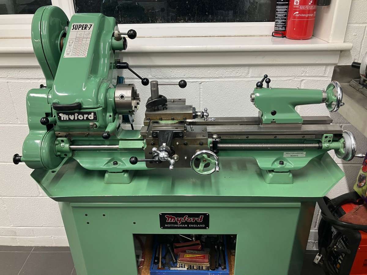

              To give you an idea, this is the lathe he also had from new….
              super7

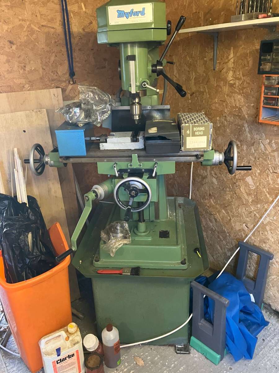

                Ah, just found a photo I took on my phone whilst I was there. Still dirty, but would clean up similar to the lathe.
                mill

                      It doesn’t look the milling-machine has had much heavy use, but I’d rather see it with the table exposed. The machine itself looks to have been repainted fairly recently, when compared to its stand.
                      The lathe looks so new I wonder if it’s a recent Myford rebuild that had had virtually no use by the seller.
                      I treated my ML7 and VM-C to Newton-Tesla 3-ph conversions, and the mill to an Allendale DRO. If you do buy the mill and consider those modifications they are expensive but worthwhile (I used the mill today, even!); but fitting a 3-axis DRO to a machine not designed for such things is a challenge.

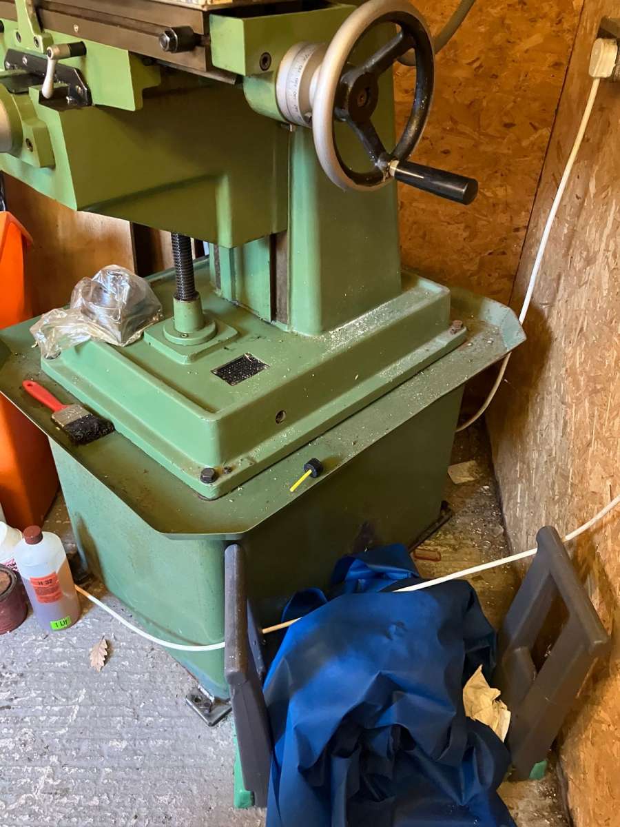

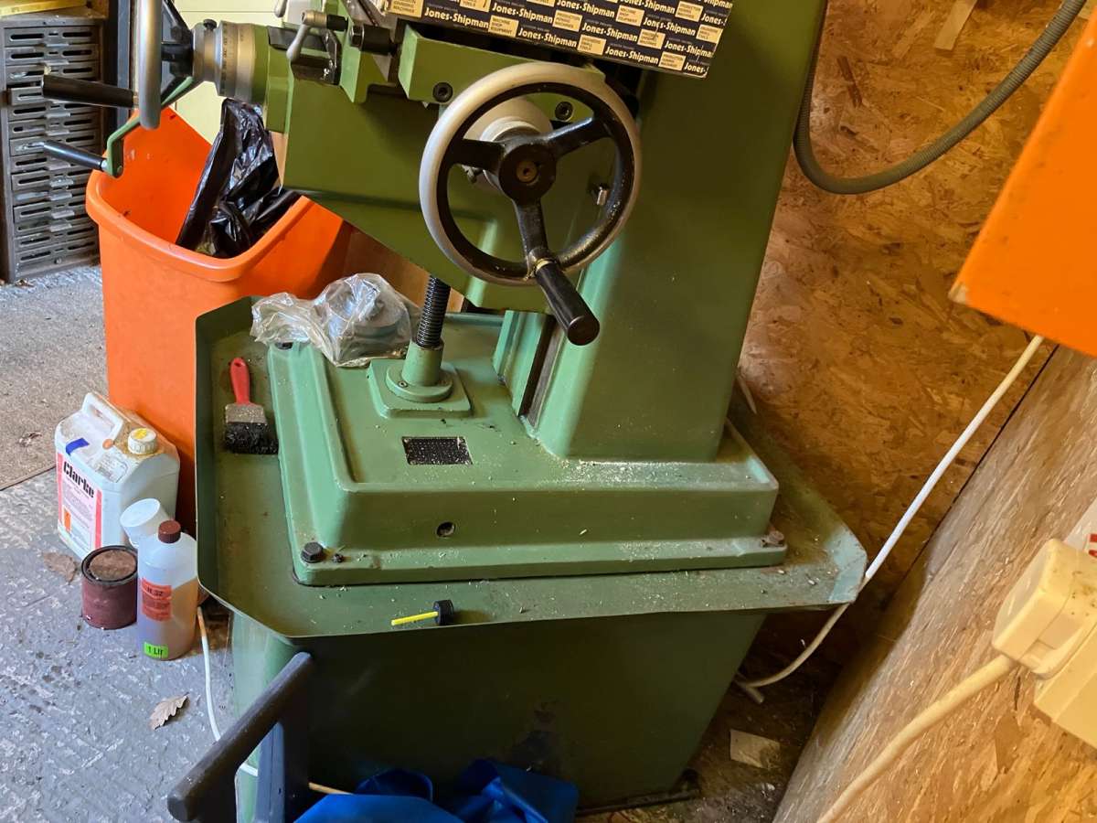

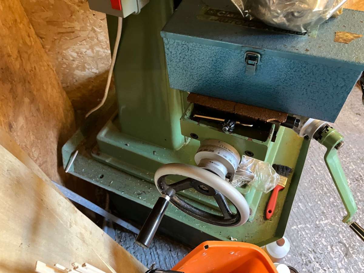

                        Found a few more photos. Only cosmetic defects are the few paint chips. It’s just a little dirty and dusty. The chap is in poor health and in his 90s.
                        mill2mill3mill4

                          Anyway. In answer to your question. The last 2 Myford VMC’s to sell on ebay fetched £1170 and £1570 neither looked as nice as the one in your pictures, though one did have a DRO.
                          The Myford VMC is made in Taiwan, inspected by Myford and rebadged.
                          The Warco VMC is essential the same machine, but the new ones are made in China rather than Taiwan. They are currently about £3k new and regularly fetch between £1000-2000 used depending on condition, tooling and spec.
                          The Myford name will always add a premium, but to me it doesn’t matter that much.
                          My gut instinct is that £1500 would be fair.

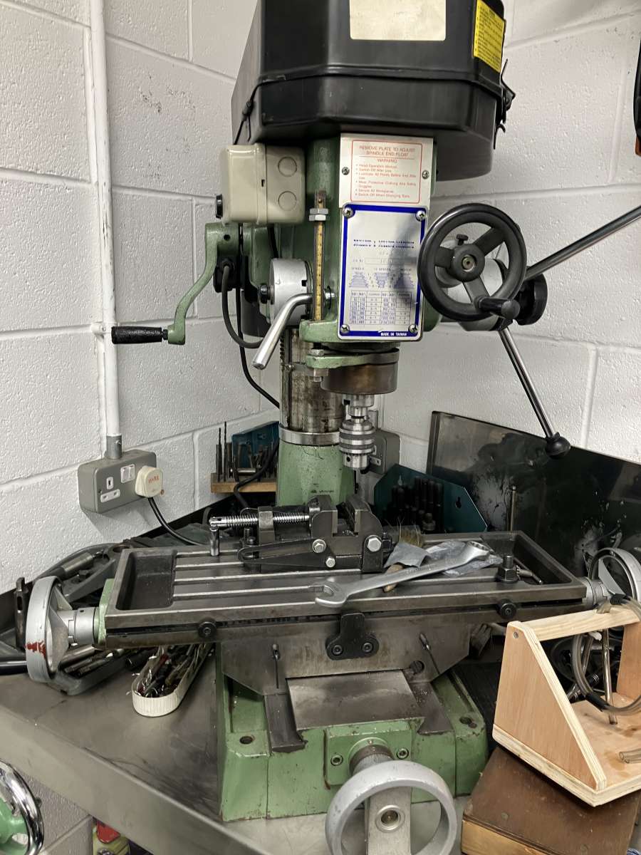

                                                The lack of fine quill adjustment has been a school day for me and has taught me that my own existing mill already has that feature and I can’t imagine how you’d easily take another 10 thou’ off without having to remeasure everything? Or have I got that wrong.
                                                My existing mill is a Tiwainese no-brand as pictured below. It’s ok but has excessive backlash on the Y axis lead screw which if I adjust out in the middle of travel, makes it tight toward the ends of the travel telling me it’s heavily worn. It might be operator error, but I observe some chatter too which made me want to upgrade it. The lack of fine quill though does sound a faff if my understanding is correct?
                                                Here are pics of the current one I have. Perhaps the enlightened amongst you could help identify what I have?
                                                IMG_6075IMG_6074

                                                  The lack of fine feed isn’t that big of a deal really. You just raise the knee. Raising the knee retains rigidity better than lowering the quill anyway.
                                                  I’ve had both versions (Taiwanese Myford and Chinese Warco) of the VMC. Not much to choose between them but the the Taiwanese version is slightly better build quality and better finished. Both are good rigid machines.
                                                  IMO £2000 is the top end of what it’s worth so it would need to be in very good condition.
                                                  For the same money you could probably get a good used example of the Warco version with a DRO and/or power feed/s.
