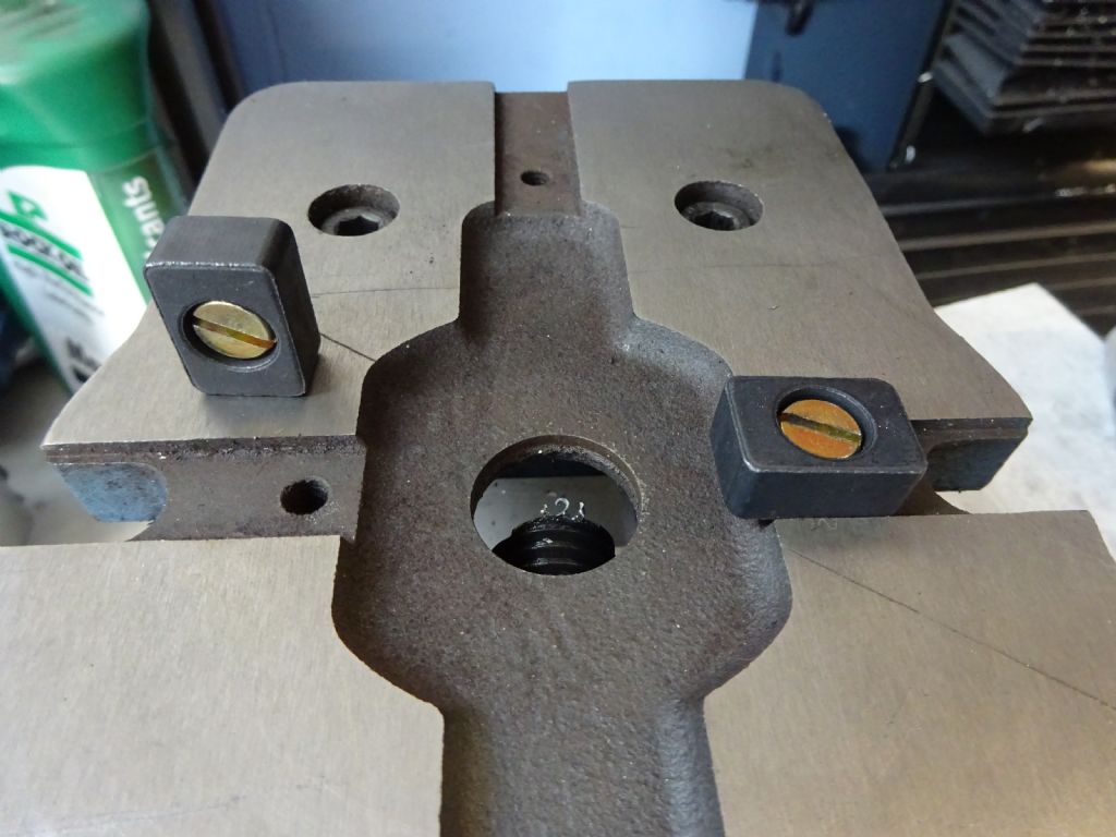

                    I know I,m a pain but can anyone tell me what these small blocks which are supplied with the vice are used for, I have no idea.
                    #376744
                    Limpet
                      @limpet
                      Ron I believe they are to fix on the bottom of the vice so you can (supposedly) locate them in the table slot for easy alignment with the table, that's if they fit your table slots. I never bothered with mine preferring to 'clock'the vice in with a dial gauge.

                      not done it yet
                        @notdoneityet
                        They presumably are the locating keys (mentioned as supplied with the vise) so hopefully they will fit into the keyways on your table, when affixed to the bottom of the vise to align the base, either lengthways or crossways. Not much use if you are not using the swivel base, I would think.

                          Thanks guys but no, they dont fit my table T slots, thanks for identifying anyway.

                              As said the blocks go into the grooves in the bottom of the vice or it's swivel base. Unfortunately they make then all the same size irrespective of jaw width and at 14mm will be too big for a lot of hobby bench top mills.
                              A quick tickle with a file suggests they are not that hard so could be milled down to fit your slots leaving a small section at the full 14mm so they still fit snugly in the vice.

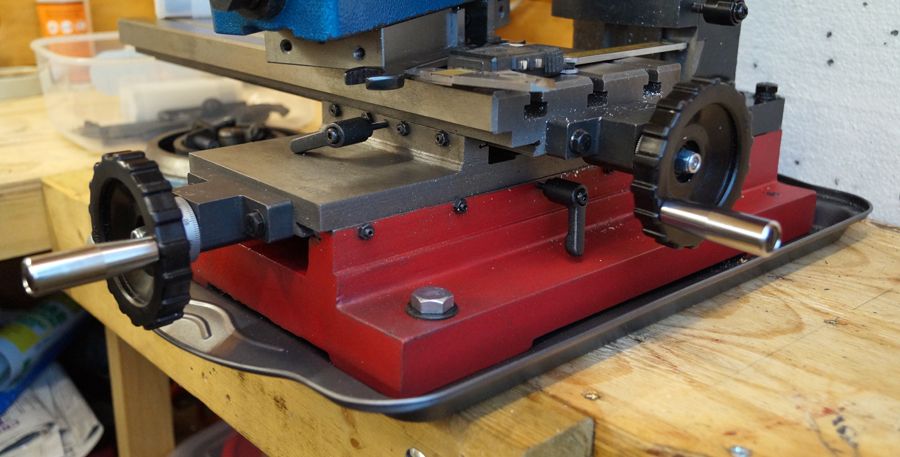

                                I saved a few bob today, I was walking through the cooking section in a cheapie shop when I noticed a shallow sided roasting tray, it reminded me of a mill oil tray certainly not a millions miles from one. I bought it, it will just need 4 holes for the fixing bolts at £2.99 instead of £32 for the mill tray there was no argument.
                                The SX2P uses 8mm T nuts which have a M6 thread, they are quite small, in fact the two I used to fasten down the vice look a bit lost and I used two of the small clamp bars to stop the M6 nuts pulling through the vice fixing slots. I guess they do work but by choice I think I would be happier with M8 threaded nuts. I was thinking of making some but even easier buy the 10mm (M8 thread) T nuts which are just over a tenner for 10 off and modify those. The table slots for the top of the T is a tad over 8mm so M8 rod/bolts will fit but there wouldnt be a lot of wall thickness left in the nut top front and back. Plenty of meat left and right and also plenty in the base of the nut. Think I will get a pair of 10mm nuts and see how they turn out.

                                    The slots on my mill are not quite the same width by a thou or three.
                                    I milled down the stops for my vice a bit (easy with carbide tool, I think HSS will be OK) and fitted them so that to align my vice I just push them to the back of the slot.
                                    Note- your vice may be like mine so that without the swivel vice the slot runs along the length of the vice, which may or may not be what you want. Jason seems to have got lucky and has two-way slots.
                                    Obviously if you use them with the swivel vice they will only be as accurate as the alignment of the vice with the base, but you can still remove and replace the vice using them if you don't swivel it.

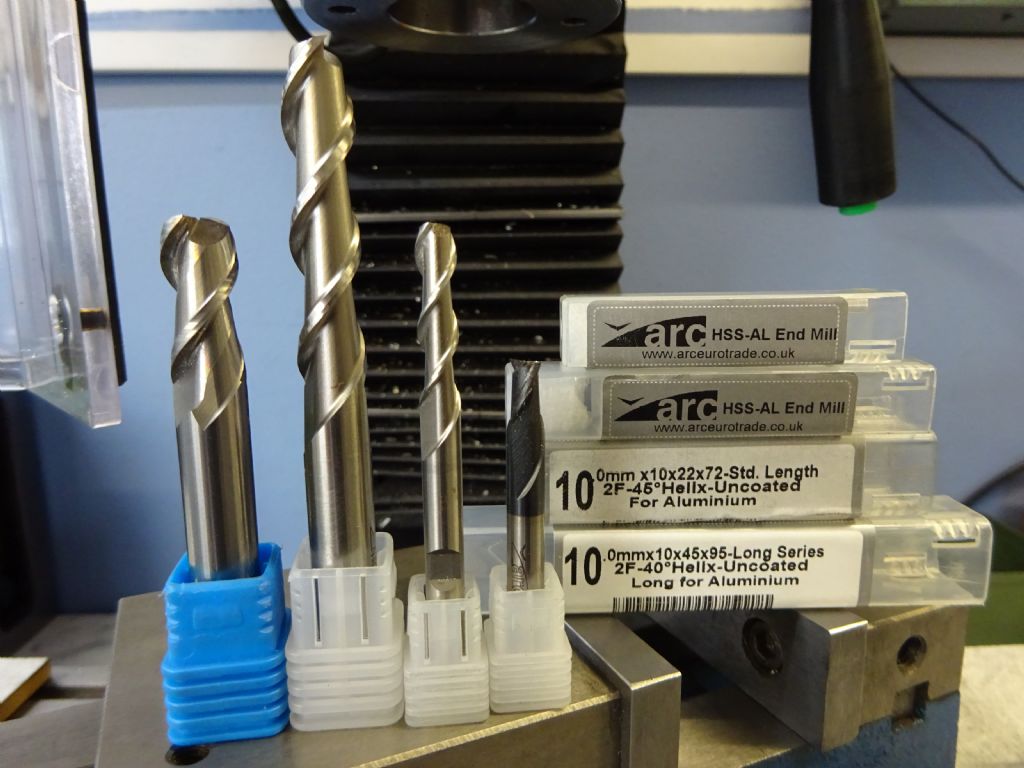

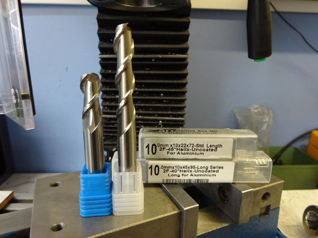

                                        I also took these couple of photos to show how much longer the long series cutters mentioned the other day are compared to standard length ones.

                                          Thanks for the photo Jason, I cant see me needing one of the long reach just at the moment, looks useful though when you have larger jobs to consider.

                                            My £2.99 oil tray, I think it will do the job, its "non stick" too..wink

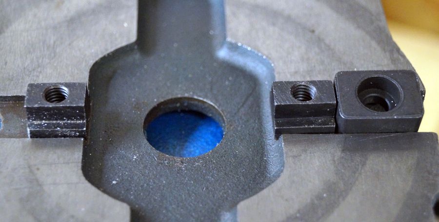

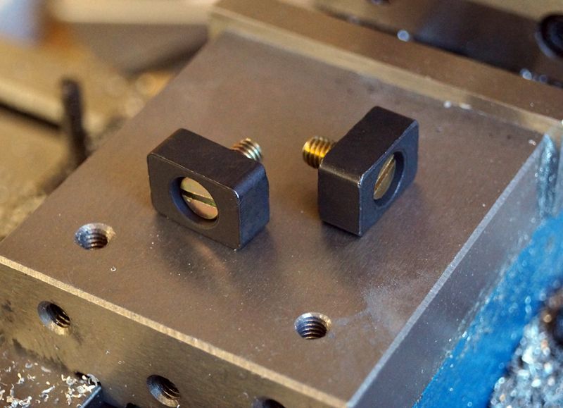

                                            The vice location blocks supplied with the vice are a no go. Compared to the 8mm T nut you can see they would need most of the sides and counter bore milling away. It would be a simple job to modify a pair of T nuts but as Jason said they seem to be pretty hard. Another option I thought of was to take some square steel bar and produce an elongated T nut shaped block which spanned across to both fixings. The fixing screws would need their heads turning down to fit through the table slots. Also the block would have to be removed to fit the vice to its swivel base but thats not an issue.

                                              That tray will catch any oil that drips off the machine, but I find the problem is the coolant and chips that fly off!

                                                I realise that John, I just wanted to catch the drips/runs off the machine, flying swarf/coolant is another issue.

                                                  I forgot SX2 t-slots are tiny compared to the 1/2" nominal slots on the X2.

                                                    Ron, an elongated tee nut does not need fixing to the vice. If you have one you could just fit it in a slot with the wide part (matches the vice slot) upwards and then position the vice over it before clamping the vice down.
