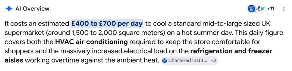

      Whilst shopping in the local Lidl in the heatwave at the moment was just musing as to how much it would cost to cool a shop like that? a day? are we talking £100, 400,1000?
      Anyone have any idea?

        AI says this.
        IMG_2177

          Ruthlessly simplifying and summarising what Mrs Google says :-
          Under UK conditions around 0.5 p per hour per cubic meter of room volume would be of the right order.
          Mrs Google also says that typical LiDL store volumes range from 25,000 to 100,000 cubic metres. So maybe £125 to £500 per hour. Probably more in a heatwave.

            Big-Four format stores are typically incurring £400,000 in energy bills each year. – £1095 per day.
