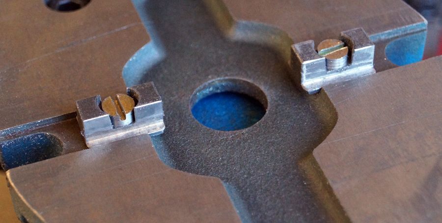

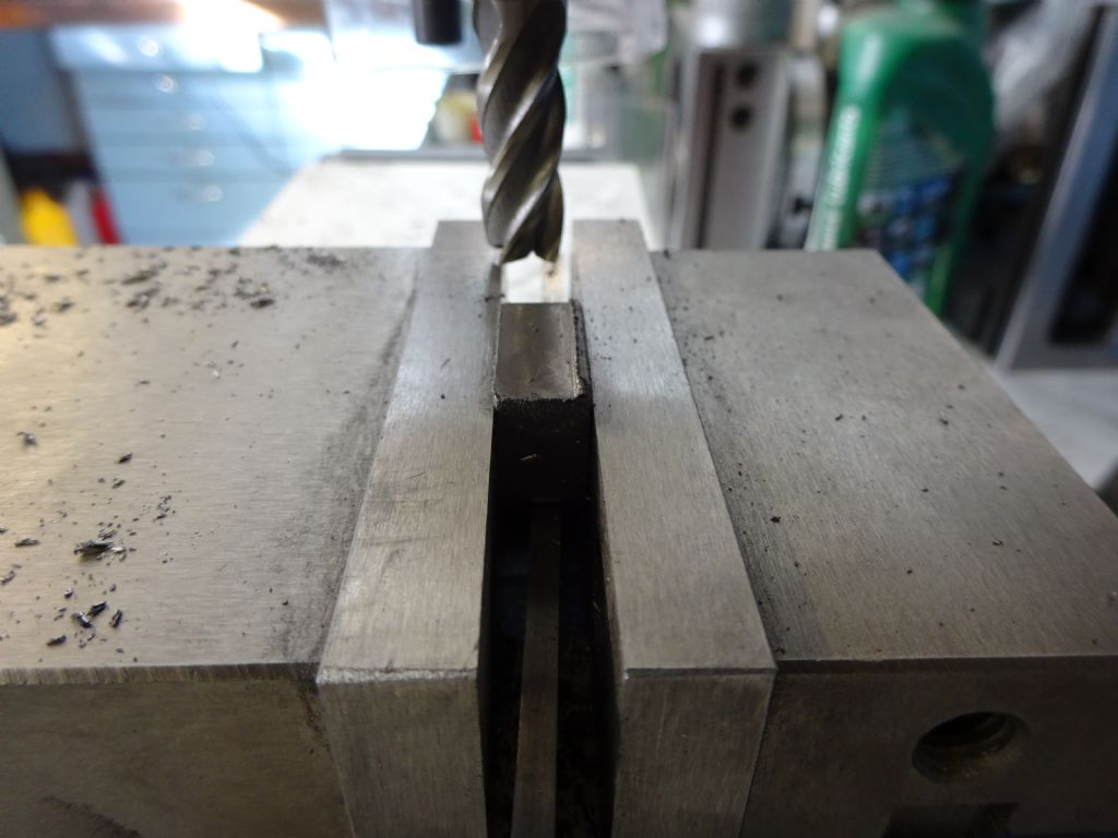

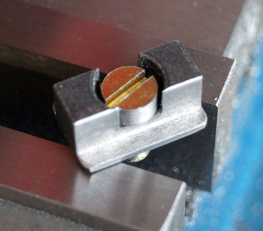

      Ron if you want to machine the locating blocks down to fit your 8mm slots it does not matter if you cat into the counterbore. They are not too hard to mill
      You can also turn down the screw heads so they are a shade under 8mm. or make up a couple of sleeves threaded M6 on the outsid eto fit the vice and M4 on the inside so smaller M4 screws can be used either cap head or CSK
      I took these ones down to 10mm to suit the SX2.7
      Less than 0.01mm runout over the 80mm jaw width. Although I normally don't bother with the location blocks.

          Hi Jason, you were quite right the blocks do machine ok, did one this afternoon. I was going to double up in the vice and do the two at the same time but there is a 3 thou difference in thickness and worried one may break loose so I chickened out and then I got called away so will do the other in the morning.

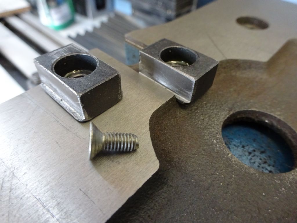

                  Well despite having to reduce the location block width from 14.0mm to 8.0mm they worked out ok, had to increase the depth of the thread in the vice to fit plus turn the screw heads down.
                  A bit of a bonus with the swivel base removed from the vice, a gain of 30mm plus the vice doesnt look like such a big lump on the table.

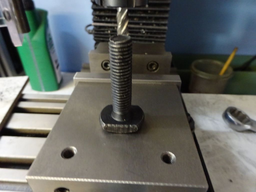

                    For holding the vice I would suggest making some M8 Tee Bolts rather than using tee nuts, studs, etc. A thick turned washer will also be better under the nut than your clamping plates. If you are not sure what the tee bolts should look like just ask
                    Edited By JasonB on 21/10/2018 13:39:13
                    Hi Jason, When you have a minute would you mind showing me how the Tee bolts should look , I do know what the very basic ones look like but wondered if you meant something a bit better.
                    Hope thats ok, many thanks
                    Ron
                    #377079
                      Just something like this Ron, turn from say 20mm Mild steel, thread the end M8 and then mill the "head" down on either side so it fits your tee slots.

                        ‘‘ had to increase the depth of the thread in the vice to fit plus turn the screw heads down.”
                        Shortening the screws would have been easier? Presumably the original threads were deep enough for security?
                        #377102
                        Ron Laden
                          @ronladen17547
                          The mounting holes in the vice were deep enough just not very well threaded, 3 or 4mm short plus what thread was there felt rough. The screws I used are the ones supplied with the blocks so you would assume they should fit, they are not overly long.
                          #377103
                            They are a bit dirty and a bit of a tight fit. I just ran a plug tap into the vice shown above, went in plenty far enough for the supplied screws.
                            #377106
                            Ron Laden
                              @ronladen17547
                              Our posts crossed Jason, I did the same with the plug tap.

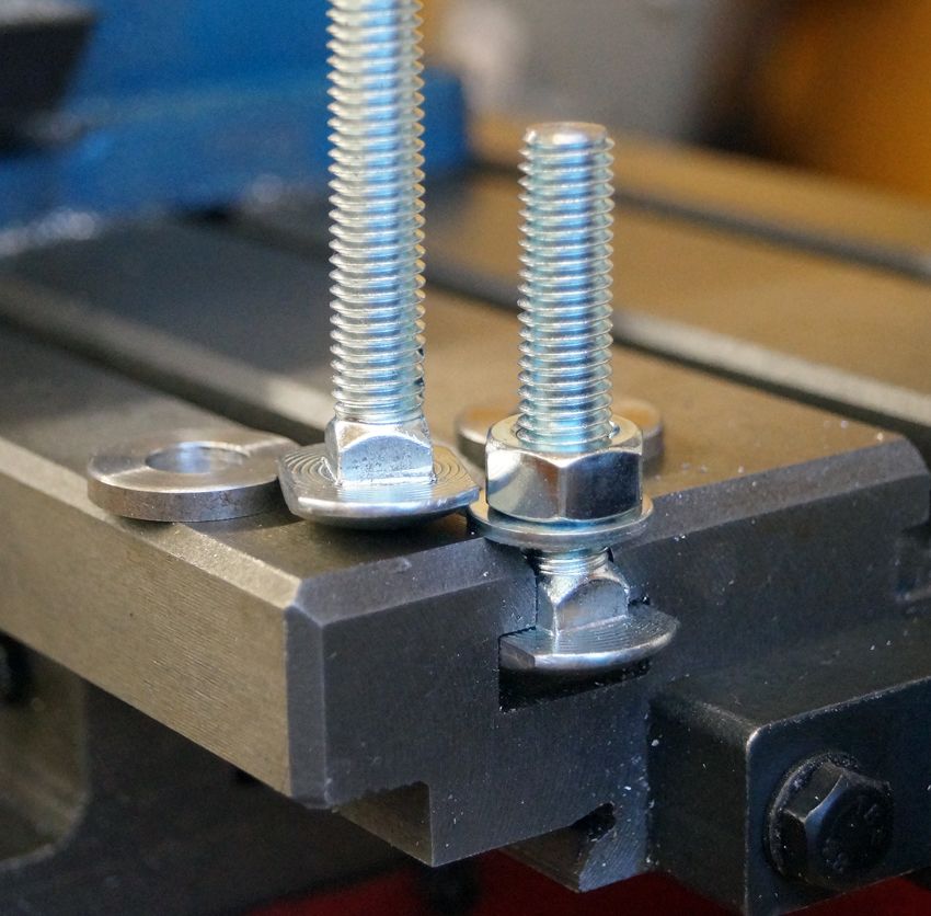

                                    Noticed some M8 carriage bolts in my woodworking box, a quick measure up found the square section at the base of the thread fits the table tee slot. A couple of flats milled on the head and you have a couple of tee bolts. I know that carriage bolts come in numerous sizes, I think for the M8 there is about 30 sizes from 20mm up to 240mm. A selection of sizes could be useful for the clamping set, they only take 5 minutes to mill and they are also available in stainless.
                                    Edited By Ron Laden on 23/10/2018 08:48:19
                                    #377189
                                    Russell Eberhardt
                                      @russelleberhardt48058
                                      Well done Ron. That's exactly what I did on my first mill in order to clamp some material to the table to make some proper T-nuts.
