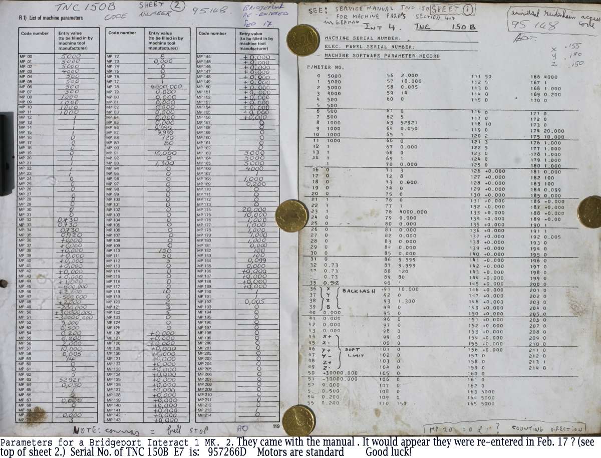

Hello,
I returned to the place where I purchased the Interact from and they had a printed manual which contained the original parameters (golddust ? imo ) for my Interact 1 Mark 2.
They are attached. May be useful to someone. There are 214 parameters.
Tom
