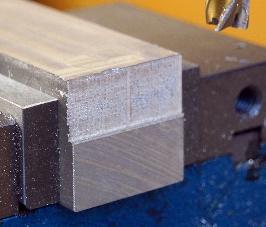

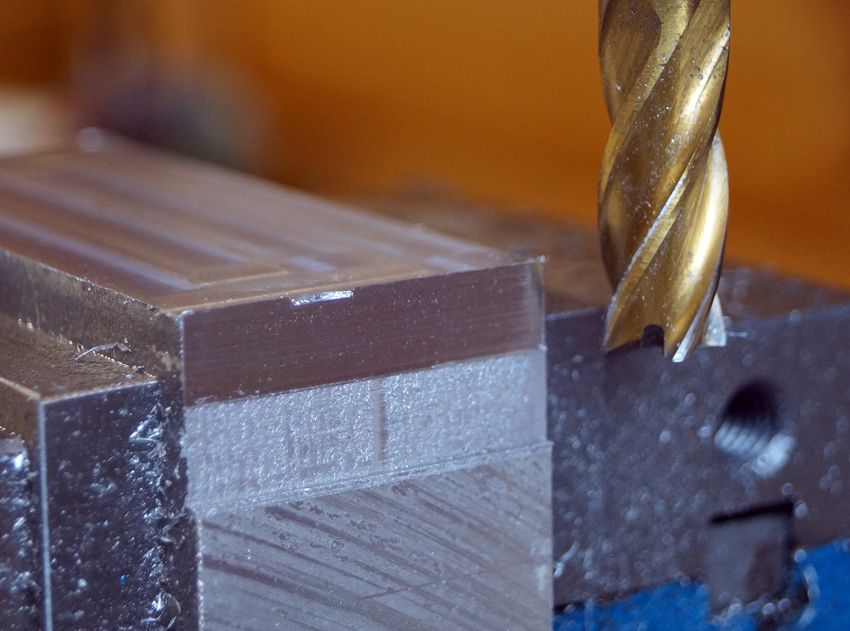

              BUT, some good and some not so good. I set up a length of 32mm square ali bar in the vice and made a start getting in some practice. I was using a 10mm 4 flute TiN coated HSS end mill, I meant to order a 3 flute cutter but forgot and ordered the 4 flute. I reduced the top of the bar with two 1.0 mm cuts and then finished with a 0.1 mm finishing cut. I got a really good finish but I noticed that there is a tiny step between the cuts, not much but I can feel it with a finger. Question: is it ok to run the cuts back and forth or should they all be made from the same direction.
              I then started to face the end of the bar but struggled here as you can see from the photo. I was up milling not down and I tried numerous spindle speeds/light cuts/heavier cuts but I couldnt improve it. Checked everything was tight which it was, the surface finish shows that the cutter is just not cutting correctly. Is the cutter the wrong type for using on aluminium..?
              Ron

                Uncoated cutters are better for aluminium. Look at yours in the picture, the aluminium is stuck to the cutter, so it is not cutting properly.
                You can get the residue off the cutter by careful use of a Stanley knife blade, don't take the edges off the cutter though.
                Cutting fluid will help, paraffin or WD40.

                    Ron, yes, you can run the cutter back and forth. Sometimes you get a better finish up milling sometimes down. That’s what I’ve found at least. Cutting both ways also gets the job done quicker provided the machine/cutter/material will allow it.

                      Just tried again with some WD40 and it transformed it, I was assuming with ali it was ok dry.

                        Thanks Vic, would I be correct in thinking the slight steps between the cuts come from cutting up and down.

                          Posted by Ron Laden on 18/10/2018 09:21:31:
                          Ron
                          Welcome to the world of Learner Driver milling!
                          Your cutter isn't ideal for Aluminium – though they're what I use, you have to keep an eye on them. As David said, Aluminium has stuck to the cutter, which blunts it. Aluminium is a soft metal with a lowish melting point – a blunt cutter, or new one applied at the wrong rpm, depth of cut or feed-rate, or one where the swarf can't escape, will tend to collect Aluminium on the cutting edges and once that starts it rapidly gets worse. Good news – the cutter isn't ruined, but you have to get the aluminium off somehow.
                          As a beginner I thought Aluminium would be a good metal to learn on. Some Aluminium alloys don't machine well whatever you do, and it's generally a little difficult, especially if you use the 'wrong' cutter. With hindsight, I think free-cutting mild steel is more forgiving. My favourite machining metal is brass – even though the splinters are a pain.
                          Don't be disheartened, getting the best out of the mill needs practice.

                              I did exactly the same (tried cutting Ali with a TiN cutter) when I got my mill. Things improved a lot when I got some uncoated HSS cutters for Ali. They cut it like it’s butter.
                              I tend to take the roughing cuts conventional milling and then take the last .1mm climb.

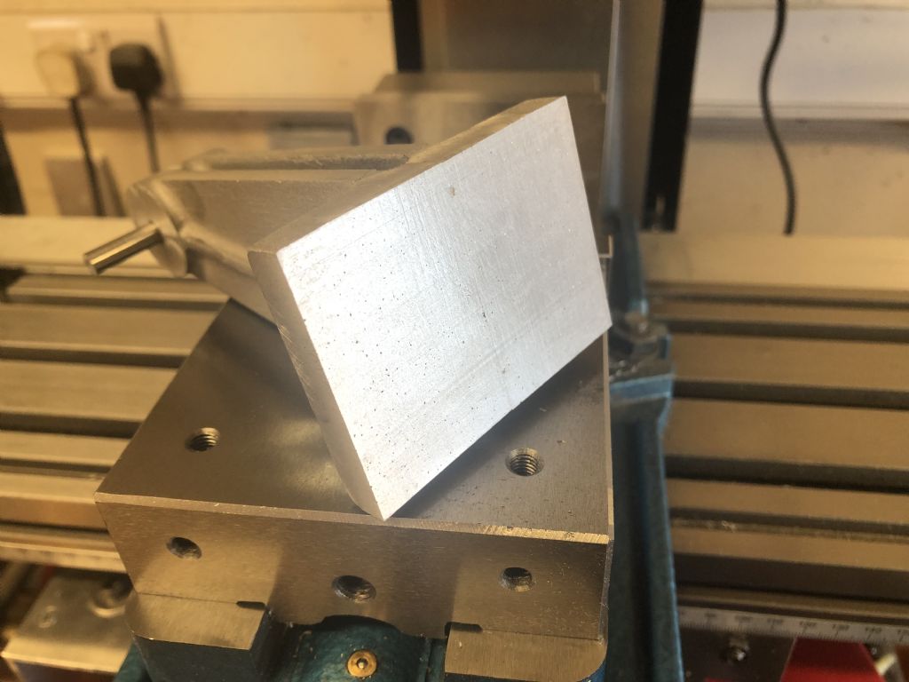

                                          I was up early this morning and managed to get in some practice on the mill, did a bit of a test piece as per the photo.
                                          All done with 6mm and 10mm 4 flute TiN coated endmills which I now understand are not ideal for ali but with WD40 they seemed just about ok.
                                          I tried different cuts/different speeds, up and down cutting, though most of it was done with up cuts as I read that up cutting is probably best for beginners. Holes I did with the 10mm cutter and I used the vice swivel to produce the angle cut. For a first attempt I am really pleased with the surface finish, its not perfect but pretty good.
                                          I really enjoyed making it and although its a simple part, I learned quite a lot in the 2 hours.

                                                Posted by Ron Laden on 19/10/2018 09:09:57:
                                                Looks pretty darn good to me. thumbs up
                                                A few comments:

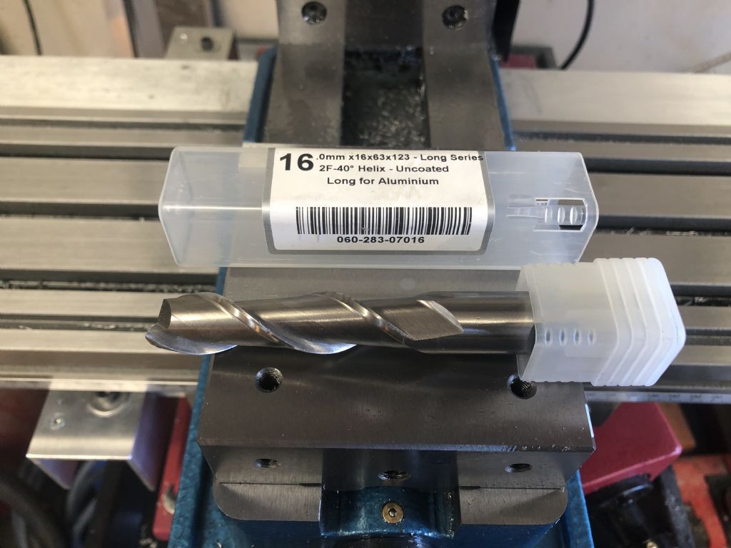

                                                A 4-flute TiN cutter will work fine on aluminium alloy. The use of 3-flute cutters is usually recommended to give extra space for swarf. So as you increase chip loads it might be a good idea to go for 3 flutes. The TiN coating will be ok for aluminium, but isn't needed, so no need to pay for it. More esoteric coatings like TiAlN need to run hot (above the melting point of aluminium) to work so are rather less useful.
                                                The cutters discussed above seem to be long series? Unless you're taking really deep cuts there's no need to use them. They'll deflect more, and you pay for the side flutes so if you're not going to use them it's a waste. From memory the standard 3-flute 10mm cutter I use has a flute depth of around 22mm.
                                                Although not definitive climb milling tends to give a better finish on metals, but not on plastics. It's surprising how big a chip load you can take without breaking a cutter. My mill has around 15 thou backlash and it can grab if I'm over-ambitious, but fingers crossed I haven't broken a cutter yet. I generally leave about 0.5mm for a finish cut with climb milling. It's worth noting that with shallow widths of cut the chip load is much smaller than you might think from the feedrate – search for chip thinning.
                                                Generally I cut every which way, I'm too idle to keep winding the handle back to cut in the same direction each time.

                                                  As Andrew says the long series ones from ARC are not ideal for all jobs particularly as the diameter gets smaller where you may get some chatter when using just the end of the cutter, hopefully Ketan will add some standard length ones to the range. Even on a long 18mm cut like this there is still a lot of unused flute so shorter will be stiffer and allow greater depth of cut without deflection
                                                  In the mean time there are standard length Aluminium specific ones in his carbide range that cut even better than the HSS ones and if looked after will last longer so the slight increase in cost is cancelled out.

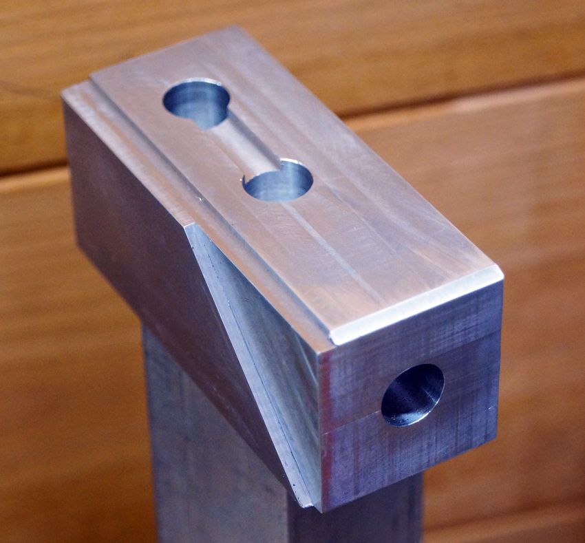

                                                    Jason, a question, how did you cut the radiused sides to the left hand block in your first picture. I imagine you laid it on its side, but what tool did you use.

                                                      Ron, have a look part way down this page for making those parts.
