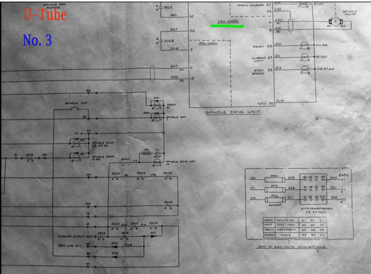

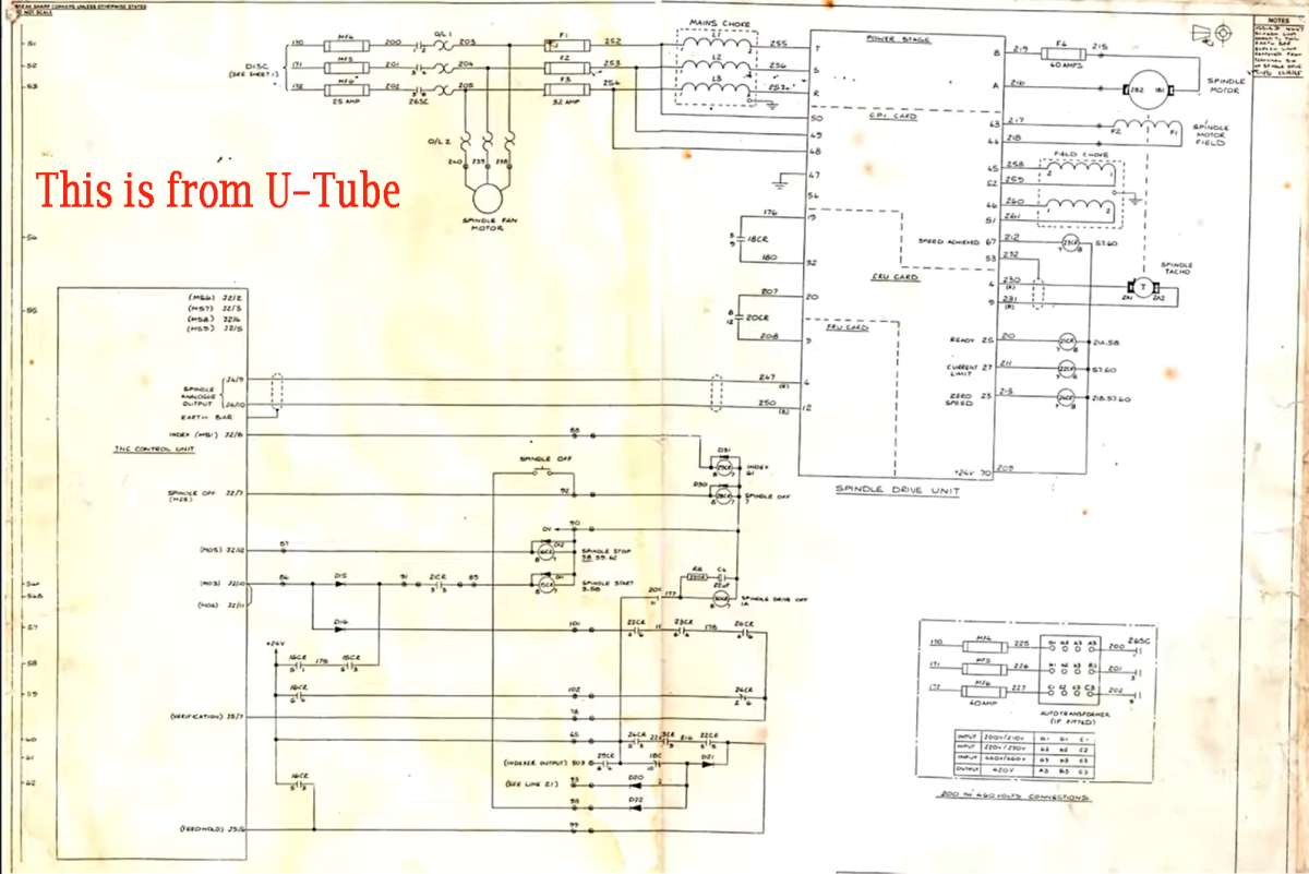

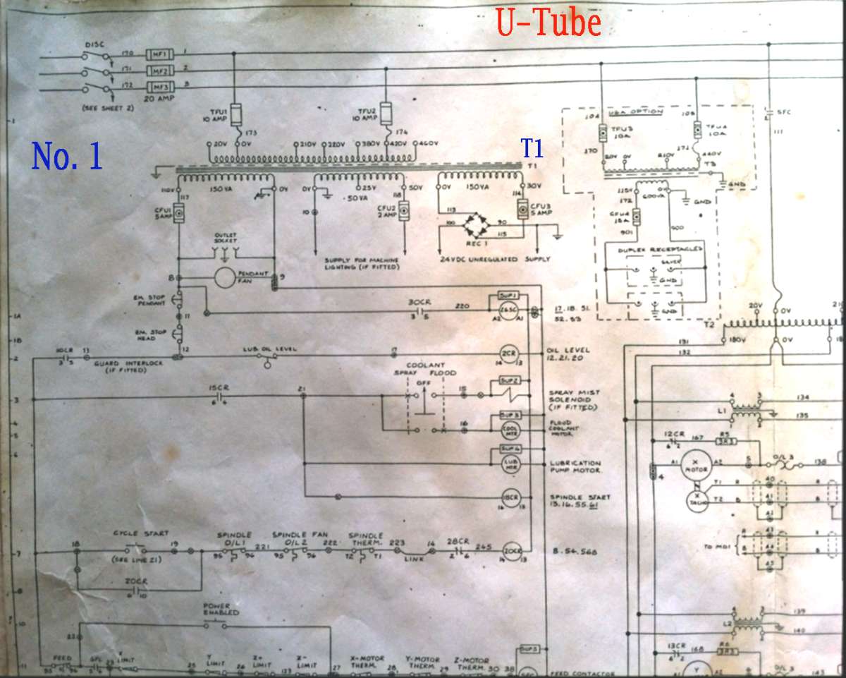

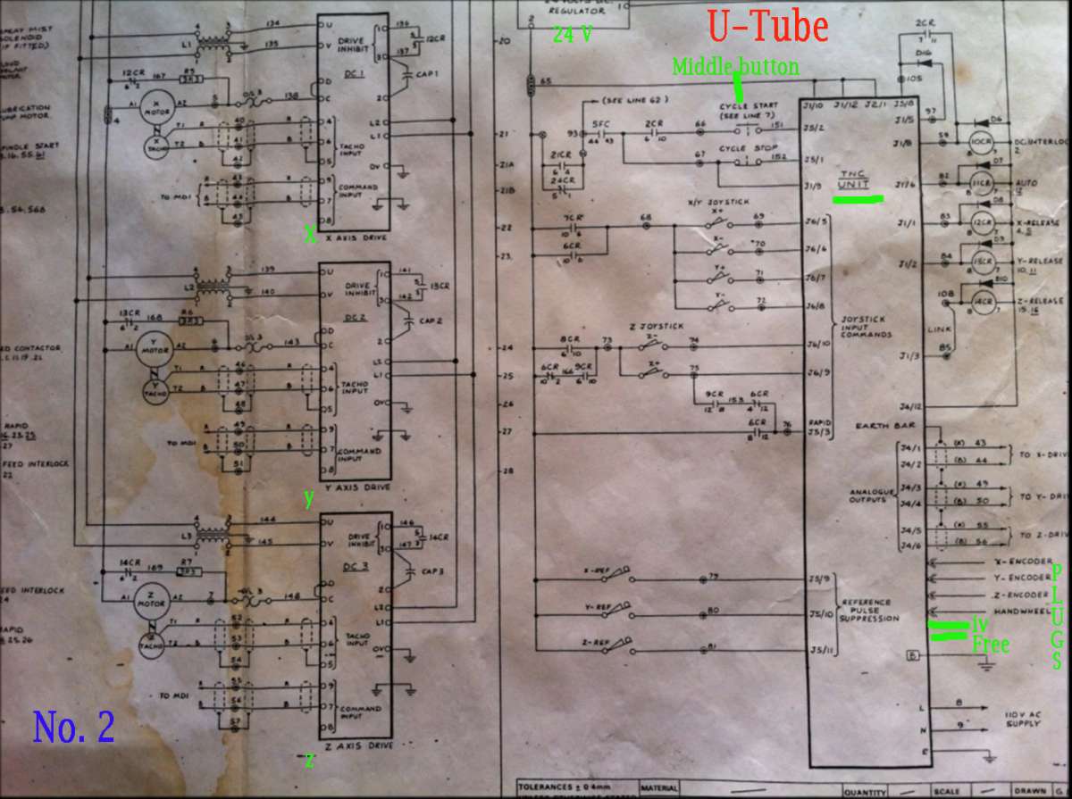

      Hello,
      Google Fuing I found the following diagrams on UTube.
      I grabbed them best I could and converted to JPEG’s
      They are attached. May be useful.
      They may be clearer on UTube but can be frustrating to follow.
      Search ‘Bridgeport Interact 1 Mk2 schematic’  and also ‘Bridgeport Interact schematic’ on you-tube if you want to see them.
      Tried to upload as a zip but system only allows pictures.
      I am not too sure what BP Interact number the last picture (A.JPG) is in relation to. The first 3 pictures correspond with my Interact 1 Mk 2.
      TomNo_1No_2No_3A
