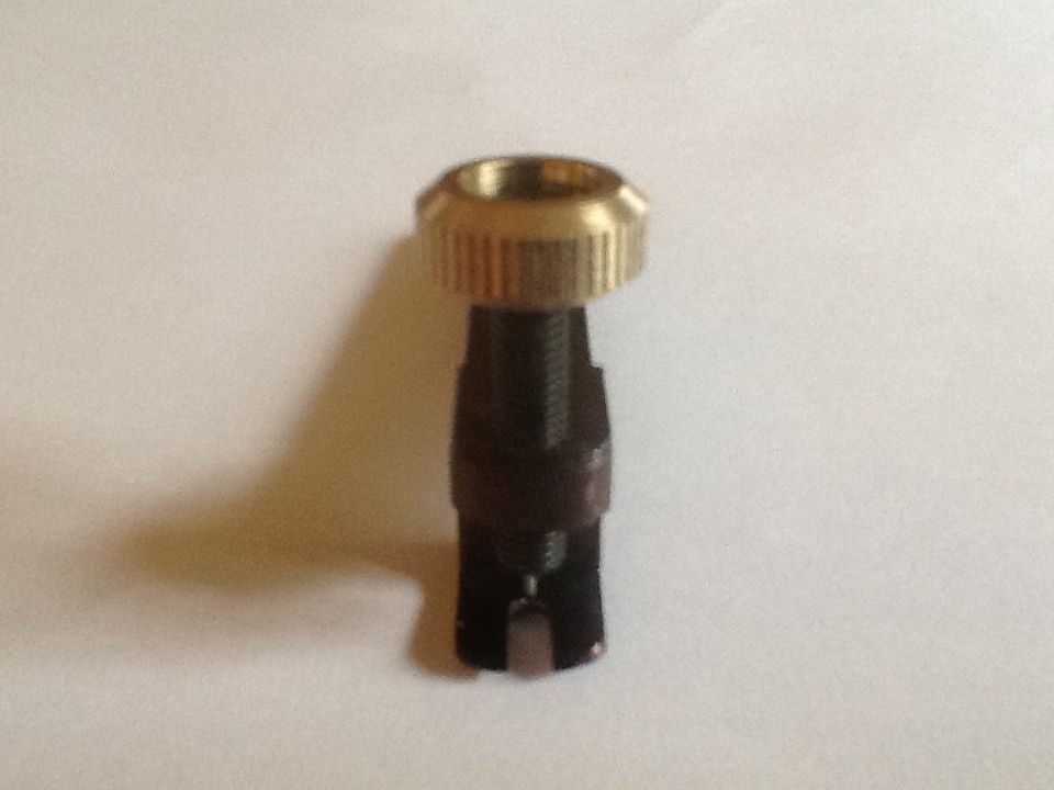

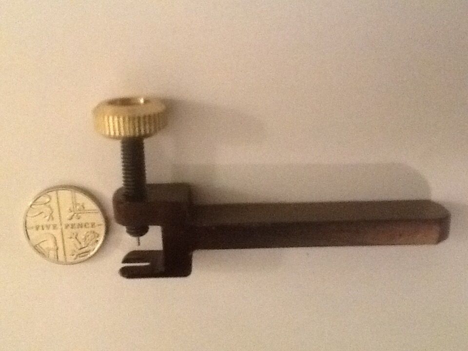

      Can anyone guess what this little tool is used for?
      It's actually a tool I made myself a few days ago, it's machined from a piece of 3/4×1/2 inch key steel. The threaded screw is a high tensile M5 capscrew with a knurled bronze thumb wheel added. The end of the screw is machined to form a tiny pin 2.5 mm long by 0.7 mm diameter.

          Pure guess, it is to remove clock hands

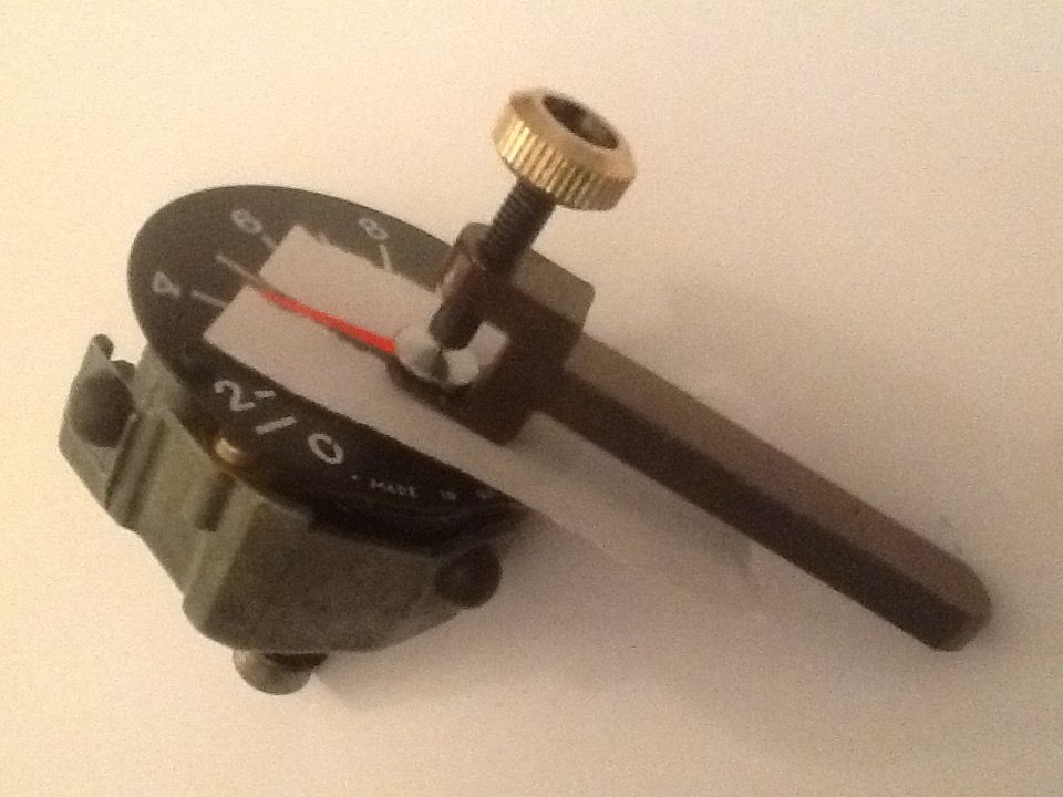

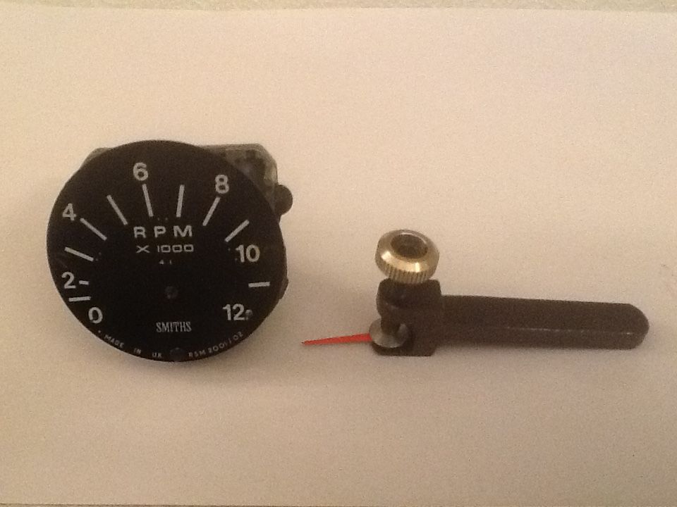

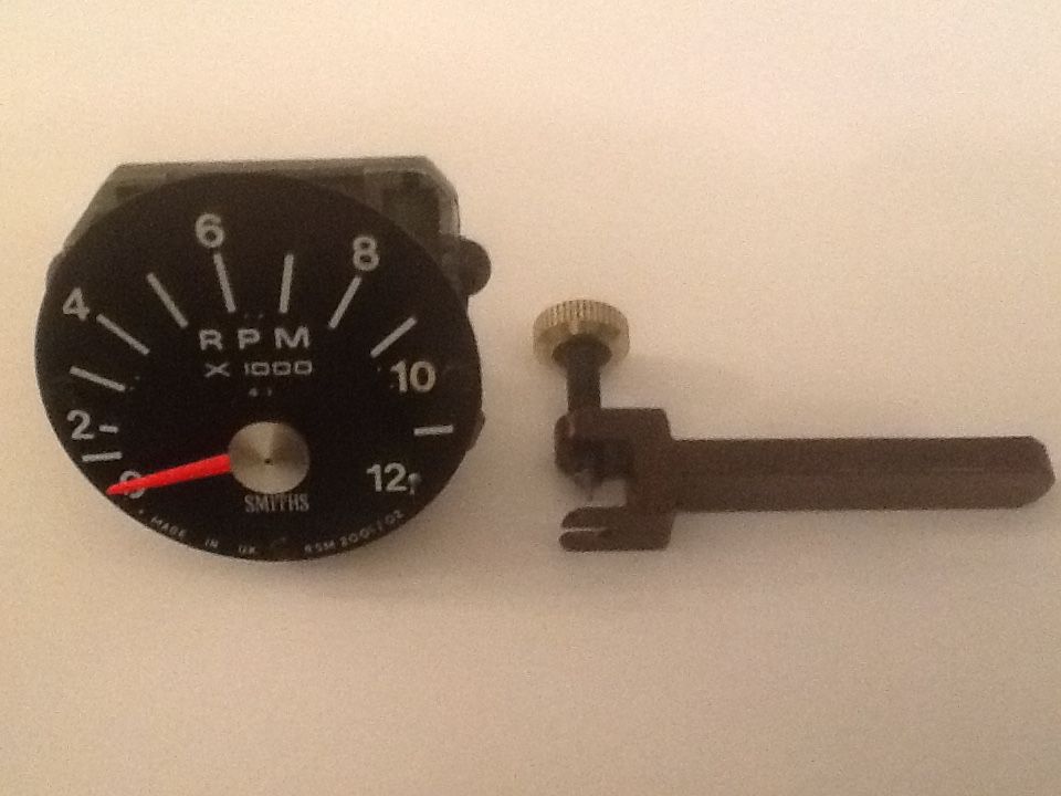

                        Adrian was there pretty quick, followed by a few others. I made this tool specifically for removing the needles on some Smiths speedo and tacho guages for my 1971 BSA 250ss Goldstar.

                                        Yes, you have to question BSA's logic in fitting a 12000 RPM Tacho, and without a redline, onto the relatively fragile B25 engined bikes.
                                        This Tacho and its matching Speedo are the 60 mm diameter type that were also designed for the BSA Fury & Triumph Bandit DOHC 350 twins, they were also fitted to some Ducati singles. There are still plenty of these NOS Tachos about, but the matching Speedo is harder to come by. The Speedo I have just bought only shows 6700 miles but has an alarming amount of wear around the spindle, allowing the needle to slop about all over the place, although the rest of the internals are in excellent condition. The only reason I dismantled the perfectly working Tacho was just to see how the needle spindle was supported, so I could then attempt to repair the Speedo.
