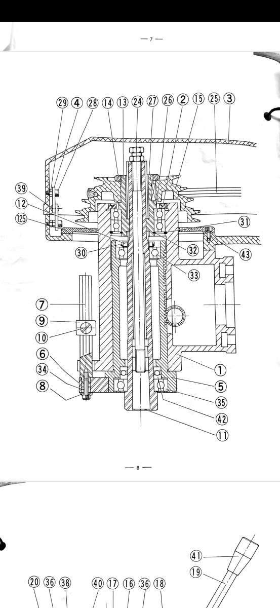

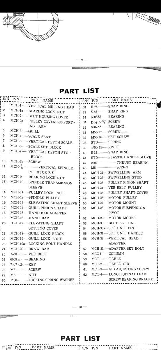

                              Just incase anyone interested this the drawings of quill.Screenshot_20250611_182508_Adobe AcrobatScreenshot_20250611_182512_Adobe Acrobat

                                  I would think that you would need very little preload with those bearings. There is something between the bore of the quill and the top of the outer race of the 6207ZZ (35), but no mention of any shims in the parts list. It might simply be the way the diagram was drawn.
                                  If you can start by fitting the 6207ZZ to the spindle by only pushing on the inner race, and then lubricate and fit the thrust bearing. Then fit the top bearing 6206ZZ (33) to the quill pushing only on the outer race. Then fit the spindle assy to the quill pressing on the outer race of the bottom bearing, the spindle should not be a tight fit in the top race.
                                  Washer 30 may have an inner bit to sit in a keyway in the spindle followed by nut 12 which may not need more than 1 ftlb torque. Hopefully you will be able to find some information about preloading which may not be the same as taper rollers.
                                  Check the pully bearings while the mill is in bits.
