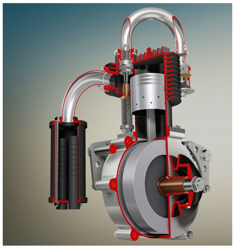

      I have been scratching my head for a while now so I thought I would come and ask the experts…
      I am planning on building an engine, the original plans of which can be found here:
      https://archive.org/details/motorbicyclebuil00hasliala/page/66
      I am concerned that if I purchase a Myford 7 lathe then I will be exceeding the Myford's maximum capacity.
      The engine crankcase measures roughly 9" in diameter by 2" in depth.
      Does anybody have any practical knowledge as to what I can safely squeeze in without resorting to a homemade spindle raiser?

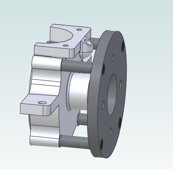

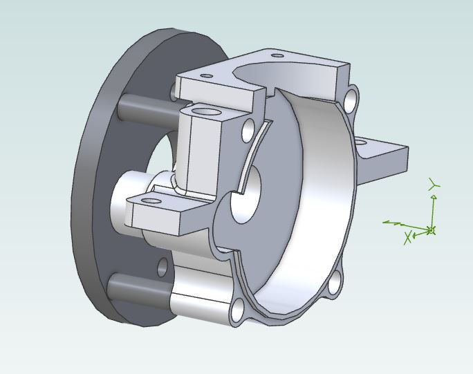

                                        As I hinted to earlier the crankcase halves are not too difficult to hold and you don't need any large faceplates or chuck to be able to hole them.
                                        The trick is to first tap the bolt holes and then with the use of stand-offs the casting can be screwed to a machining plate or disc that is in turn tapped to suit the spacing of your faceplate slots. Something like this would fit a 7" faceplate and 8"+ part, the central hole in the plate could even be made large enough to accommodate the bearing housing to keep projection as small as possible.

                                        Similar setup on this cylinder head to allow for the rocker arm post

                                                @ JasonB
                                                Thank you very much for taking the time to post the screen grab of the crankcase machining process. The book calls for a 4 jaw chuck but I think I prefer your approach. I also see somebody else has Solidworks
