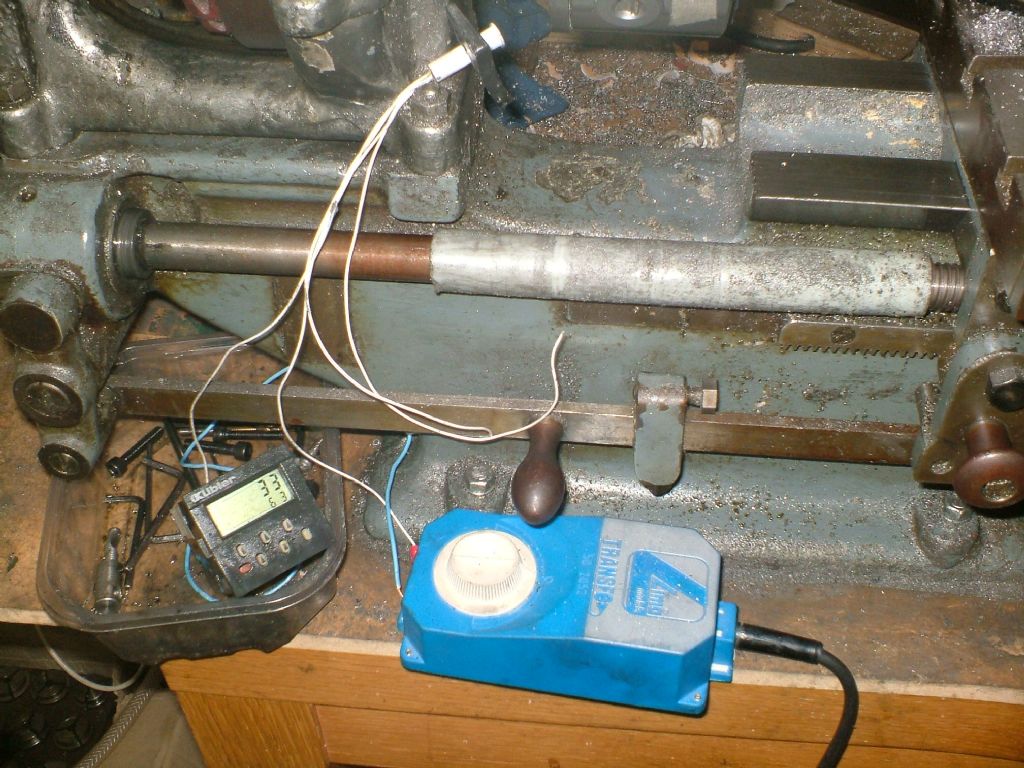

          The other digital aid isn’t so obvious but might come in useful for a couple of fellow lathe bodgers.
          Like everyone else I’ve been watching the screwcutting thread with interest, but in my case I already have a leadscrew clutch.
          The problem is I couldn’t previously thread constantly under power, even a 20tpi (20t/50t-8tpi leadscrew) has a double start and needs to be manually reset.
          My solution was this thing.
          It can count backwards, is battery operated and needs a 12v min switch.
          So by using the tailstock as a backstop and a revolution counter I was not only able to thread a 20tpi but also able to thread metric(10x1mm) constantly under power.
          The counter tells you when the correct clutch re-engagement point is coming up.
          Edited By ady on 19/09/2011 11:56:16

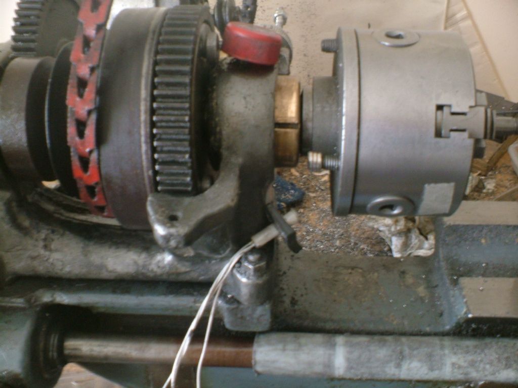

            A magnet on the back of the chuck triggers the counting switch, so you always know the exact relationship between the carriage/leadscrew(which is up against its rear backstop) and the headstock.
            For anyone who wants to thread jamjars this also means you can do a multi start thread without ever stopping the lathe.
            I got lucky with the Kubler 901 because it’s not only battery operated but it counts backwards from a preset number (usually the required tpi) and I found one going cheap, (they are about 100 quid each new).
            I’m not very keen on 240v wiring being draped around a working lathe so I wanted battery operated, like those bike computers.
            The batteries however are those half size AA lithium ones for photography, 8 quid for two! They are meant to last at least 5 years, which is about how long it takes to get over the shock of buying them.
            The blue thing is a 12v transformer from a train set for the switch counter, and threading is done with the backgear engaged, it’s too fast under power lol.
            If nothing else, hopefully I’ve given a couple of folk ideas for themselves.

                I am not totally clear how your system works. When you refer to the clutch do you mean the half nut engagement with the leadscrew or is it a clutch between the leadscrew and the last gear in the gear chain. If it is a clutch is it a dog clutch which only engages in one position per revolution or does it engage at any point ?
                    It’s a single point dog clutch at the end of the leadscrew.

                      This is my assumption of how your system works. You start off with the carriage in contact with the tailstock the clutch disengaged and the spindle turning. You engage the clutch and note the counter reading when the clutch engages. When you reach the end of the thread the clutch is disengaged either manually or by a trip. You then retract the tool and return the carriage to touch the tailstock by turning the leadscrew by hand. Then move the tool back to take the next cut. Then (With your example of a 20 TPI thread.) watch the counter and when it reads a multiple of 5 counts difference from the starting count re engage the clutch. Is this assumption correct ?
                      Les.
                      #75172
                      ady
                        @ady
                        That’s the “principle” both starting points are the same for each pass.
                        It’s not superfast but it works well.

                              Does the display count down from the preset number to zero then wraps round to the preset number again or does it then start counting down from 999999 back towards zero ?
                              Les.
                              #75185
                              ady
                                @ady
                                It counts down from the preset, then repeats.
