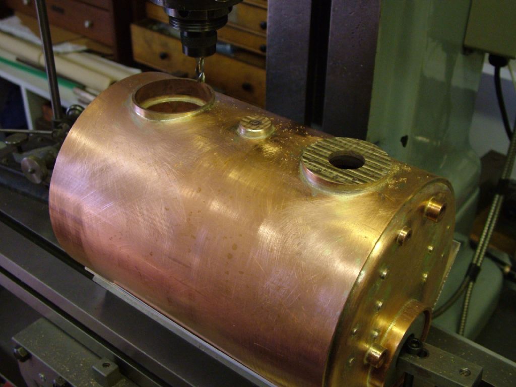

            Hello Doc, You may be interested in seeing this
            I rebuilt this boiler some time back and fitted a new dome bush. Despite being careful it was not true to the vertical so had to be faced. As you can see, in order to get this as flat as possible I used a new 6mm FC3 cutter and stepped over taking the final cut in both directions
            The dome that fits atop has a 2 mm Viton O ring for a seal so when I pressure tested it at 100psi and it seeped at this joint losing about 5 lbs pressure over 10 mins or so I felt the O ring groove may have been cut a tad too deep.
            When I removed the dome to redress this I was surprised to find I had not fitted the O ring at all – the metal to metal surface taking that pressure and fundamentaly holding.
            As said before the machining marks do not/may not look as cosmetic as a flycut surface but you can be sure that it is flatwink If the surface needs to be flat off the machine then this is much the better option. Stepping a fly cutter over as Jason suggests may be an option but it rather defeats the idea to my mind
            Regards – Ramon
