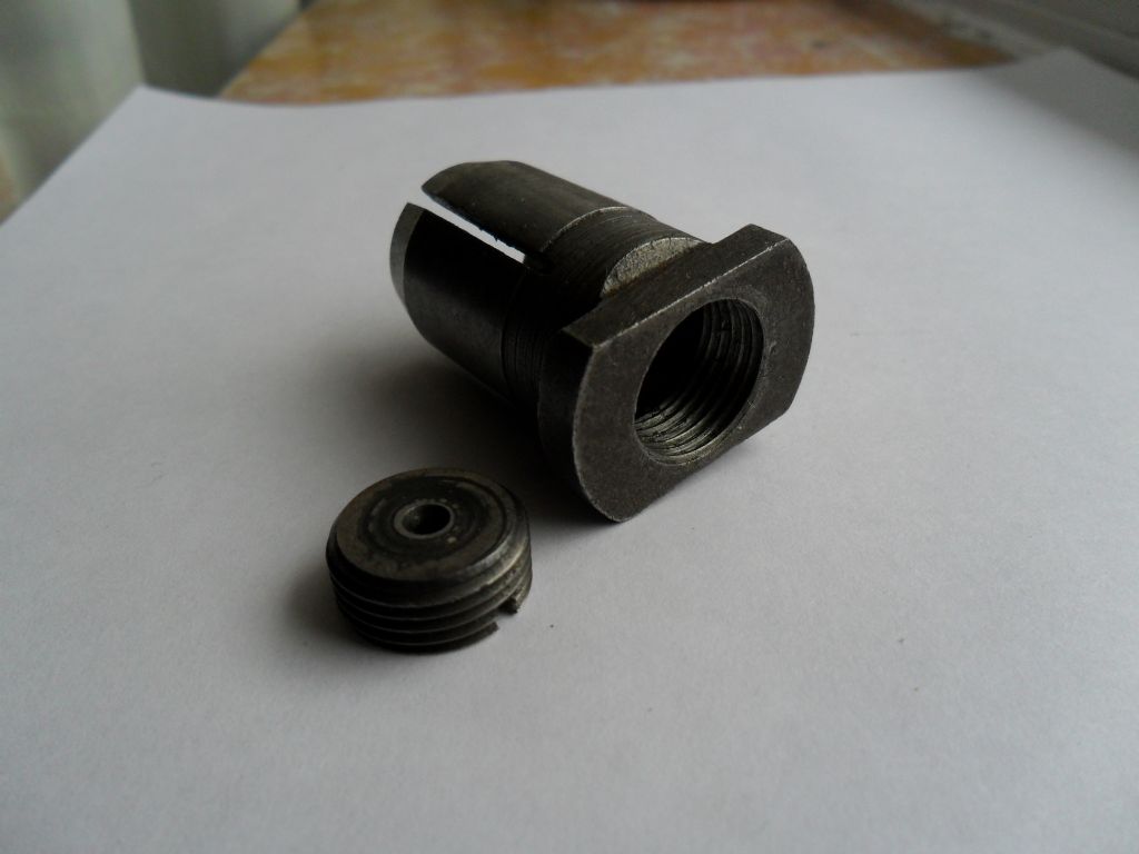

                                  #156708
                                  Nobby
                                    @nobby
                                    Hi
                                    Here is a little tip for the home shop machinist make some of these dummy centres so you can use plain cutters .Notice slot
                                    in an Autolock
                                    NobbyAutolock
                                    Edited By Nobby on 30/06/2014 17:24:24

                                        Nobby: Sorry, I am being very dim here, what are those parts for please?
