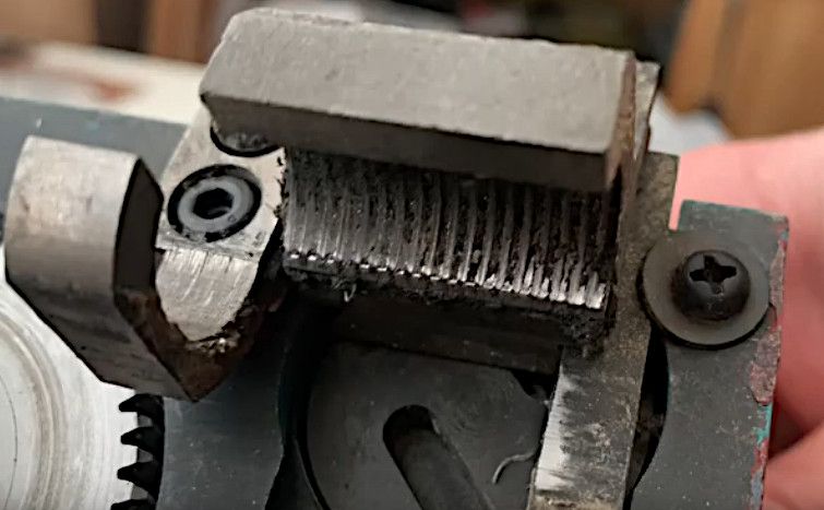

                        Journeyman
                          @journeyman
                          This is a still from the recent video:
                          Firstly the half nut is full of crud and needs a good clean. The block on the right, retained by two Phillips head screws and bent washers is loose. I am assuming this is some sort of gib strip and needs to be adjusted so that the half nut slides smoothly up and down. At present the half nut is waving about up down and sideways it all needs disassembling, cleaning and the putting back together with the gib strip properly adjusted although I can't quite see how the adjustment is made, presumably a couple of allen screw on the right hand edge. The whole thing is a fine example of poor engineering (sorry).
                          Once that is done the guide on the left needs adjusting so that the lead screw just bears on it so that it prevents the leadscrew deforming when the half nut is engaged. Although again I can see no easy way to make such an adjustment.
                          Good Luck
                          #526198
                          Howard Lewis
                            @howardlewis46836
                            Cue my favourite cleaning tool for threads! A clean toothbrush. If that fails resort to a small wire brush.
                            Once every thing is clean the half nut can be adjusted, and perhaps attention can then be focussed on setting up the changewheels to provide a fine feed for turning the pen bodies.
                            If the 20:80/20:80 feed rate is still too coarse, Neil Wyatt had a program to 3D print 100T gears, I cut mine, but the gear cover needs to be modified to clear the 100T gear on the stud. This provides a feed rate of 0.06mm per rev instead of the standard 0.09375 mm per rev..
                            Howard
                            #526206
                            Darren Keats
                              @darrenkeats48928
                              Ok , firstly thankyou howard Lewis & journeyman 👍🏻
                              its an axminster sc2 btw
                              i cleaned out the half nut threads with a metal pick , it was full of hardened crud!
                              the bars with 3 Allen bolts were both loose , but i think this needs attention after.
                              i put it back together and now its working , but i messed with the gib screws and need to set these back again
                              when i engage the feed now it sometimes clunks a bit , but i think this is a gib screw adjustment issue?
                              i will take you suggestions on the gear changing that should suit pen blank turning , time to figure this out now as never done this before , i think i have some alternative gears
                              #526207
                              Darren Keats
                                @darrenkeats48928
                                Posted by Journeyman on 10/02/2021 16:34:31:
                                Good Luck
                                yes i agree ,it needs disassembling, but im not confident on getting this adjusted correctly
                                #526216
                                Bazyle
                                  @bazyle
                                  From the video it seems to be rather clunky in operation due to dirt and lack of lubrication. There may be some burrs on the sliding parts which will be apparent when you strip it for cleaning. Round off sharp edges of the slide bar as they will promote grabbing ditto the slots in the rotating member and see what state the pin that engages those slots is in.
                                  I can't see the actual state of the thread on the half nut but when it is off you will be able to feel how well it grips the leadscrew.
                                  The pressure plate that bears on the top of leadscrew doesn't look like it is designed for easy if any adjustment. If they just relied on its position being 'good enough' when made to drawing it may need modification to allow adjustment.
