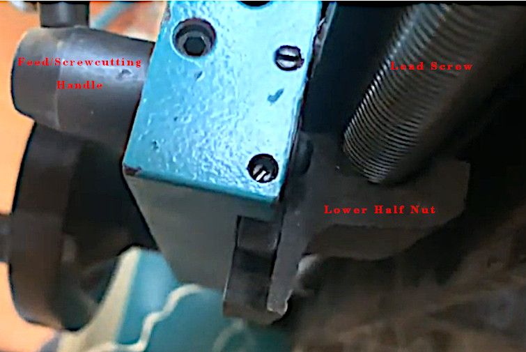

        Hi again, ok after fixing the potentiometer with your help i now have an issue with my feed . The long screw bar turns , but when i lift the lever it does not engage and move along like it should . I can move along with the wheel but not the automatic feed

            Either the lever is not engaging the half nut  ( not adjusted correctly ) or the half nut is worn

                              Just so that Darren can get to grips with some of the terminology this picture is taken from his video when trying to engage the feed or screw-cutting handle (lever)
                              It seems that the half nuts are not travelling full distance although the video is too dark to see if there is actually an upper half nut, if there isn't that might explain the problem!

                                Almost immediately behind the lever is a threaded clamp thingy that engages with the leadscrew when the lever is operated. The 'nut' is in two halves, and working the lever brings them together to mesh with the screw with a kind of scissor action.
                                It's hidden behind the apron, but you should be able to peer at the clamp from the side &/or underneath to see what happens when the lever's moved. One possibility is that the lead-screw isn't parallel with the top of the bed, too high and too low both cause failure to engage. The tail-stock end sits in a height adjustable block, which is easy to move deliberately or accidentally.
                                The mechanism is quite robust but they can get out of adjustment or wear out. Probably an adjustment fix unless the lathe has had a hard life.

                                    If you look at Journeymans photo you can see a couple of slotted screws, These act on a crude dovetail which constrains a slide which the half nut is worked with. I find that these screws come loose and prevent the nut from locking in place. It is a bit of a fiddle to get this set up right but I find that this is what is needed most of the time. At some point I will take mine off and do something more positive with it. Despite the swarf aspect I think two half nuts are better than one

                                              There is no top half, just this lower part of the half nut . Maybe its stuck above but i cant see it?

                                                    If there is a swarf guard over the top of your lead screw there may only 1 half nut fitted.

                                                      There is no top half that i can see . It must be stuck up out of view as it has been working up until today
