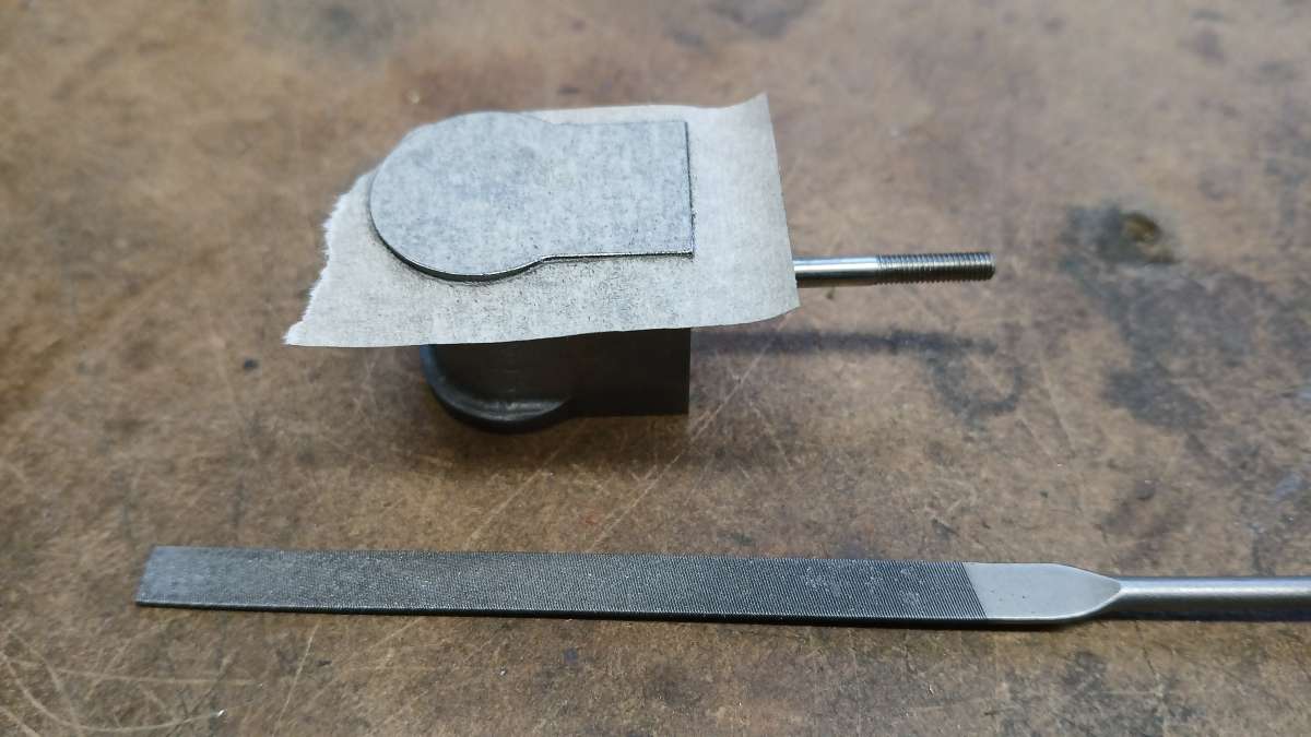

                    Yes, just like a 3D printer if you want anything that is not available as a download you need to be able to produce a CAD file to get what you want. Need not cost anything but you will need to learn though flat gaskets should not be too complicated.
                    Myself I tend to use  aliquid gasket on my IC and stationary engines.
                    For thin paper like you get on model aero engines then holding the paper on the actual metal part and drawing a needle file backwards over the edge is quite an effcetive way to cut to the required shape, I do that for masking when painting. Similar to Fulmen’s method but won’t bruise the diecast alloy
                    20251129_090046
                    As for hole you might want to consider one of the small punch & die sets that the plastic model guys use, they work much like a hole punch for filing A4 paper but have a range of small sizes. Loads on the web if you google but this sort of thing which you could even make.
