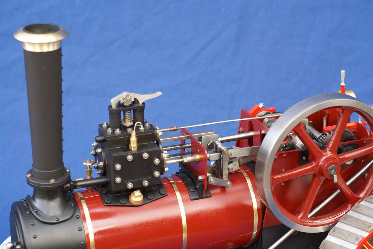

      nothing like an Allchin cylinder and a sposted above the boiler diameter seems larger. Th eregulator being off toth esid eis quite unusual normally there is a cavity on t hetop of te hcylinder for the regulator so that may help eliminate a lot of possible engines.
      Looking at those cylimnder photos the only bit I would say for sure is cast is the rear facing cylinder cover. The rest has been machined all over so who knows.
      The fact that the lower curved saddle is separate makes me doubt even more that it was from castings, at the very least it has been adapted for parts that don’t really fit. The thin side flange under the valve chest is also a bit of a weak point and combined with too few bixings into th eboiler unlikely to end happily.
      Looks like the front may be tapped for  ablower but where is the exhaust? Does it come out under the valve chest, certainly not hole in the chimney saddle for it to be plumbed into so no blast pipe.
      A couple of typical traction engine cylinder showing the number of fixings and how the flange extends front & back not just at the sides like yours.

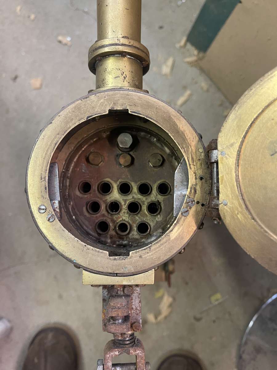

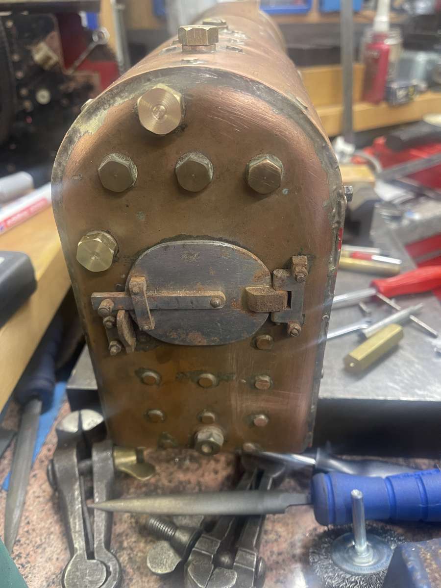

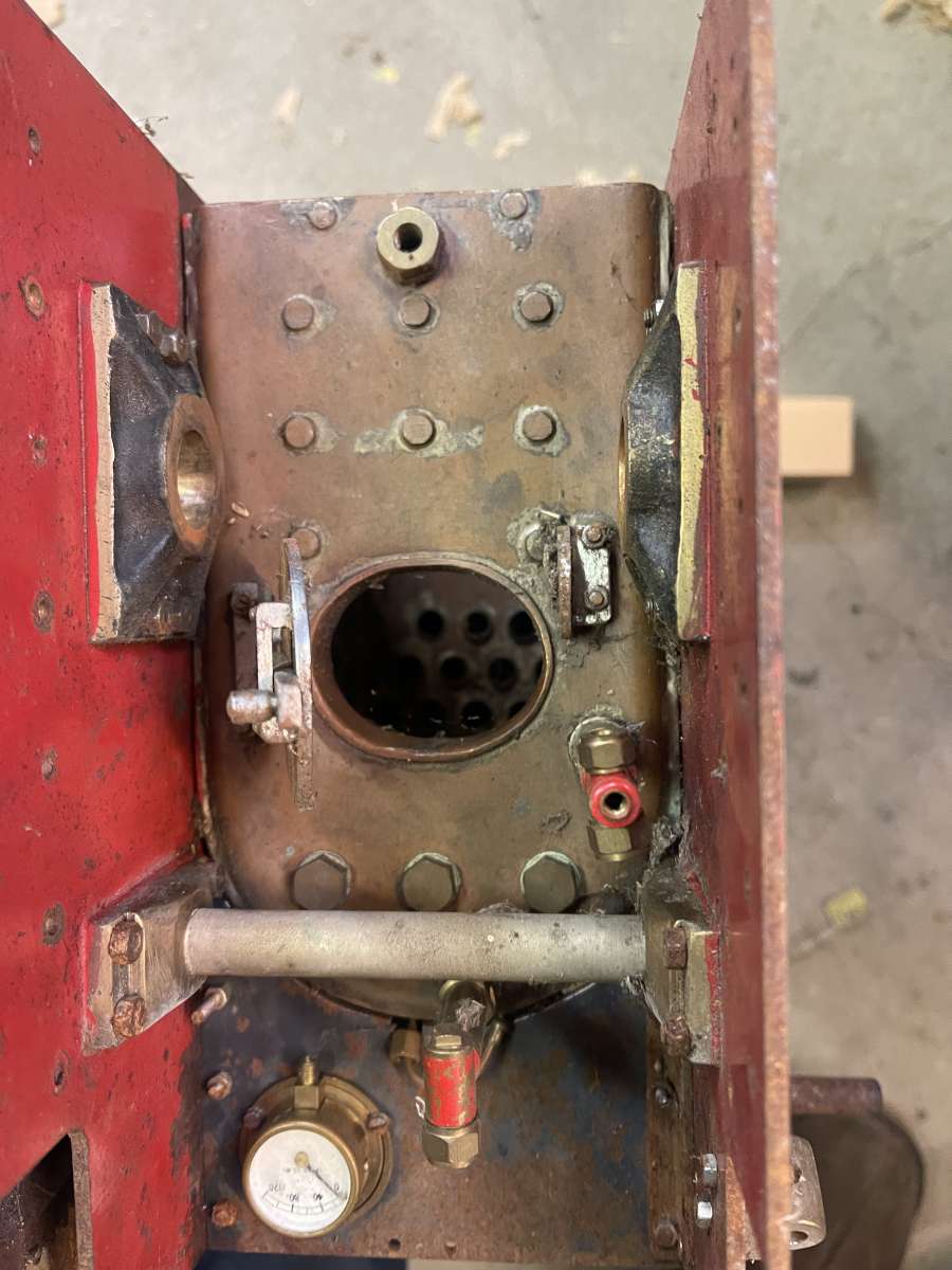

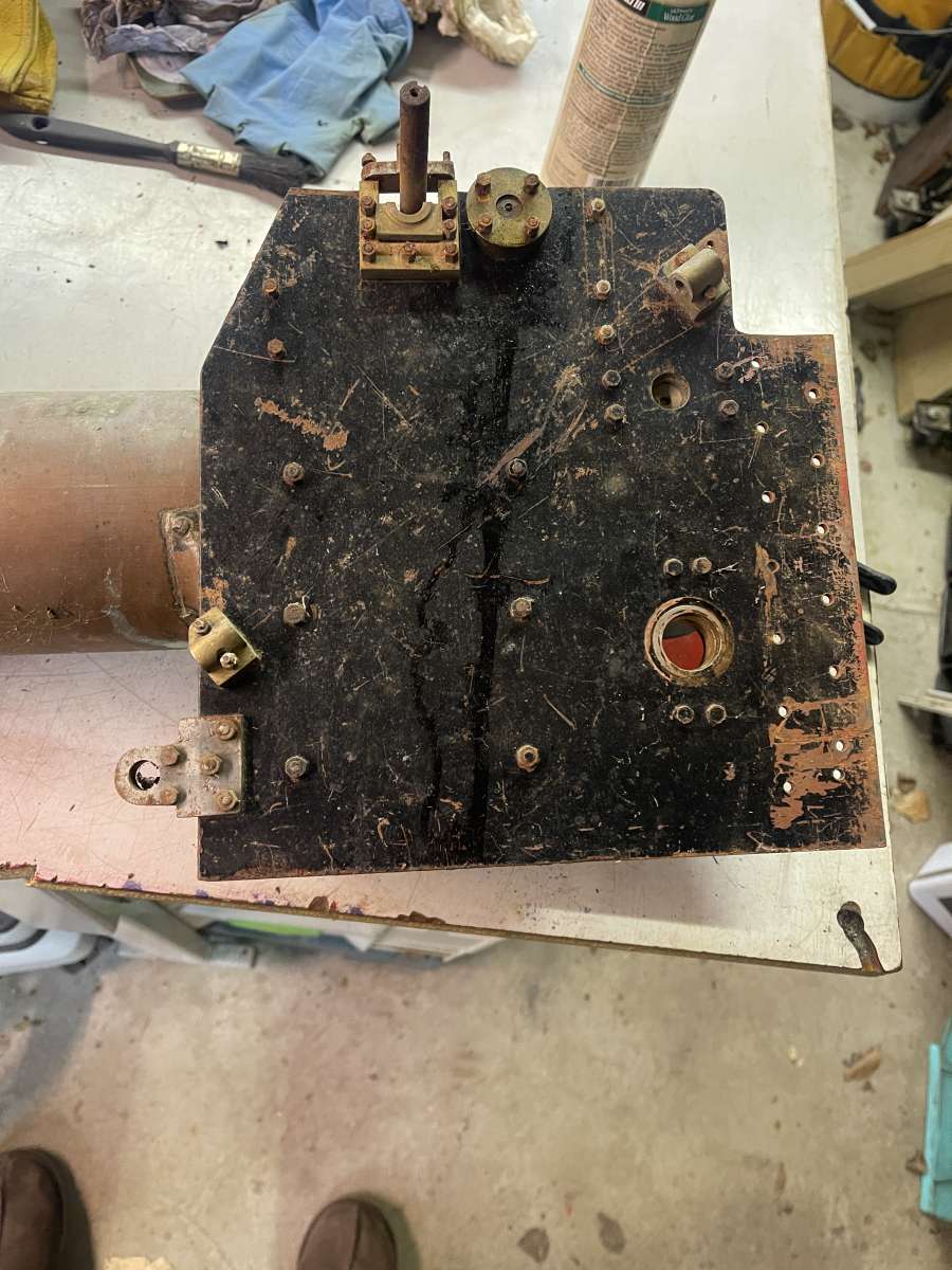

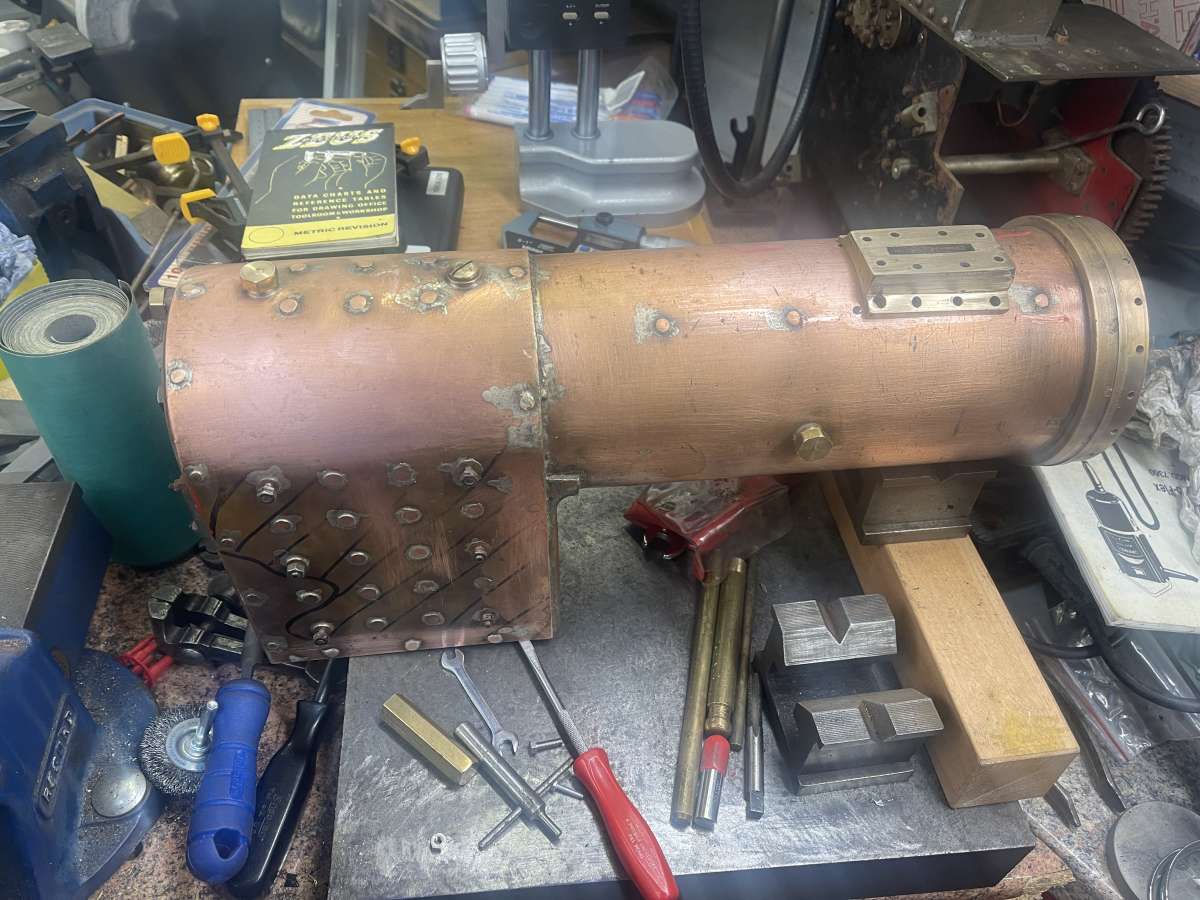

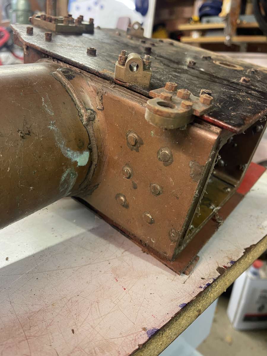

          I have just got the pictures of the boiler, the size of the outer dimensions do seem close to the Alchin 1.5 Royal Chester,
          the barrel thickness is 3/8″ where the saddle fits and the boiler is as near as can be to 15″, the inside diameter of the boiler is 3 3/4″IMG_1632IMG_1640IMG_1633IMG_1639IMG_1637IMG_1635

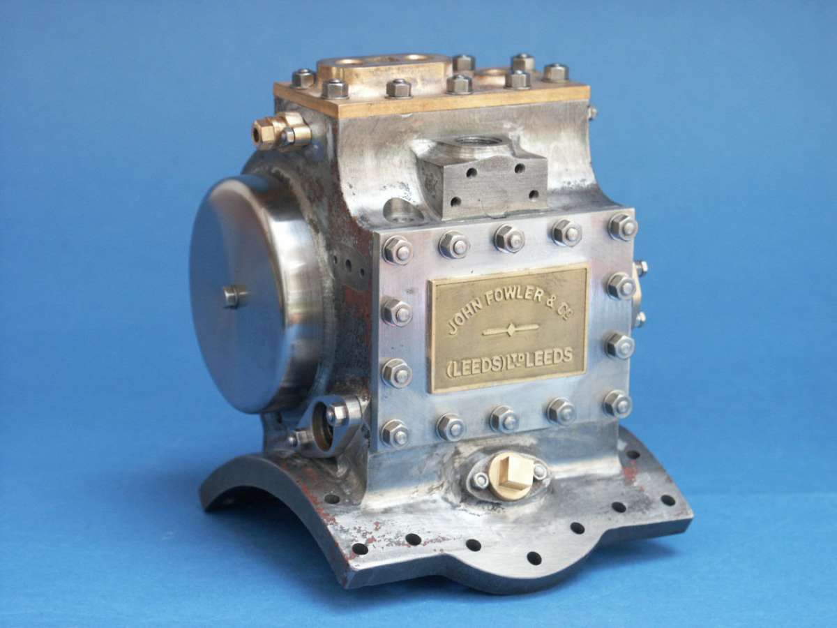

            What are those faint words on the valve-chest cover? Is one, “Ruston”?
            Regarding boiler-testing, if you intend steaming it, I don’t think lack of design calculations necessarily a stop, provided the boiler is sufficiently close to other, known designs and the workmanship looks sound.
            It is not possible to be definite from those photographs but there seems a fair absence of silver-solder runs, so suggesting good-quality silver-brazing. However, unless an optical illusion, the backhead flange seems very deep, and I wonder how much of that is actually within the shell. Again, hard to tell but by rough comparison the shell thickness look about right, bearing in mind its duty on a traction-engine is far more onerous than its railway equivalent.
            The most fallible points are the firebox plate thicknesses, and the presence or absence of adequate stays. Also the arrangement for holding the cylinder to the boiler – as Jason pointed out a while back. With the cylinder now detached you can ascertain what is there.
            Structurally the weakest section of a locomotive-type boiler is not the cylindrical shell but the big flat areas of the firebox, hence the need for adequate staying – but unlike on a railway-locomotive whose boiler sits on the chassis, a traction-engine’s boiler is the chassis, putting considerable strain on the throatplate and its joints.
            Assuming so far the boiler is potentially useable, it should be tested as if new, i.e. a 2X working-pressure hydraulic test. In effect it is new – it has never had water and fire in it.
            Not straight off though. A careful visual examination first. If that is satisfactory, gentle hydraulic tests in stages to working pressure only. If it shows serious seam leaks or other distress at working-pressure or less there is no point going higher: it would need either repairing… or replacing.
            Only if it is happy at that we can consider going up to the safety-factor level.
            That 2WP level is first-time only. The repeat hydraulic tests are to 1.5(WP), 4-yearly for a copper boiler. Under the standard MELG scheme– commercial testing is different.
            Once the working-pressure is known, mark the pressure-gauge indelibly at that. If the case cannot be opened to put a line on the dial without risking wrecking the instrument, a mark, preferably engraved, on the bezel is allowable.
            Carry out those tests yourself, before deciding on a proper, third-party inspection. If it fails there is no point bothering other boiler-admirers, except for advice on repairability.

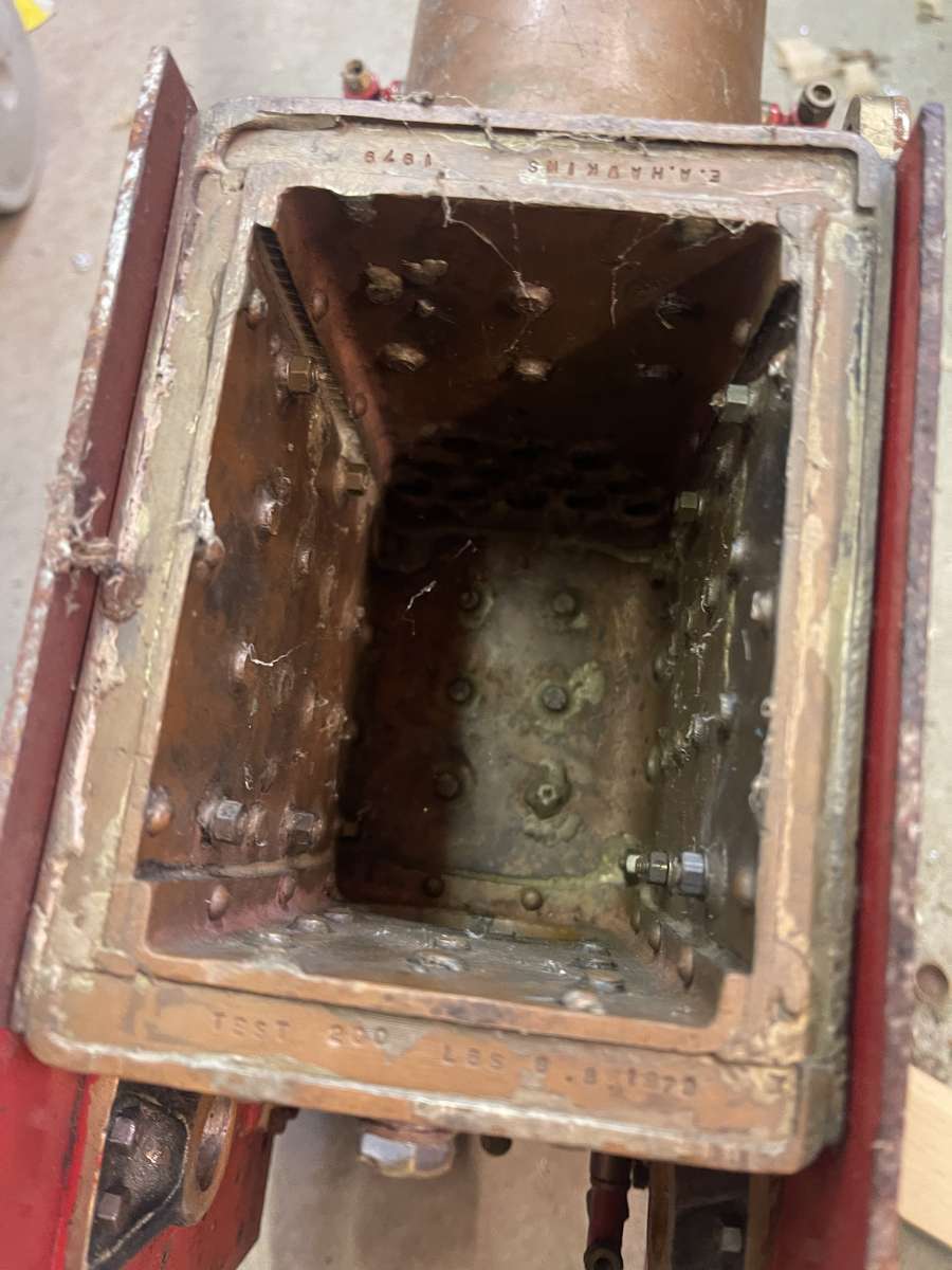

            So what is the w.p. for this engine? Careful comparison with known models of similar size should give a sensible likely pressure – probably around 90psi. (6 Bar, near enough, for the “Written Scheme of Examination” and Certificate formalities including its Bar*litre capacity).
            I see the foundation-ring is stamped with “Test 200psi,” but not the intended working pressure, and it was made long before the present scheme was created. We also see its maker’s name, and the date: good!
            So I would suggest take 200 as what is now called the Initial Shell Test (the 2wp) limit, so the WP should not exceed 100 psi, perhaps 90psi.
            I am reasonably optimistic for this boiler, from the photographs alone.
            The engine needs dismantling anyway to restore everything, so that will free the boiler for full examination: remove the fittings, make an test-set adaptor for one, and blanking plugs / plates for the rest, of the apertures; clean it and look for any other identifying details stamped on it. If you can identify who actually made the boiler, that may help too. Even better if you can find any documents from its construction.
            The next hurdle is by whom to have the boiler tested.
            If you were intending to steam it in your own back garden you should still test it to the present, recognised code for your own safety and peace of mind, but that won’t certify it for any public or club use.
            For that, you have two options: commercially or via an MELG-affiliated model-engineering club (essentially, affiliated to either NAME or “The Federation” that used to use the adjective “Southern”). You have not, I think, said if you belong to one.
            The commercial test will be expensive and anyway likely to need you present the design drawings, and if an unfamiliar type, its calculations.
            A club-scheme inspection – free but only to fully-paid-up, bona-fide club members for insurance reasons – may not need those documents but the inspector is free to decline to test a boiler of unknown provenance. At least being able to examine the boiler without its surrounding metalwork will make life a lot easier for both owner and tester.
            Never mind rusty transmission components, making the flywheel look more prototypical, or the rectitude of the smokebox door hinges….
            Carefully dismantle the entire engine and establish the integrity of the boiler first!
            Obtain a copy of the present MELG boiler-examination book, and study that to see what is necessary.
            I hope it passes all inspection, and you can complete the engine satisfactorily!

                  I suspect Nigel wa styping that while you posted the boiler photos.
                  It does not look too bad a boiler so worth getting a new test as there is no paperwork for when it looks to have been built back in 1978.
                  Soldering is neat but I wonder if the throat plate to boiler barrel is brazed rather than silver soldered in which case what was the filler rod used. The number of fire tubes and stays do not match the Alchin.

                            After a phone call with someone who was in the traction model world we have found out that the name on the foundation ring is that of a professional boiler maker of the time which was 1979
                            #825137
                            Roy Birch
                              @roybirch29994
                              Further to the identification of this engine, someone has identified this now as a Burrell 1.5 gauge engine to the Basset Lowke  design, they also had a set of castings for the wheels, the size is also about the same, if this is the case can anyone identify any drawings which I believe were in a 5 page book to build this model?

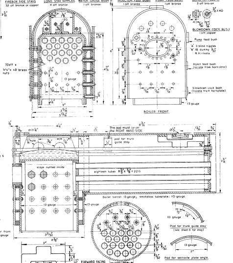

                                I do have drawings for a 1.5″ Bassett Lowke but far more detailed than your engine as well as being a 3 shaft.
                                I thought the booklet “how to build a traction engine” covered the 3/4″ scale one. Which as I mentioned earlier is a 4 shaft but not the same shaft layout as yours as the 2nd & 3rd shafts are at the same horizontal height

                                  I too have a full set of the drawings for the 1.5″ bassett lowke Burrell. Many large sheets not a small 5 page booklet which I think is for the 3/4″ model.
                                  I also have the model which looks not much like the pictures. In fact I doubt it is as stated. We’re not that far apart Roy, your welcome to inspect my model and the drawings if that would help. I’m 4 miles from Hunstanton.   Noel.

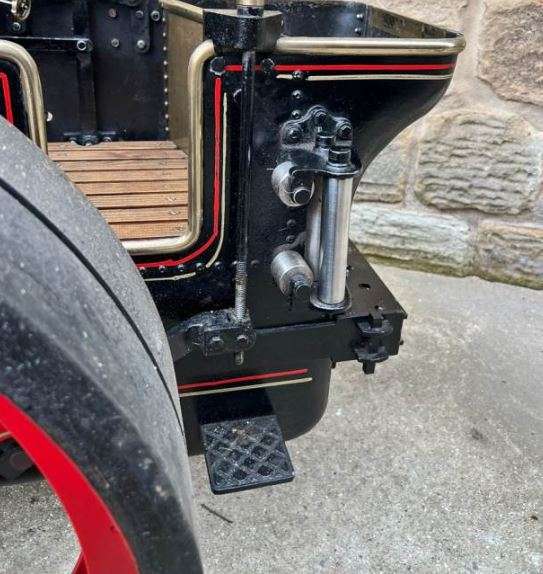

                                                    @roybirch29994
                                                    IMG_1733IMG_1732
                                                    The Boiler
                                                    Looking at the club archives it appears that this boiler was made by a club member who was well known to be a good engineer, he was also friends with the person named on the name plate on the cylinder, I further discovered that the members who are going to test the boiler were also friends with the builder and one of them is a traction engine man, the plugs are now in and I am waiting for some gasket material so that I can use the lower part of the cylinder block to seal the boiler for testing.  I have also acquired the plans for the original Burrell 3/4 scale traction engine along with the out of print book book by Bassett – Lowke called “How to build a Traction Engine” One of the members testing my boiler did comment that there were a few variations at the club that were freelance engines based on the Bassett Lowke small traction engine. Anyway I will keep you posted on the progress if anyone is interested?

                                                      Having seen this model, it is not an 1.5″ 7hp Burrell ! More likely a 2″ scale. It’s not a repurposed loco boiler, it has an internal reinforcing pad for the cylinder and motion bracket. It is of 4 shaft design, there is no sign of the diff or winding drum. The cast wheels are of massive proportions, looking like nothing I have ever seen and I find it hard to believe that any foundry would make them except for a hideous garden ornament. The flywheel is more in keeping with a stationary engine, to small in diameter and to chunky, not the open design of an agricultural engine or the disc of a road loco. It appears there may be another flywheel in a box. The cylinder block has a separate mounting saddle and the exhaust comes out under the valve chest.
