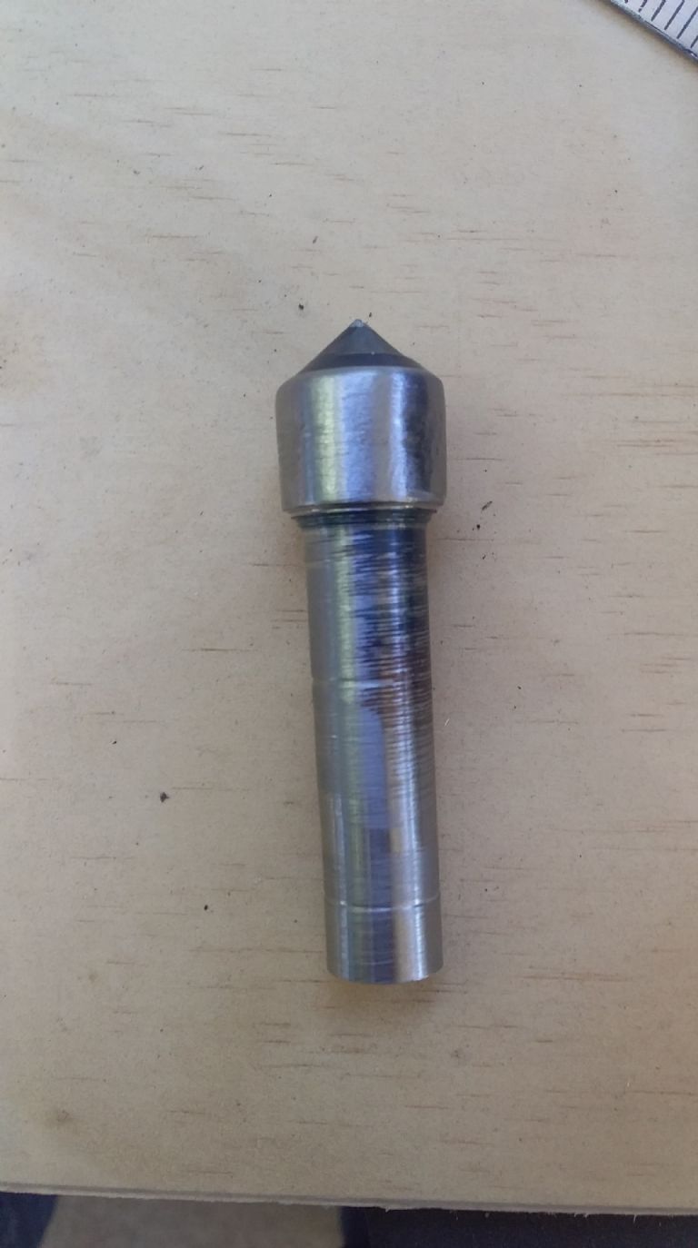

      Im a complete beginner from Australia who out of shear luck and fortune managed to find a Optimum TU-1503v Bench Lathe on a rubbish pile at a Skip Bin yard behind my place of work. So long story short needed a new square nut for the tool holder and still need to get/make a dead center for it as well.
      Had a try at making a dead center for the machine today, didn't do too badly, although a little thinner (1mm) than needing to be, but will try again with some better steel instead of turning a Galv bolt to size. I learnt a valuable thing and that is that I will need to purchase some better tools as the cheap 11x piece set I have is not the best to work with. But hard to find 8mmx8mm shaft tools in Australia though.
      I have always wanted a lathe as I do leather work, and want to make my own tools etc. And maybe once I have a little more skill make a mini steam engine or parts / extras for my little one I already have.
      I have no other tools equipment and not a lot of money to buy them either, so my question is…. what would be the bare minimum workshop tools to look at getting. I already have a bench vice and drill press on the list of things to get.

          If you want dead centres, try to find some old Mores Taperr drills, that bhave been discarded because of being, redundant, too short or wrong size.
          The important thing is that the Mores Taper is not damaged. (This is your location! )
          You hacksaw off the flutes.
          Then mount in the Mandrel.
          Set the Topslide over to 30 degrees.
          With a sharp tool, set to centre height, start taking small cuts. As you take more cuts the taper will begine to take shape.
          How do you know when the tool is set on centre height? If, when you face across the end of a bar in the chuck, there is a "pip" in the middle the tool is NOT on centre height, nor will it cut properly.
          When you have finally produced a sharp point; you have your first dead centre.
          Repeat and you have one for the Headstock and the Tailstock

                        #549239
                        Damien Fisher 1
                          @damienfisher1
                          My first attempt at at Dead Center. Didn't get a MT on it, but was more trying for the basic shape, and getting used to the tools first. As you can see… it's not that great, but has a shape to it atleast193746407_789515915057260_4907904497763870571_n.jpg
                          #549240
                          Damien Fisher 1
                            @damienfisher1
                            The groove at the bottom of the shank is where the headstock hit the jaw, and twisted the tool a bit out of the holder causing it to dig in. (Whoops) learnt not to do that again, and to set up the limits on the head stock a bit better
                            Edited By Damien Fisher 1 on 10/06/2021 23:48:58
                            #549241
                            Ady1
                              @ady1
                              Don't make the belt tight to start with, it will slip when you make a big mistake or have a dig in and this teaches you to keep your tools sharp and your feed steady
                              Once you get better at it you can go for more power, you will know when you are ready to up your game and maximise the potential of your machine

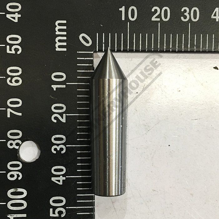

                                Damien Fisher 1
                                  @damienfisher1
                                  Posted by Chris Crew on 11/06/2021 00:10:30:
                                  I have no idea as to the availability and price of tools etc. in Oz but if they are just about similar to those in the UK, and I understand Oz and China trade extensively with each other, then I would have thought for the price of about a fiver it is hardly worth the bother of trying to make a 1MT dead centre which needs to be hardened in any event. Only the head-stock centre can be left soft. There are a lot of sino-phobes in the UK but I have never had any issue with what you get for your money and the quality of Chinese tooling has improved greatly over the last twenty years. In fact it seems to me that it is only the brand that differs. I strongly suspect that these days even the so-called quality marques are only constituted of Chinese components and re-badged accordingly, although I have no way of being certain.
                                  It's quite expensive for tools here in Oz. Its getting harder to get anything from China here with all the Covid Politics happening currently between Australia and China, Even the price of Chinese stuff has risen because of it in my opinion. Would a standard MT1 dead Center fit in though? this machine having a shortened tailstock?
                                  This is the only picture I could find of the original dead center that comes with the machine:

                                      Andy Carlson
                                        @andycarlson18141
                                        Posted by Damien Fisher 1 on 11/06/2021 00:18:05:
                                        I dont know that machine but if they have shortened the thick end then a standard one will stick out too far.
                                        If they have shortened the thin end then the chances are that the bore wont have enough room for it to fit in.
                                        From your pic the I cant quite work out if the thick end is the standard size (should be a little over 12mm) but it is close so likely the thin end is shorter.
                                        It might be possible to cut the thin end off a centre but if it is hardened (which it probably is) then you will need to use a thin grinding wheel (with appropriate precautions).
                                        Do you have a tailstock chuck that fits the lathe?
