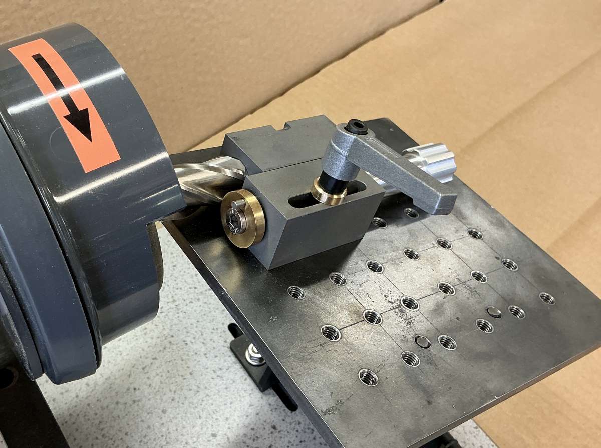

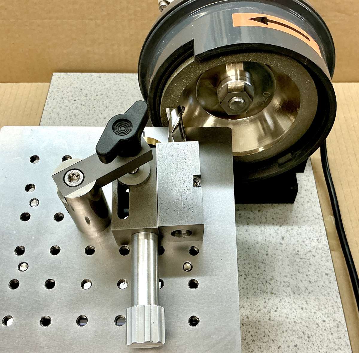

      Being able to sharpen the tip of end mills and slot drills is very handy in the larger sizes. I was gifted a number of 16mm mills and also a 20mm on a 16mm shank many years ago. All pretty unusable for one reason or another. Having just completed the Harold Hall End Mill Jig, I was pleasantly surprised to achieve more than acceptable results on my first attempt. At least cutting aluminium alloy. More experimentation to follow. I’ve also discovered I need to make some additional parts for my setup. Materials inbound later this week hopefully.
      Like several others I’ve seen on YouTube, mine is not an exact copy as that documented in Harold’s excellent plans. I’ve incorporated the modifications others have suggested plus a couple of my own.
      IMG_5208

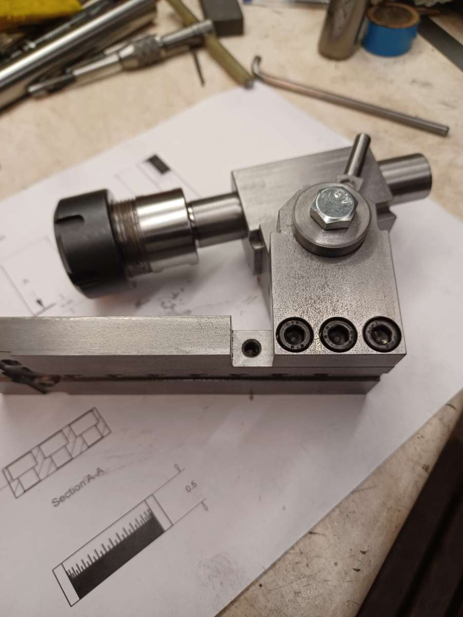

            There was an article in the Model Engineer in June 2004 Vol 192 No4223 by Colin Pape.It was called The Cannon A Sharpener for Milling Cutters ,I made this device and it works beautifuly but it was designed for threaded cutters only and if I ever get the time I will make a barrel to take a collet holder which would be an advantage too.The date is for the second article ,I don,t have the first one now.

                Bricky, it would be nice to see a picture of your jig as I don’t have that issue.

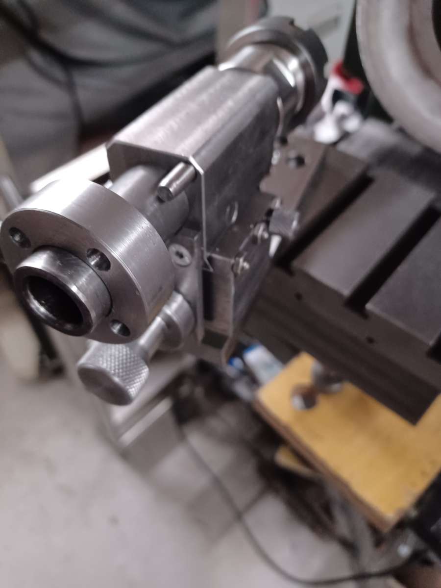

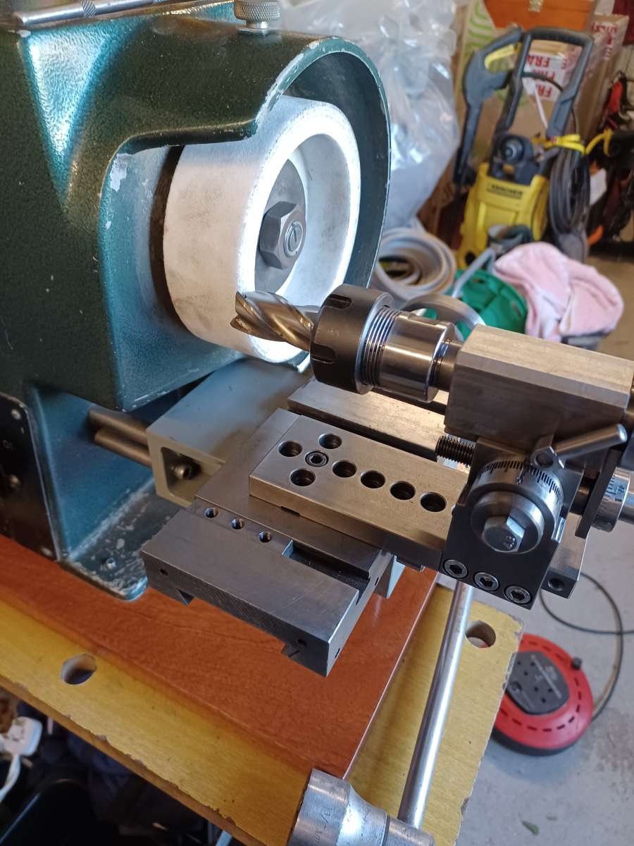

                  This is my effort to sharpen cutter and drills.
                  20250211_070910
                  20250129_153610
                  I have made a jig which holds a collet set and I have fitted a collar with a grub screw which with a dowel with equaly spaced holes so I can set first tooth to correct position and length firstly then release the side clamp rotate to next hole and reclamp whilst holding up to face then regrind next tooth.
                  20250708_153143
                  David

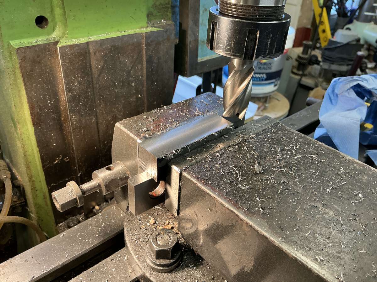

                        I sharpened a 20mm end mill the other day and had the opportunity to use it on some mild steel today. I’m very happy with the result.
                        IMG_5278

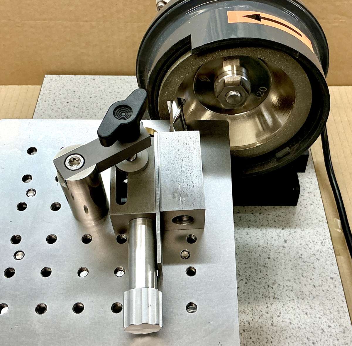

                                  I sharpened a couple of slot drills the other day. As the cutting edges differ in length a slightly different approach is needed. On a couple of 12mm SD’s the difference was about 2mm so I used a piece of 2mm gauge plate to space the holder against the stop block during grinding. I’ve not actually tried a plunge cut yet but the cutters look ok. This is the setup.
                                  Long edge first.
                                  IMG_5286
                                  Then adding the spacer for the shorter one.
                                  IMG_5288

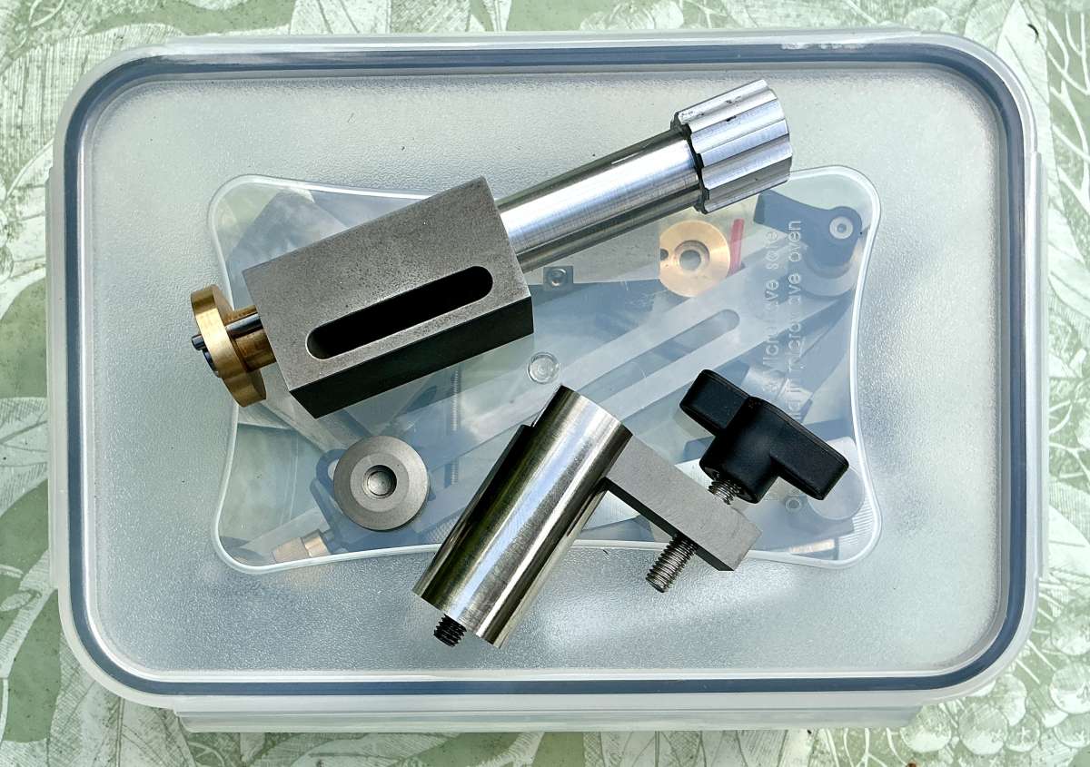

                                    Vic, I have been warming to your ideas on the screwed plate and the slot in the guide from your earlier photo. Why did you need this alternative clamp?
                                    Are the holes 1 in spaced or 2cm or???
                                    #814641
                                    Vic
                                      @vic
                                      Hi Bazle, I went for a 20mm grid of M6 holes in the end. The slotted stop block is not my idea. Harold Hall originally made this with four holes. Having seen the modification of a slot on a couple of YouTube videos I decided it was a better option. I saw this alternative clamp somewhere on another video and decided it may be a useful addition to the table. If not for this particular jig then perhaps for another setup. It’s surprisingly solid for a two part component. Obviously if I’d made this first then I wouldn’t have needed to slot the stop block.
                                      IMG_5305

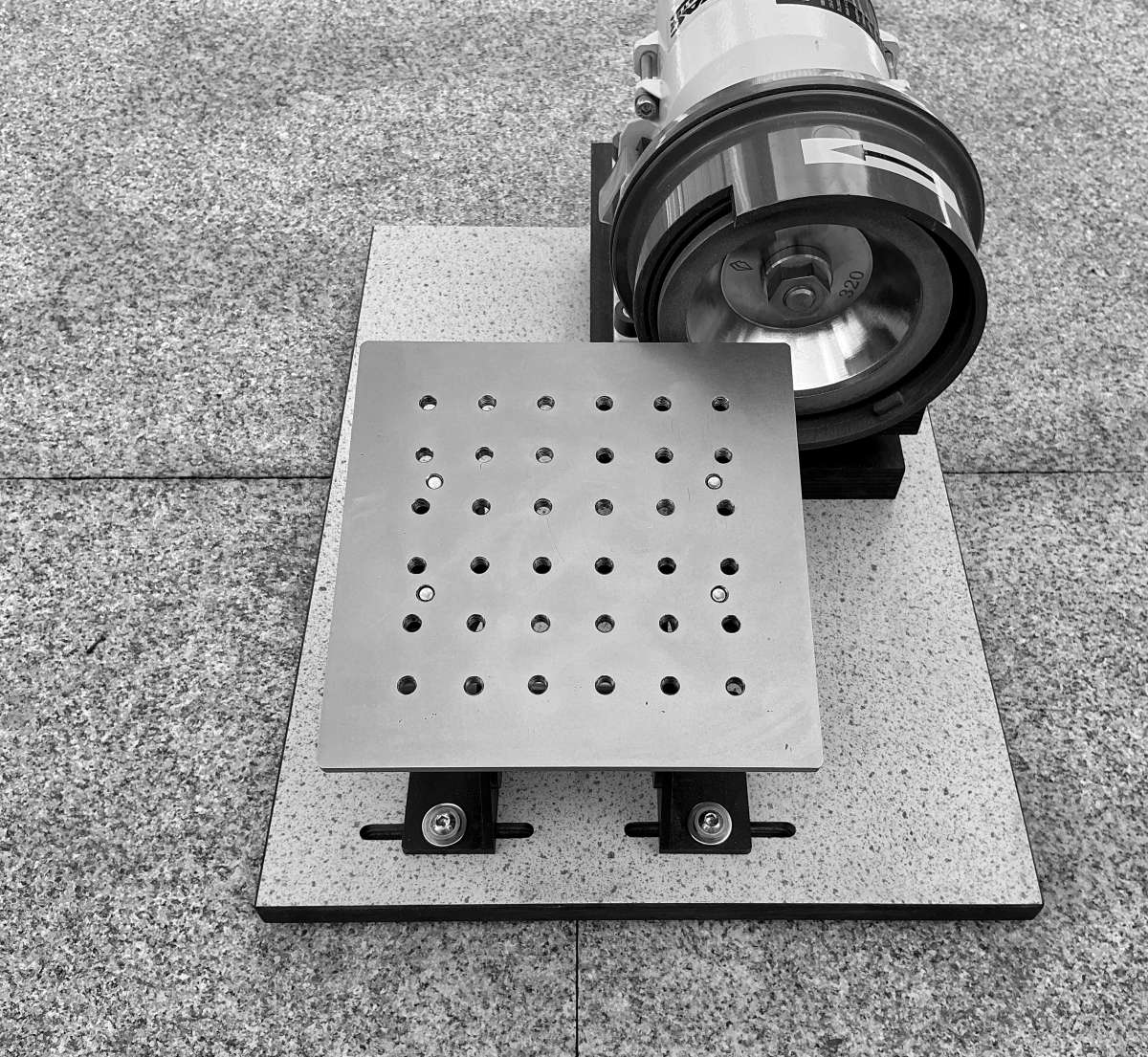

                                              As you may be aware, the table and its mounting brackets are based on the Accute sharpening system. I thought it may benefit from slightly thicker materials though so instead I made the brackets 5mm thick and the table 6mm thick. I also allowed for lateral movement of the table seen in this picture. This could be further refined at a later date if the need arises.
                                              Edit: Not seen are two straps with M6 threaded holes for the mounting screws under the base. The screws can therefore easily be loosened and retightened from above with a ball end hex driver.
                                              IMG_5299
                                              Check out this link again for some really inspirational ideas on grinding platforms and jigs.
                                              https://gadgetbuilder.com/DrillSharp.html
                                              My trials and tribulations with the table build are here:
                                              https://www.model-engineer.co.uk/forums/topic/grinding-rest-3/
