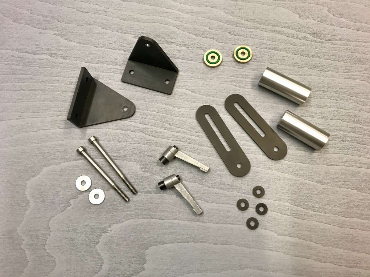

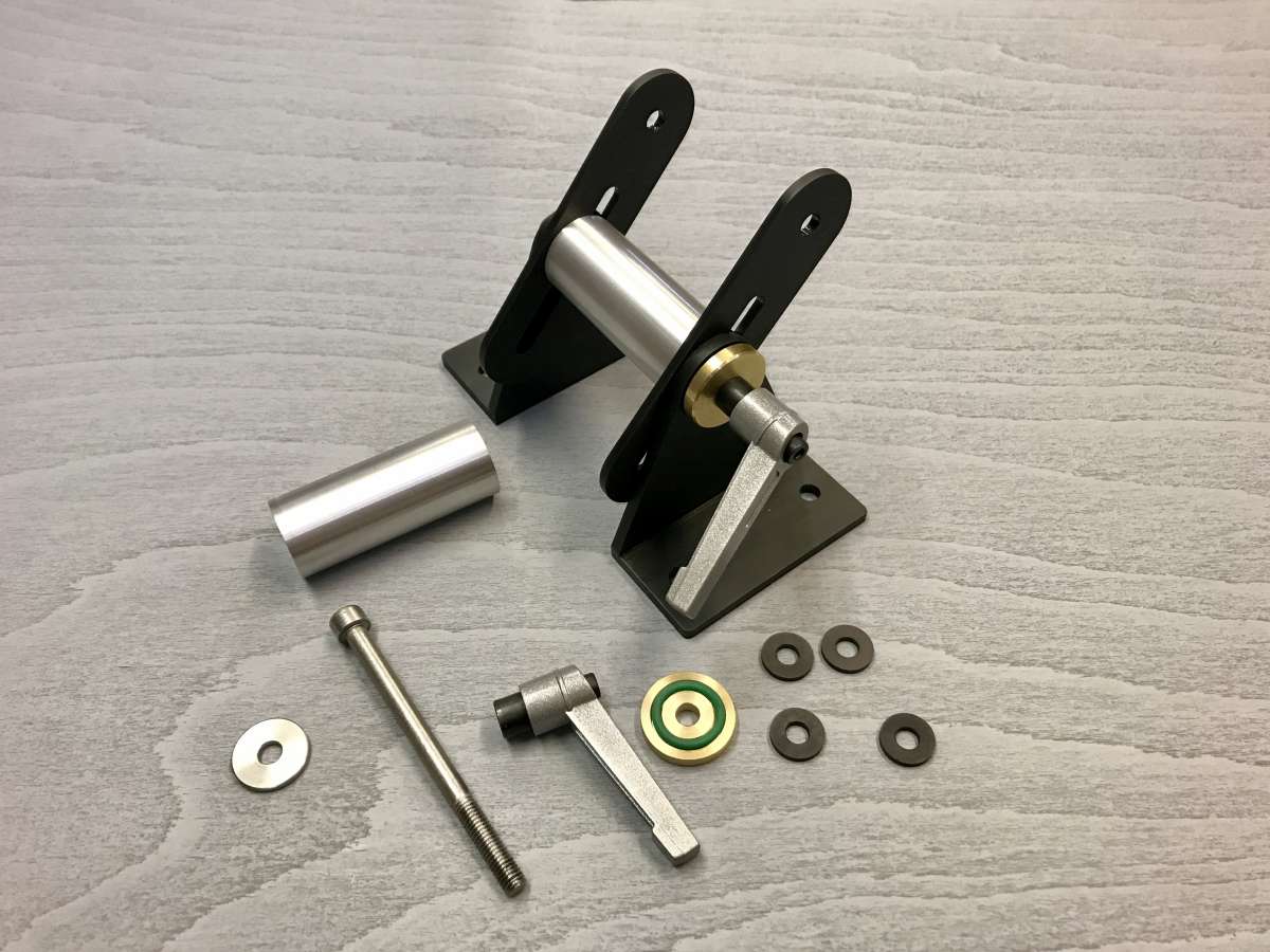

      My current project was progressing quite nicely but unfortunately an eBay supplier hasn’t shipped the material I need for the top brackets. Once I get a refund I’ll try another supplier.
      IMG_9226IMG_9228

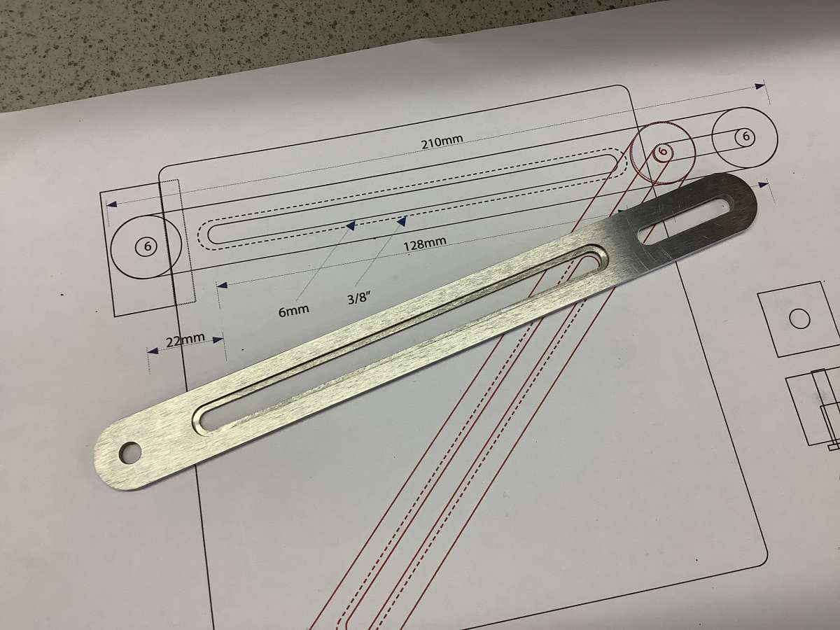

                  Some context. I decided quite a number of years ago that I could do with a decent grinding rest. Some of those I looked at were rather small so I looked at ones like the Harold Hall rests. The advanced model looked to be more of an investment in time and materials than I wanted to spend. More recently I looked at the HH rests again together with the Acute and a few others online and on YouTube. I decided that the basic table of the Acute might be a good starting point and it had a nice size – 150mm x 150mm table.
                  I looked at some YouTube videos of the table together with some online build logs. I decided that an exact copy was not required but the basic substrate looked quite good. I was on a tight budget so working with raw materials seemed the logical option. I was going to just buy the plans but discovered the majority of the information required to start a build was freely available from build logs etc and the other dimensions were easy enough to work out.
                  I decide to use steel angle for some of the parts but this proved to be quite time consuming and the finish after machining to true it up left something to be desired. Aesthetics aside though the parts are ok mechanically. I chose to make them somewhat bigger than those in the plans with a 25% increase in thickness and a 10mm increase in the length for the feet. I also decided to increase the thickness of the table to 6mm. This gives a deeper thread for the mounting screws. If I were to do this again I might just buy some angle brackets as I’ve seen some on eBay that could, with some adjustments to the plan, be suitable. Failing that, solid stock would suffice.
                  I decided that having the plans may be useful for future reference but having bought a set I had to cancel the order as the vendor was away and unable to supply them for several weeks. If anyone else is planning a similar build then the plans look good and aren’t expensive but not absolutely necessary unless perhaps you want to build an exact copy. I’ve already made a tool holder that I’d like to use if I can so I’ll have to do some redesign anyway to use it.
                  looking online some of the reviews about the test aren’t too positive but there are always variables with a self build that can obviously affect accuracy and useability. There are also some small criticisms of the kit components and substitute materials have been used to make machining easier. I’m not overly impressed with the decision to use cap bolts as pivots as locking the assembly could be an issue. The instructions (ignored by some YouTuber’s) to drill two holes slightly under size is not a particularly good solution in my view. If, in spite of my following the instructions, the unit doesn’t lock easily and positively I may use 6mm threaded rod and a knob as well as a locking lever.
                  I need to source some more materials and produce some simple drawings before I can continue the build. It can though already be used as a simple adjustable rest which I didn’t have before.

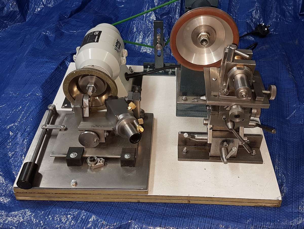

                      The HH simple rest looked a bit flimsy. The advanced looked over complicated. Both of them have rather small tables. As you say, much depends on what you want to sharpen. Ease of use will no doubt play a part in determining that for me.
                      One of the features I noticed about the HH rests is the guide slots in the table. A nice idea but perhaps not as flexible as the guide fence on the Acute rest.
                      I quite liked the rest in this video but some of the elements were even more complex than the HH advanced. Check out the other videos in the series if it’s of interest.

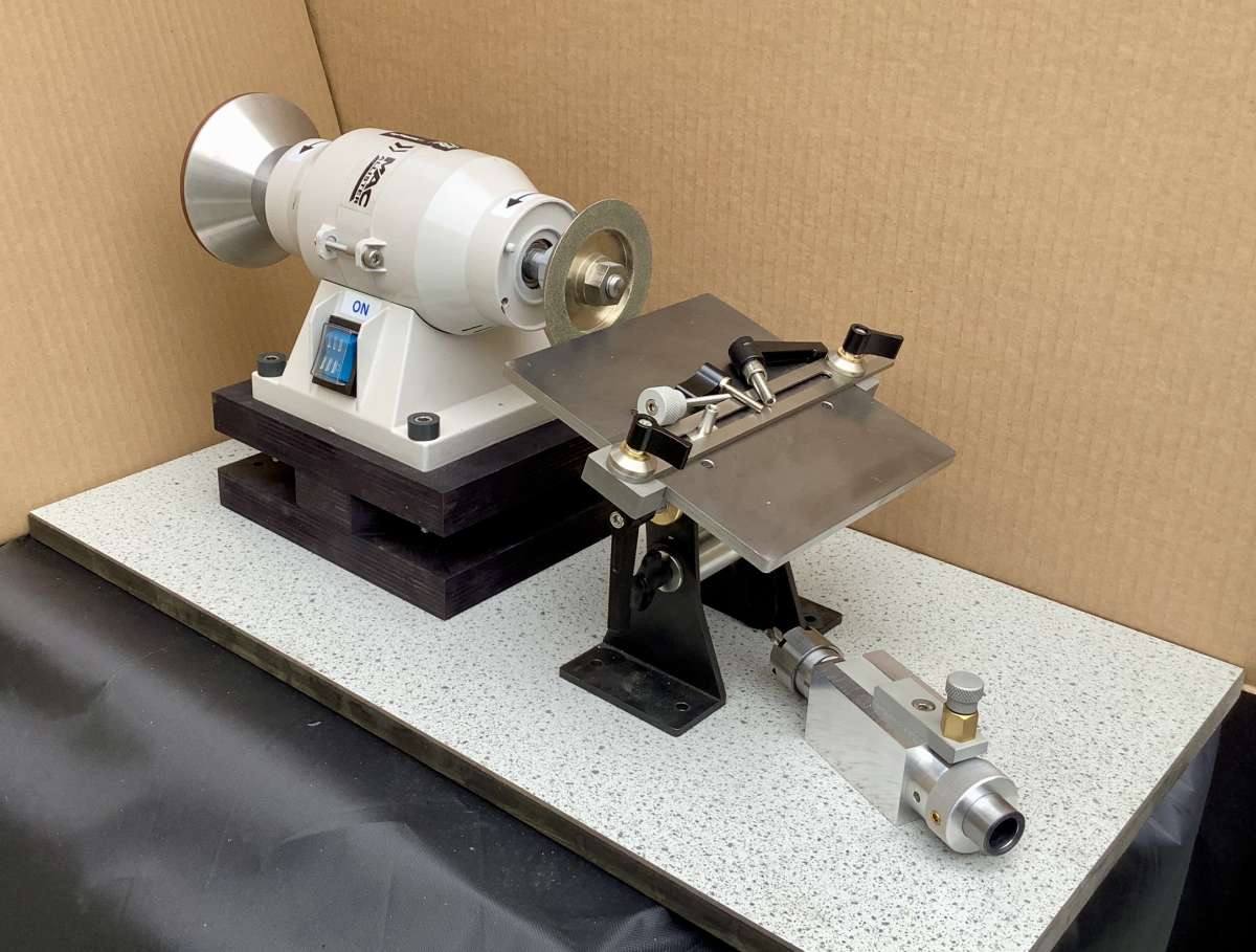

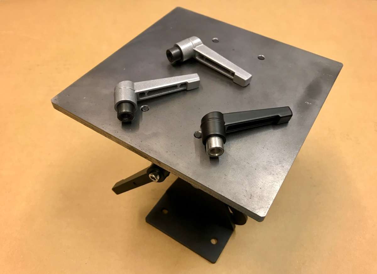

                        A couple more bits arrived today.  The table needs some small locking levers. I ordered a two pack of the silver ones on Amazon but also placed an order for three of the black ones from Aliexpress. These have stainless M6 fittings. They are all female and I need one male so I’ll Loctite a socket set screw into one of them.
                        IMG_9234

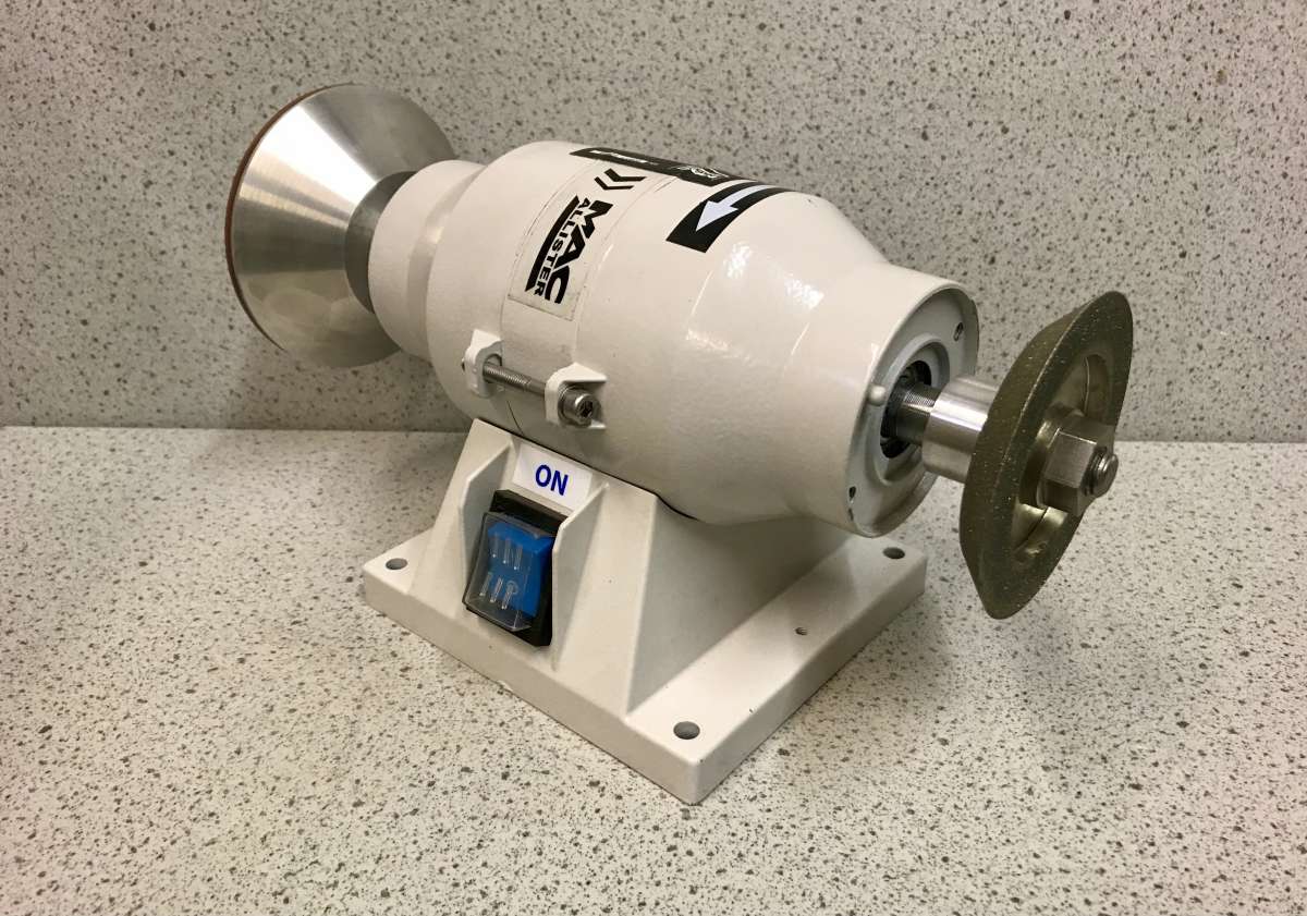

                        This is the grinder I’m hoping to use. They cost between £22 and £25 in most places. The type has featured in a number of online builds so I expect it should be fine. It’s currently fitted with a 100mm resin Diamond cup wheel on one end and a 75mm electroplated Diamond disc on the other.  I’m hoping to get a CBN wheel at some point.
                        IMG_9235

                          i used one of those grinders on my H H tool rest build. check the cycle time is suited for your use they get hot very quick. an old one that came from the same shop 40 years will run for hours and only ever gets slightly warm [ i got distracted and left it running]
                          #739962
                          Vic
                            @vic
                            These grinders are tiny. About half the weight of a similar looking one I’ve had for over 30 years. The new one is only going to be used for light work and it’s diminutive size and weight will be a definite advantage.
                            When I need to remove large amounts of material I use 60g on my belt grinder.
                            Edit: Not my setup, just something I saw online using the same grinder. I’ve seen several others.

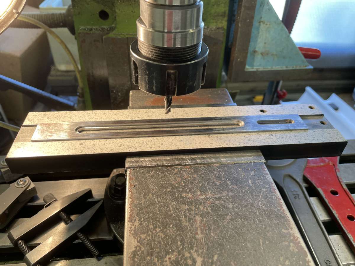

                              I was very lucky today. I drew up the fence with the changes I wanted and had time to make a start today. The only suitable sacrificial material I had to hand was a small piece of compressed paper/resin bench top. I was going to clamp both parts to the mill table but decided instead to clamp it in the vice. It then occurred that rather than clocking the part I could just cut a shallow rebate for it instead.
                              To reduce the amount of machining I chose to use some 20mm x 3mm ground flat stock. As I got close to the size of rebate required for it, it was clear something wasn’t quite right. Measuring the GFS showed that it was over size at 20.15mm. I wouldn’t have noticed this if I’d just clocked it and the resultant slots in it would have been off.
                              This was the setup after removing the clamps, and the finished part.

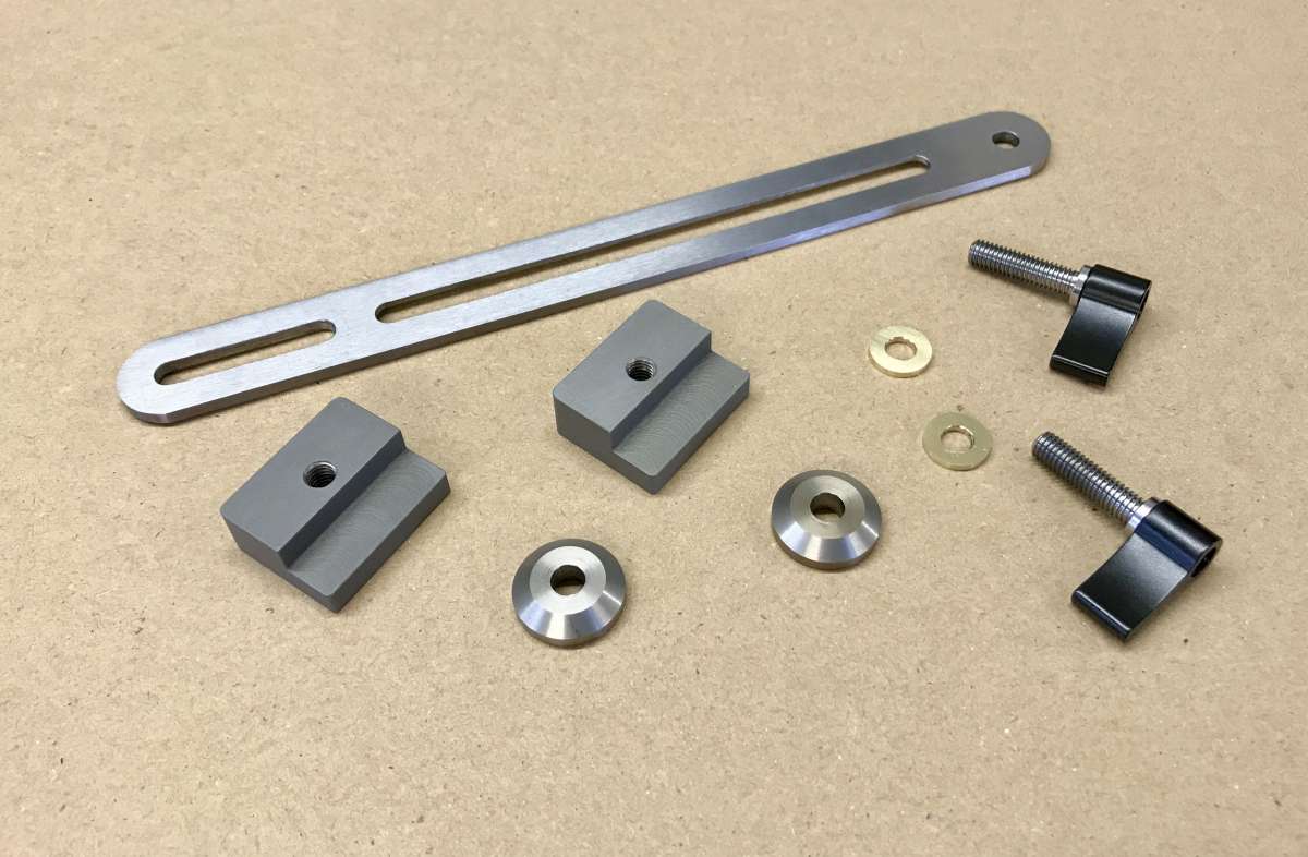

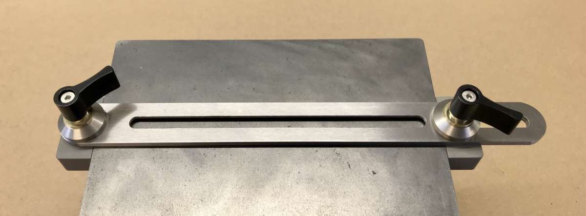

                                Next job is a couple of clamping elements for the fence. The plans call for two completely different clamping elements. One of them is round and the other might best be described as an orange segment shape?! 😆  I’ve no idea why this is the case. I suppose if you’re supplying a laser cut kit of parts you can have any shape you like? Not so practical though if you’re working from plans. There may actually be a good reason but I’ve decided to take the risk and make something a little easier. First impressions are though that they seem to clamp very well. Once again size was fairly arbitrary, dependent on available stock. I’ve also elected to use different size fasteners than those listed. I got into the habit years ago of trying to limit the number of different threads on projects if possible. It had practical reasons at the time. This project calls for M3, M4, M5 and M6 threads. I’m expecting to use just M4 and M6 as I don’t see any advantage in using the others. I’m particularly impressed with the little M6 “Flag” style aluminium locking levers I ordered from Aliexpress. I’ll also be using an M4 version for the fence block.
                                IMG_9303
                                IMG_9304
                                #741604
                                Vic
                                  @vic

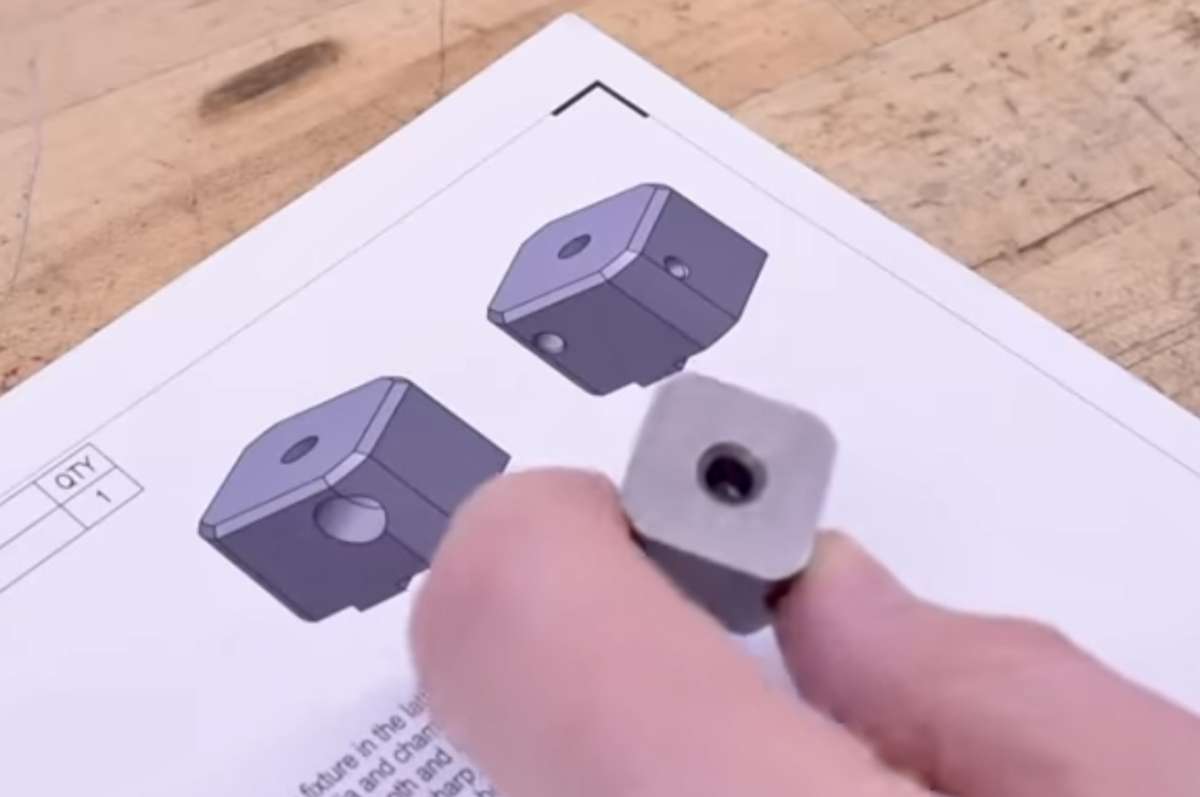

                                  Once again I’ve changed the size (and material) of the next component on my list, the T nut for the fence. This part should have a 5mm spigot with a 4mm thread in it. I decided the wall thickness was a bit on the thin side so I cut a 6mm slot in the fence so I could increase the spigot accordingly. Material will probably be Brass so it slides nicely in the fence rebate. I’m undecided on the stop block that sits above the T nut. Size can be anything I like (as usual on this project 😆 ) but I’m unsure of whether to make it in mild steel or aluminium alloy?

                                        Don’t the plastic wing nuts negate the adjustability of the Bristol handles? My standard build works fine. I agree the under size hole sounds a bit agricultural, though.

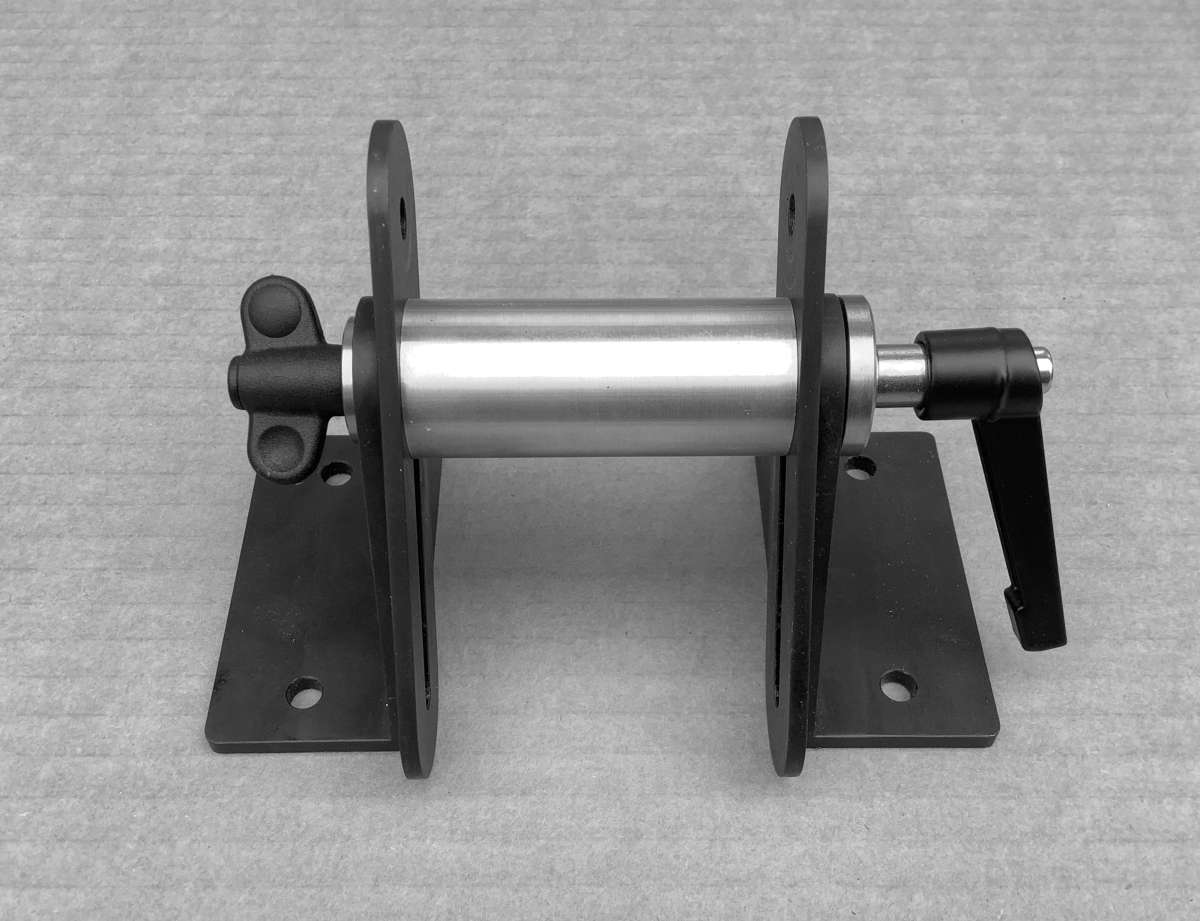

                                          I’m not sure what you mean but once the locking lever is tight you can adjust it to any position required. As mentioned, if it does become an issue I can go back to the bolts and maybe use stud lock or something?
                                          I have seen other solutions that I’m not so keen on:

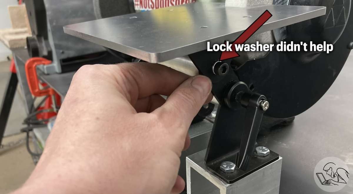

                                          Vic
                                            @vic

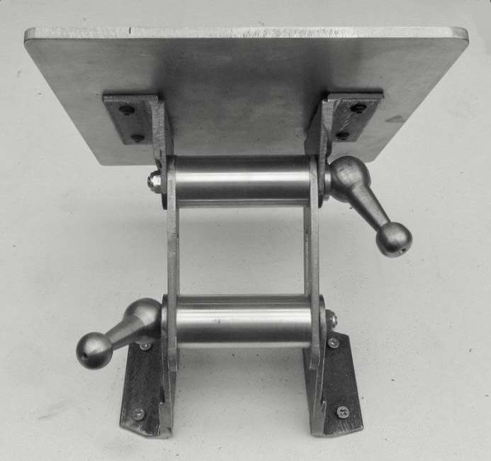

                                            On the latest Blondihacks build she says the bolts do tend to loosen and she’ll probably replace them with hex bolts and *weld a stop. In fairness I’m not sure if she took notice of the instructions saying to drill the brackets slightly undersize for the bolts? I did, but then decided to use slightly longer bolts, and you guessed it, they were fractionally smaller.
                                            * I don’t have a welder so I’d have to do something else if my little wing knobs don’t work.

                                            #744000
                                            ega
                                              @ega
                                              I suspect that if mine began to slip I would resort to keeping a hex key handy.
                                              #744144
                                              Howard Lewis
                                                @howardlewis46836
                                                Glad that you are increasing sizes if the material is available. That can only improve rigidity, which is what you want to grind accurately.
                                                Looks good!
                                                But can’t see the point of having Bristol levers in conjunction with a wing nut.
                                                The picture with ball ended levers shows why Bristol levers are so useful, to avoid fouls.
                                                A M6 thread can apply a large clamping force, so unlikely that anything would move much under the loads imposed by grinding.
                                                Howard

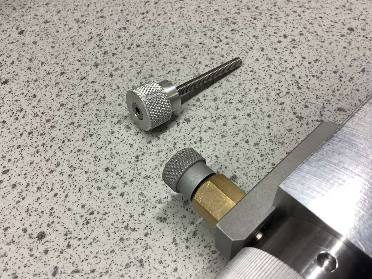

                                                  The problem seems to be that the bolt is not captive. I’m a way away from using mine yet but Quinn in her video mentioned it loosened in use.
                                                  Too hot in the shop but I did a little job, a knob for an adjuster. Once again I chose to use a larger size. M4 instead of M3. M3 is handy in that one revolution = .5mm but the knob isn’t graduated so I went with M4.
                                                  Now, should I sand blast it the same as the other, smaller knob in the picture?

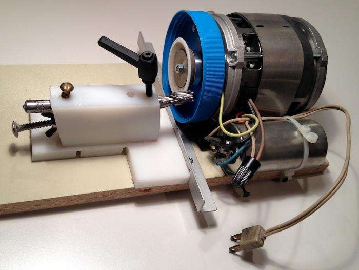

                                                      Of the few builders that did fit a guard on the website I mentioned, I found this solution quite inventive! I must remember to take a tape measure with me the next time I go to Sainsbury’s! 😂
                                                      If you’re of a sensitive disposition please don’t view the following picture! I don’t want anyone going apoplectic again. 😆 Yes I know there are exposed terminals and the motor has openings. It’s not my grinder and I’m not suggesting anyone else do this. I’m hoping the owner resolved these issues before using it. 😉
